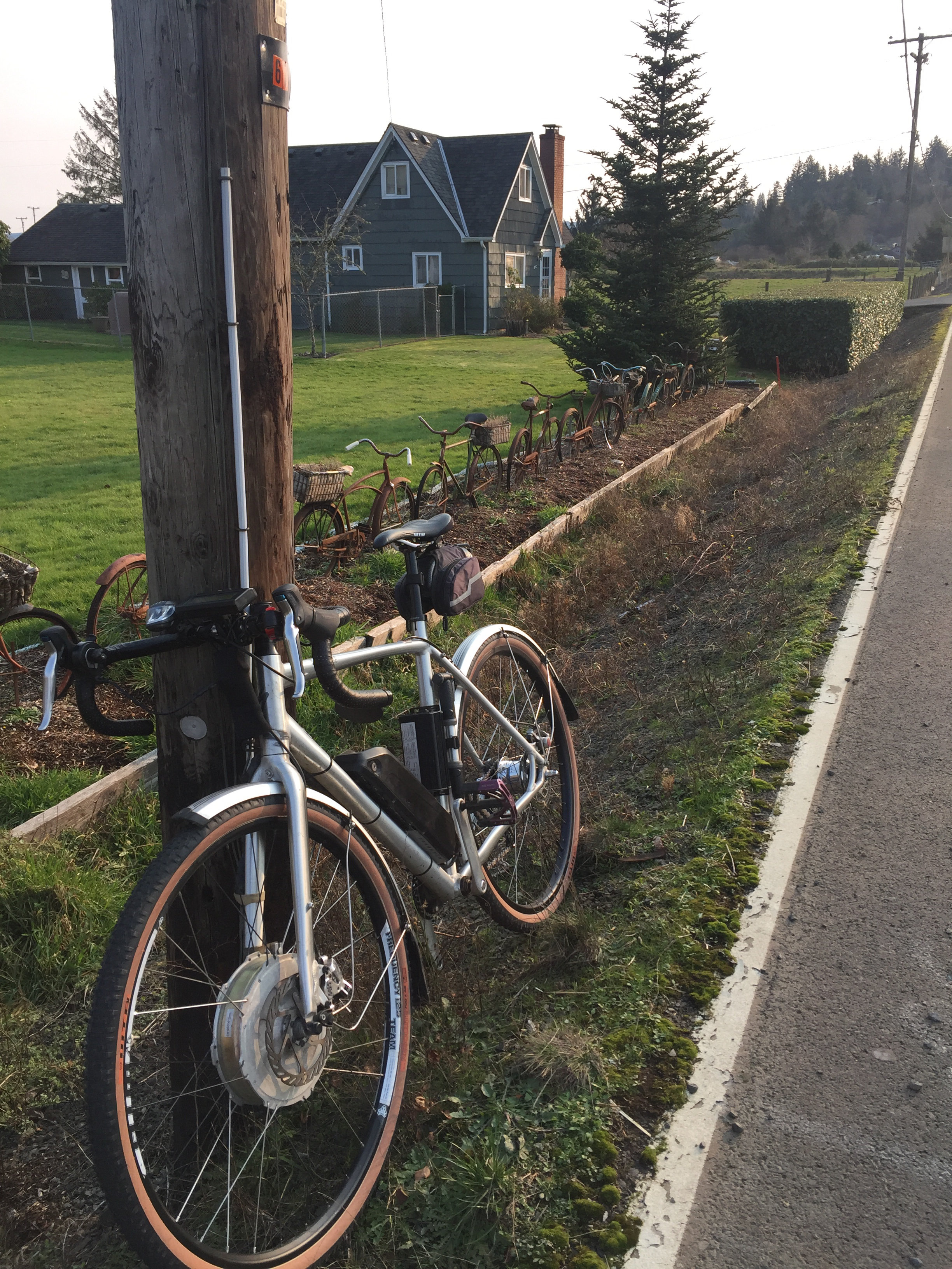

My Grin AllAxle front hub motor is set up to easily and securely remove and replace the hub motor without any tools. 1250w peak, aluminum fork never any signs of distress in 2000 not all that easy miles.
My other road bike is basically the same setup and has a bolt on axle that sits in carbon fiber dropouts at the end of a carbon fiber fork. Another 2000 miles of stress free riding from sea level to 11,000'. It takes a wrench and a hex wrench to remove however.
Both forks are inspected regularly as part of the routine maintenance. As one of the few people on here that actually uses a front hub motor I have to give it high marks for primarily road use. Failures can occur with any system due to improper installation and use, or abuse as the case may be.

The only QR Front Hub is the Grin one. It is adaptable to 9mm standard QR, 15 and 20 TA and is the lightest Direct Drive hub on the planet of its watt class. It also includes a built in torque arm that makes a very positive connection and in all my miles on the bike it has held the 9mm QR in place.
You are right about the 1mm axle size difference that all the other nutted axle hubs have which people mainly pull out the file for as you suggest. Taking 1/2mm off each side of the dropout is not that big a deal if it is done correctly. But there were incorrect procedures done that did result in failures that have obviously tainted the front hub system forever it seems. That said my V1 bike has a 9c motor with a nutted axle that I had the dropouts widened on. Oh, and they are carbon fiber. Using the proper washers and locking it all down with a torque arm has worked on that bike for a couple thousand miles also with no ill effect.
