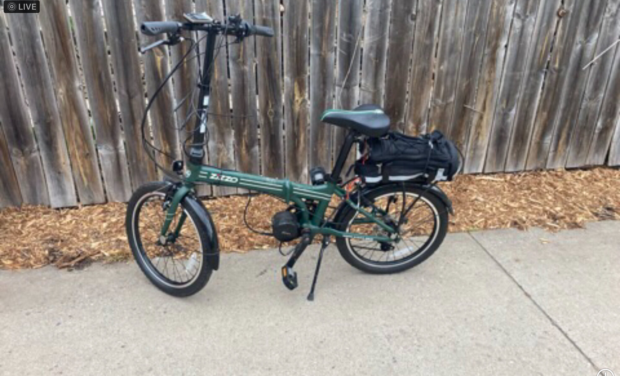

I did a ZIZZO with a BBS01 and another with a BBS02. But it’s not a fatty. The entire BBSxx series sits really high in that frame. I despised the geom of every 29” bike I tried. I found them all squirrely. But they are ridiculously popular. Fad bikes from where I sit. But that’s just me, the curmudgeon…
I wasn’t familiar with that bike. Looks like the motor would rotate way up out of the way. Just need to find a fatty with a similar design.
