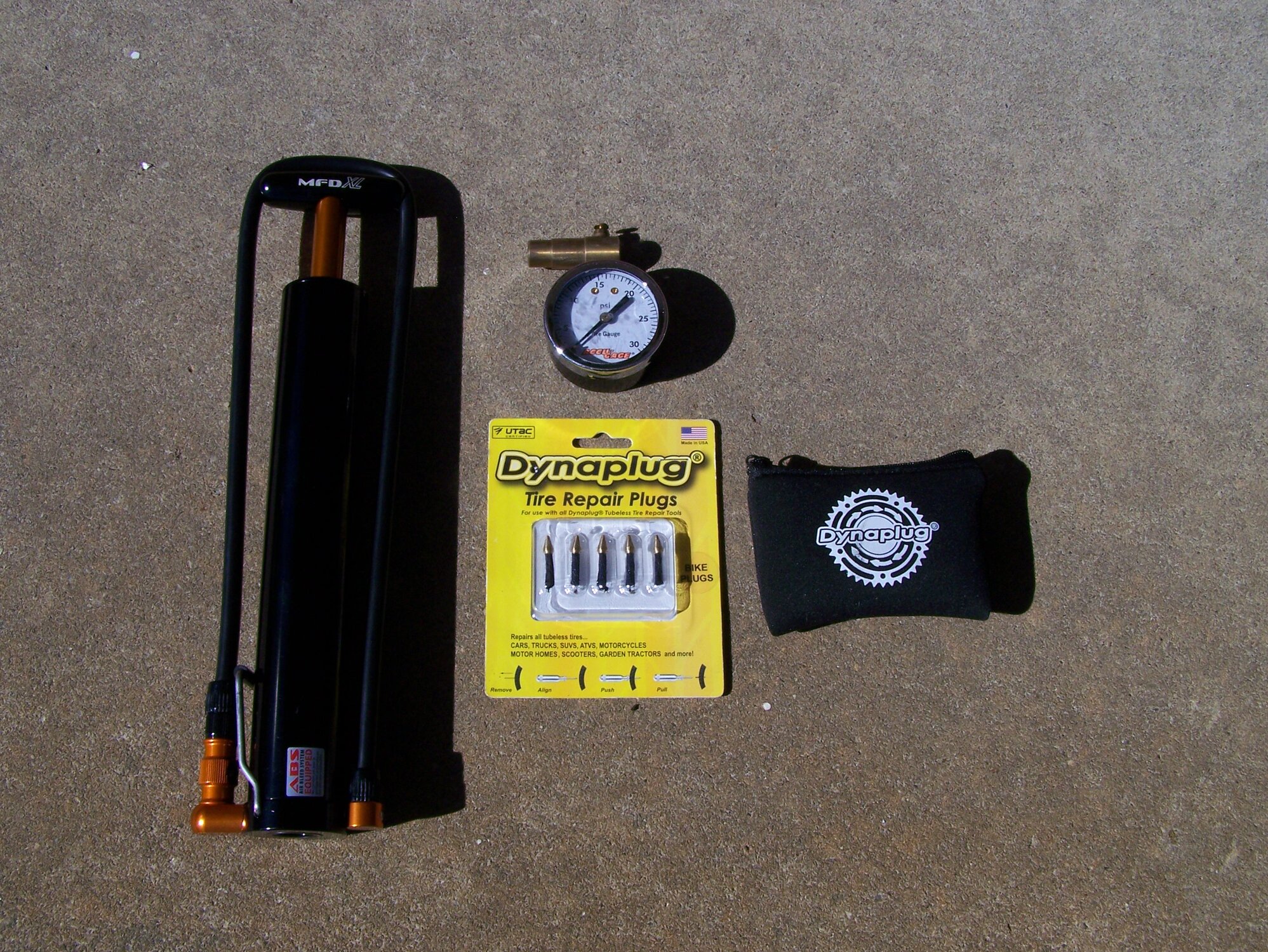

Tubeless is a considerable investment of time and money. Time in having to tape the rims, a process in itself. Don't forget to get a couple of new rim strips, too. The Dyna Plug system is a must-have. So too are extra plugs. I think it's Blackburn who have come up with a plug for very big holes that the Dyna Plug can't fill. Sure wish I had those Blackburn plugs when I suffered a rear tire gash some 13 miles from home. Sealant blown everywhere on the bike. Even today, under the rear rack, there are still solidified pieces of Orange Seal. What to do? Being a fat tire and figuring more is always better than less, I used 8 oz of sealant in my tubeless set up. So, to disassemble that mess on the side of the road to try to fit my spare tube was going to be a slippery, gooey mess. Instead, I filled that gash with about every spare dyna plug I had, and miracle of miracles & riding very gingerly and slowly, I got home. Cleaned everything up, invested in the Tannus inserts and left tubeless behind.

Agreed with all that there is no one solution. I certainly don't use just one. I've even still got a bike using Tuffy. I am all done paying the ransom for Tannus Armour though. Have had three failures of installation. With that stuff your install experience depending on the tire tightness on the rim can vary from a doddle to a nightmare to impossible. Considering the manufacturer now acknowledges that Tannus will flatten out over time, and they recommend to stave this off to flatten your tires... I'm done with them.
I had figured that even thinned out Tannus was better than nothing and I was fine with that. It was the failed installations I got tired of. I think I use it successfully in a half dozen bikes but when it doesn't fit you are sitting on a $50 per tire life preserver.
