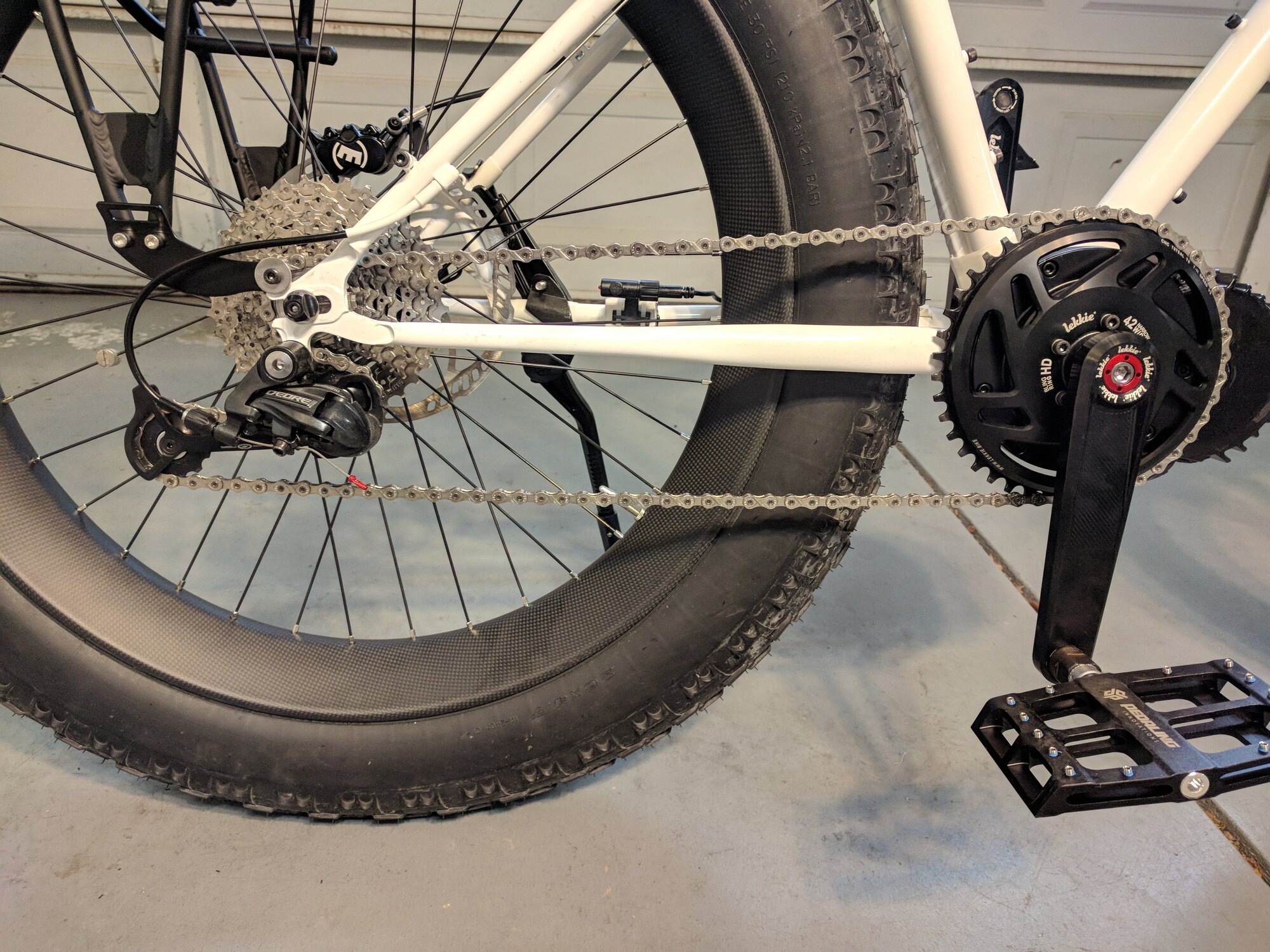

I fixed a flat on my rear tire yesterday. It seemed like between the brake disc, the gears and chain I had to take the derailleur off. .Do you need to remove it to get the wheel off?

If you have rear-facing horizontal dropouts, then your life will be a LOT easier if you just take the damn derailleur off. One minute and one screw. Done. Now the tire can come off easily without gymnastics and curse words.
Look at @Stefan Mikes directions above... the wheel goes "forward and down" which is correct. For vertical dropouts. Ain't happening with the wheel below. Wheel has to go backward which puts it further behind the derailleur and the chain. I'll skip the explanation of how to deal with that because the smart move is to spend an easy minute taking the derailleur off.
Here's something to add to your instruction set, regardless of dropout type: First thing you do is pull the derailleur cage forward. Then with all that slack, you can easily take the chain off the front chainring (off and in FRONT of the chainring, not behind to the frame) and give yourself all manner of added maneuverability
My derailleur is a Shimano but no clutch. Mine is a through axle and I think vertical. I have a chain guard so it’s not easy to take the chain off the front. It really wasn’t hard to take the derailleur off, I just wasn’t sure if it would throw the adjustment off. It didn’t seem to mess up the shifting.

Well, sadly I see Stefan still makes uninformed yet supercilious comments. The difference here is that of someone who has the experience from working on the bikes he is talking about (thats me) versus one who just talks.
He failed to pay attention to the fact I was talking about rear-facing horizontal dropouts, which are a special case. And further missed that the Park video doesn't cover that style of wheel removal. If he is operating true to form his next line is going to be that horizontal dropouts aren't used on real bikes. Wait for it...
p.s. here is the textbook way to do it. Which doesn't always work. Thats why you'd pull the derailleur (it was standard to have to remove it on Sondors X Originals).
It won't hurt a thing so long as you don't yank on it and dislodge or stretch the cable, which nobody would do, right? :D

His e-bike has thru-axles with vertical dropouts. Removing/replacing the rear wheel is the one of the easiest operations on a thru-axle e-bike had you done it once. No need for derailleur or chain removal.
sure we know that NOW, after the fact (not his fault). Just stop it already. You love to start meaningless fights.
I’m actually not sure it’s a through axle or not. I didn’t pull it all the way out, just loosened it, which took an Allen wrench. It has a knurled “nut” on the end opposite the Allen head side. I probably won’t figure all this out until I go to take it apart again. My biggest mistake was probably not shifting to the smallest cog on the cassette.
