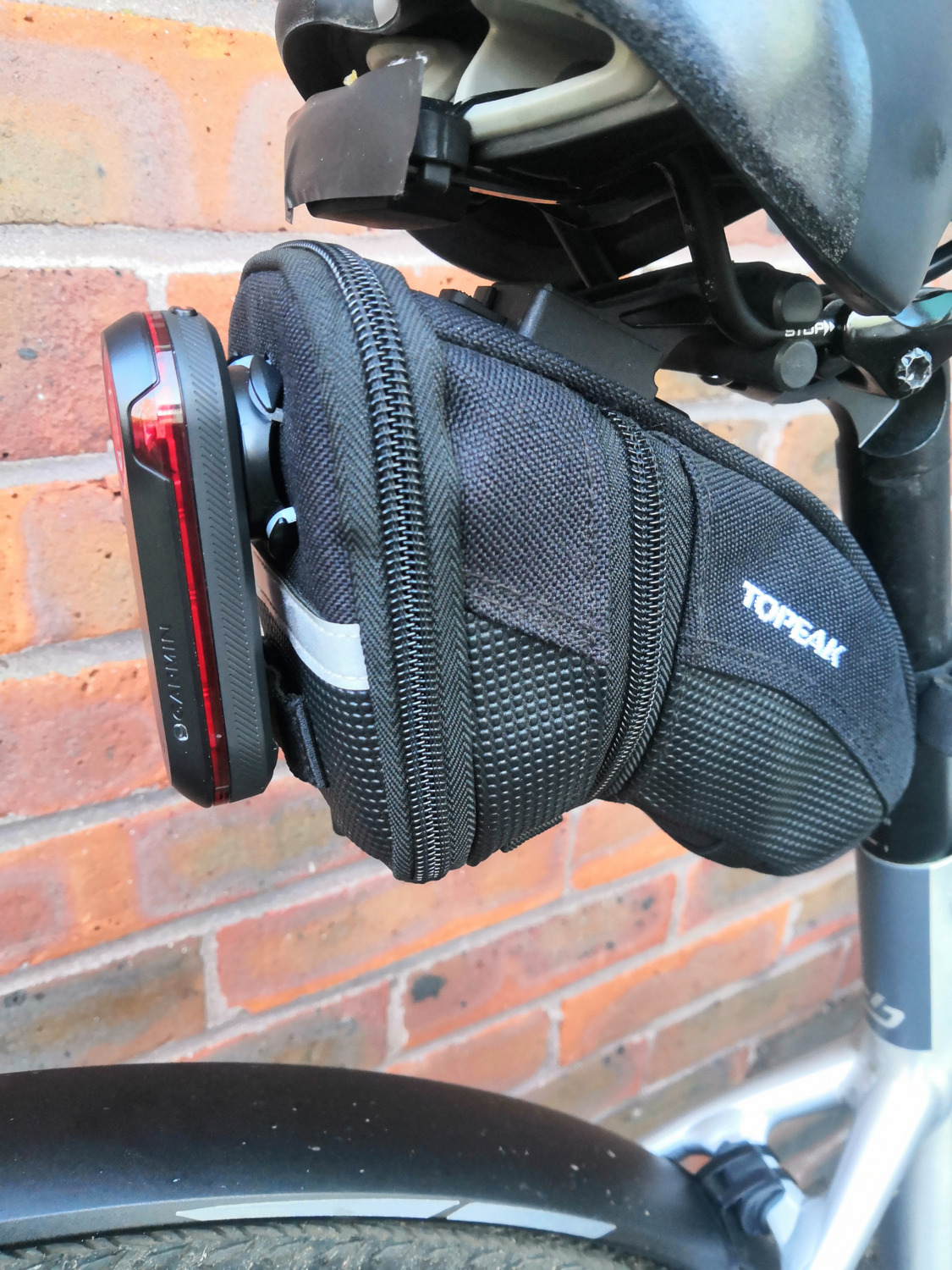

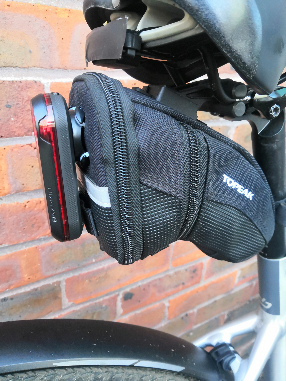

On the back of the bag? That's where I fitted my Garmin Varia - but it does require the back of the bag be at about the right angle.

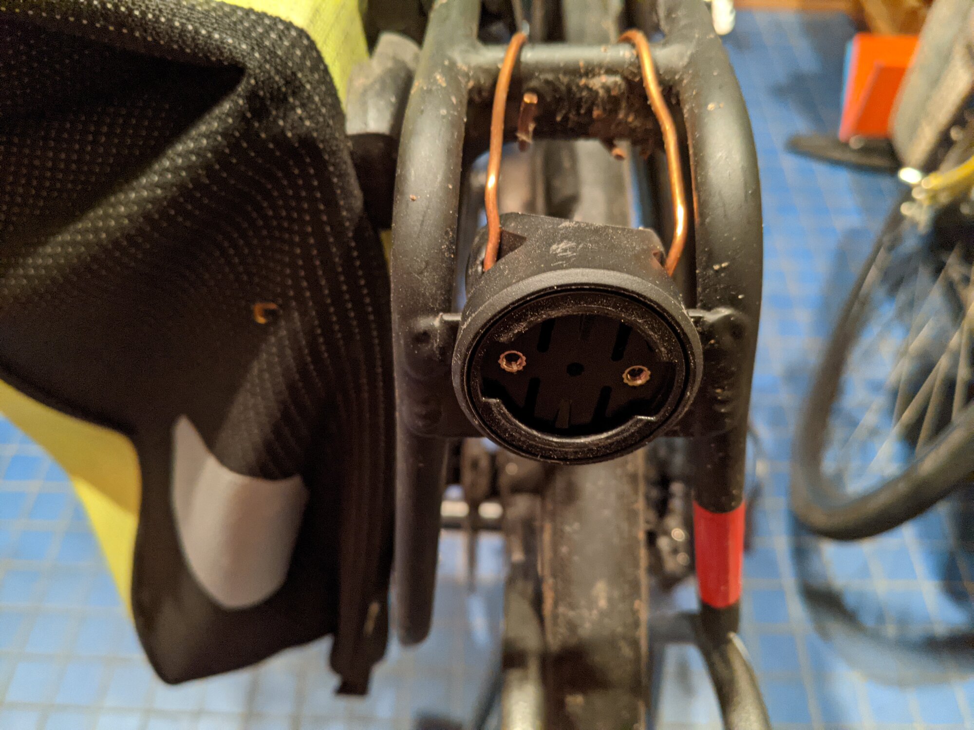

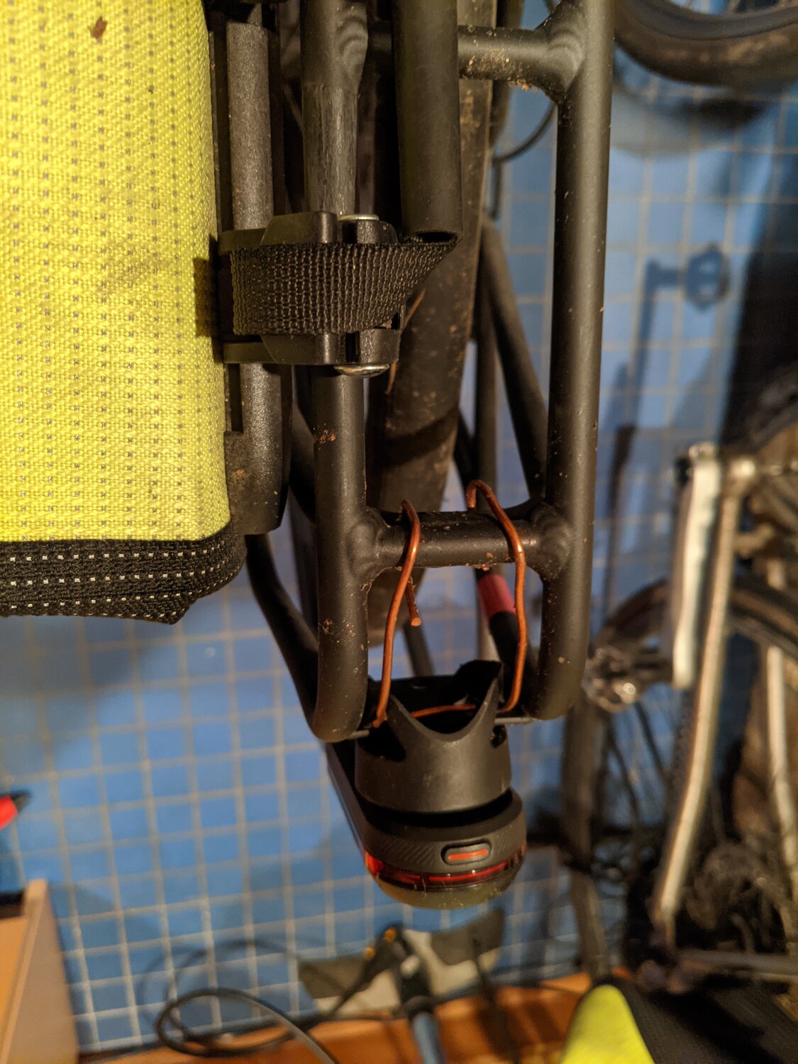

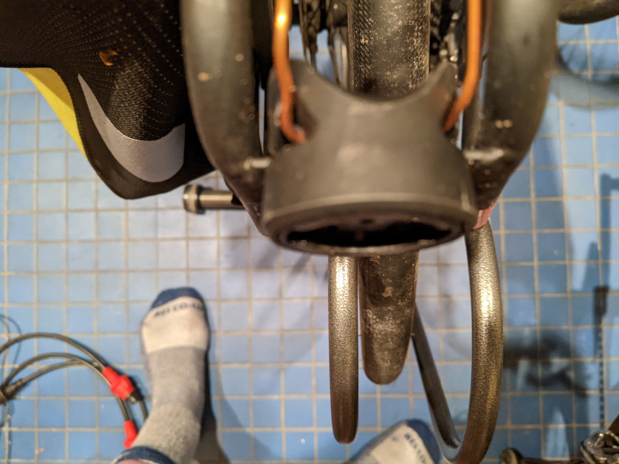

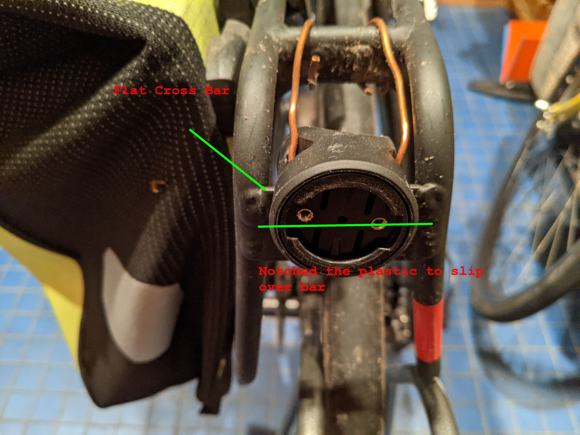

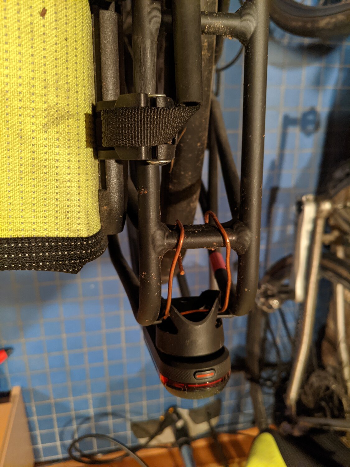

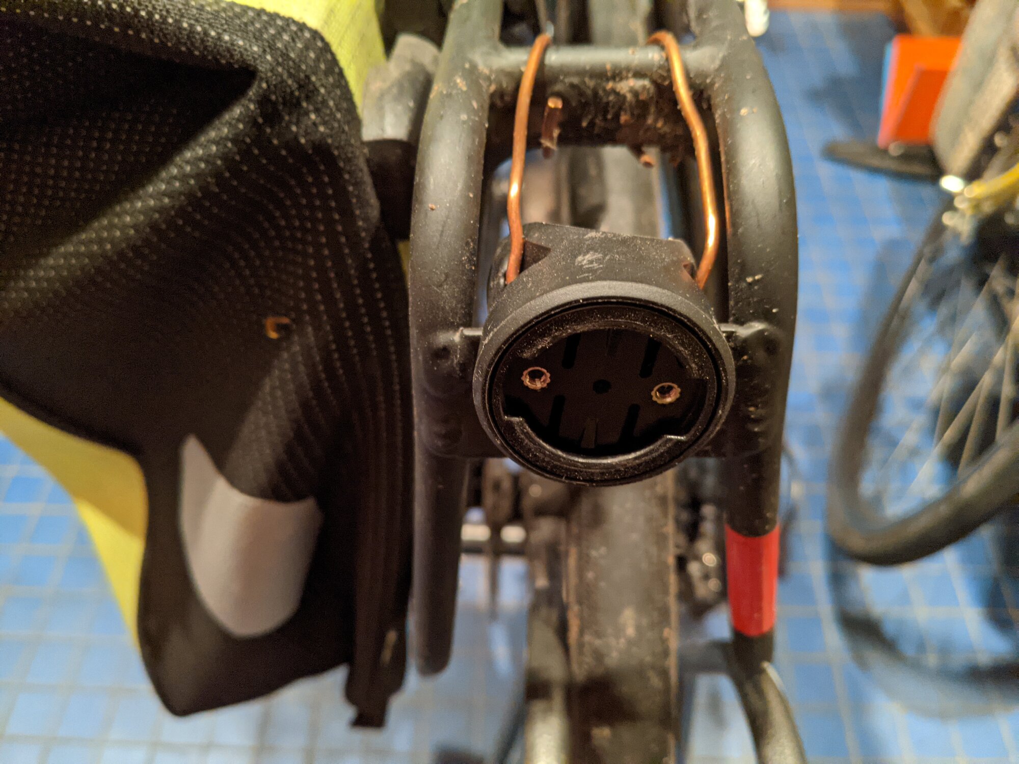

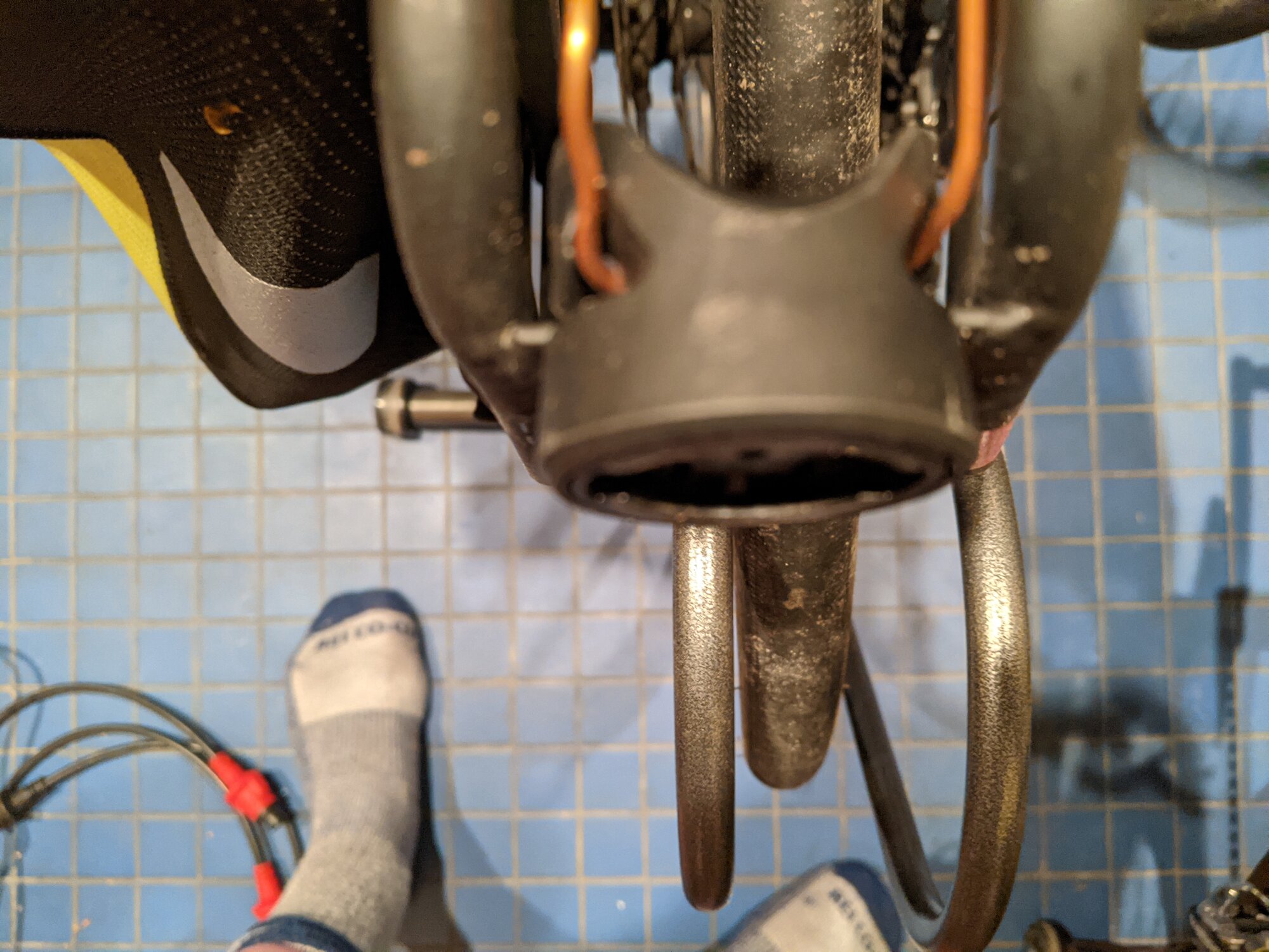

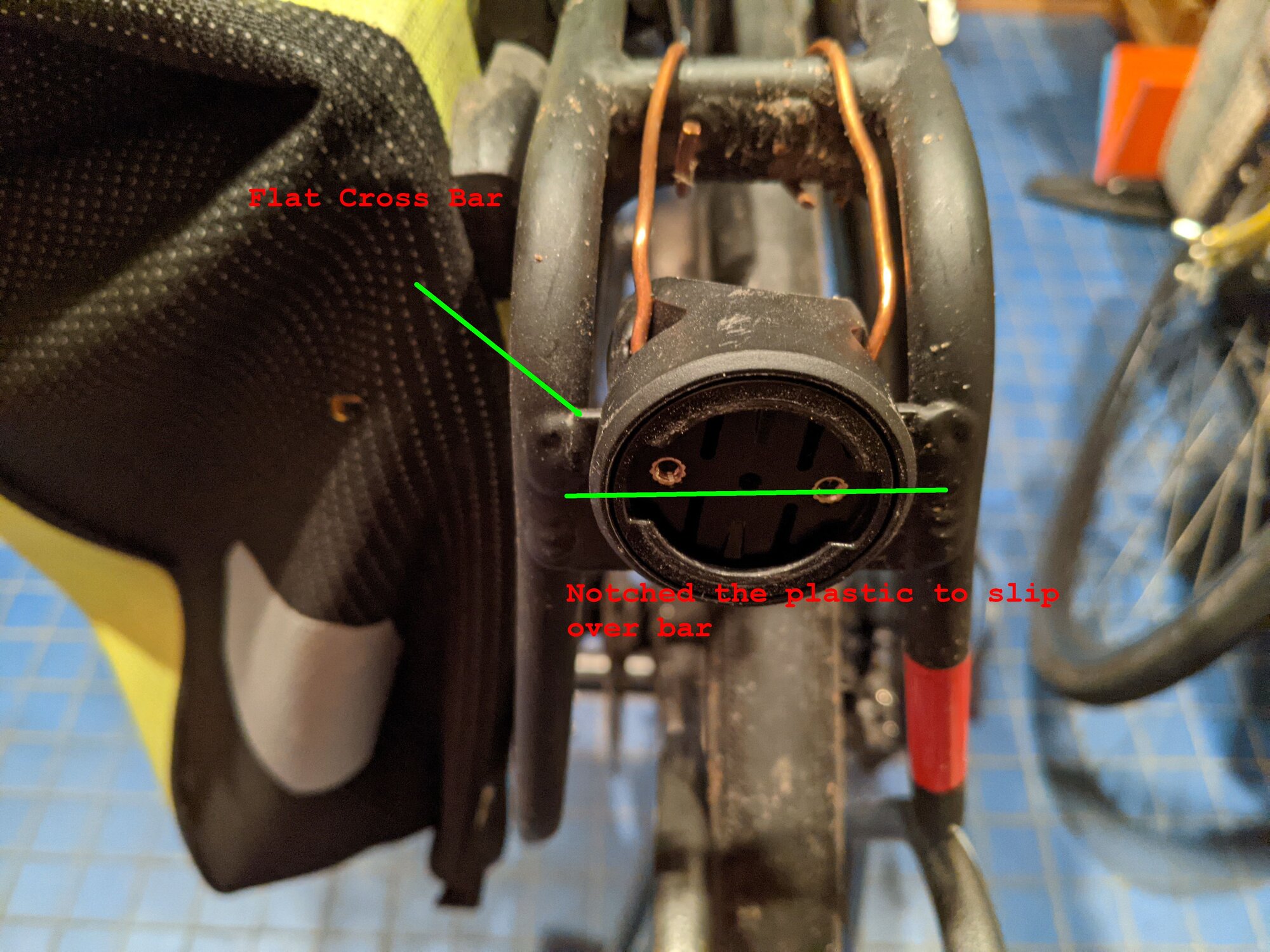

I modified a Garmin varia mount to slip over the rear bar of my rack. It slides onto a flat crossbar and then to make sure it does not pop off and goes missing, I added a bit of twisted wire. The included Garmin rubber bands were not tight enough to secure it.

If you look up some Garmin mounts, you will see they come with a few different sized "rubber bands" and the connector has grooves or slots where the band fits. So you wrap those bands around the object (generally a seat tube or handlebar) to secure it. But that would not work for my rack system. Hence the modification.

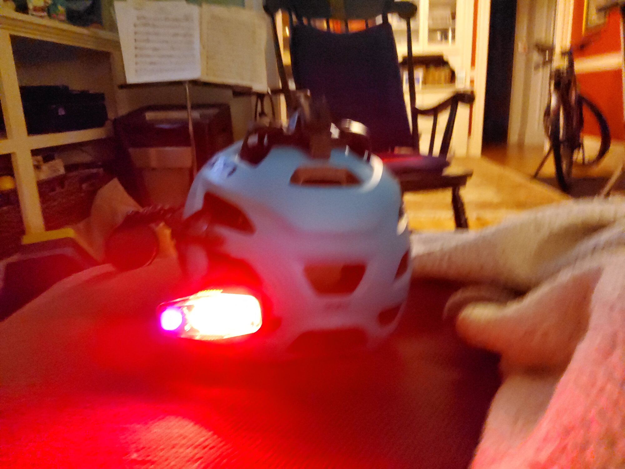

I also have the Specialized Turbo Vado 4.0 (step through) and NITERIDER front and back lights. I just clipped my Nite ridder rear flasher to my helmet (which I always wear) and never had to modify lights on my bike. I simply bought a second handlebar mount. See picture. It is on my left side of helmet so I can turn off or on while riding. See picture attached.

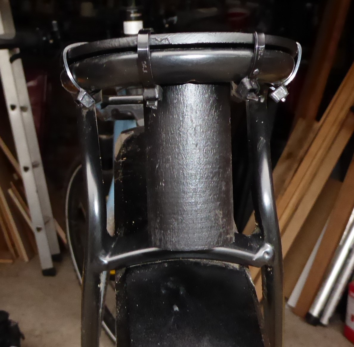

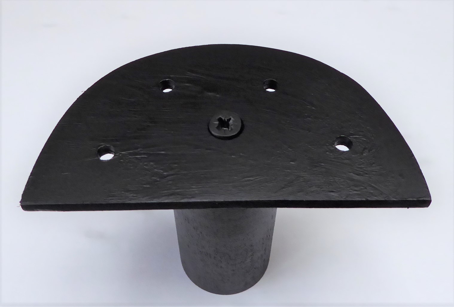

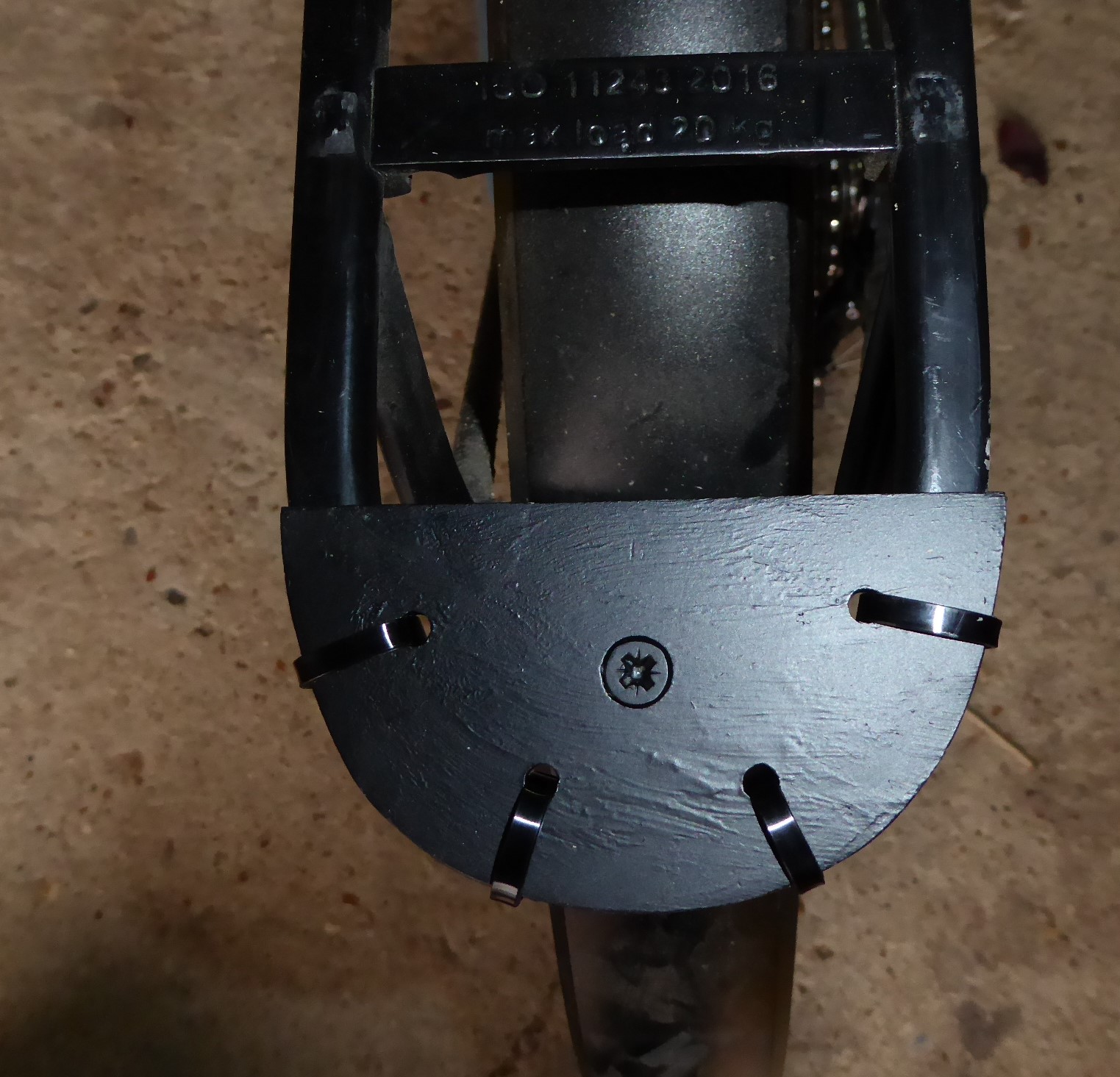

I decided to launch in to my version of the rear light bracket, having being stimulated by the responses above.
I made it up with a piece of 3mm aluminium and then turned a piece of hardwood to the same diameter as a seat post.
I decided to go this way as there are a large number of lights and accessories available for seat posts.
Many thanks to everyone for their ideas - much appreciated :).
PS: I have ordered up a Cateye LD 610
good job tried to find my setup I used but could not fid a pic. wee nI went with a garmin radar then I had to change tactics but it need up much easier since they have so many different types of mounts.
