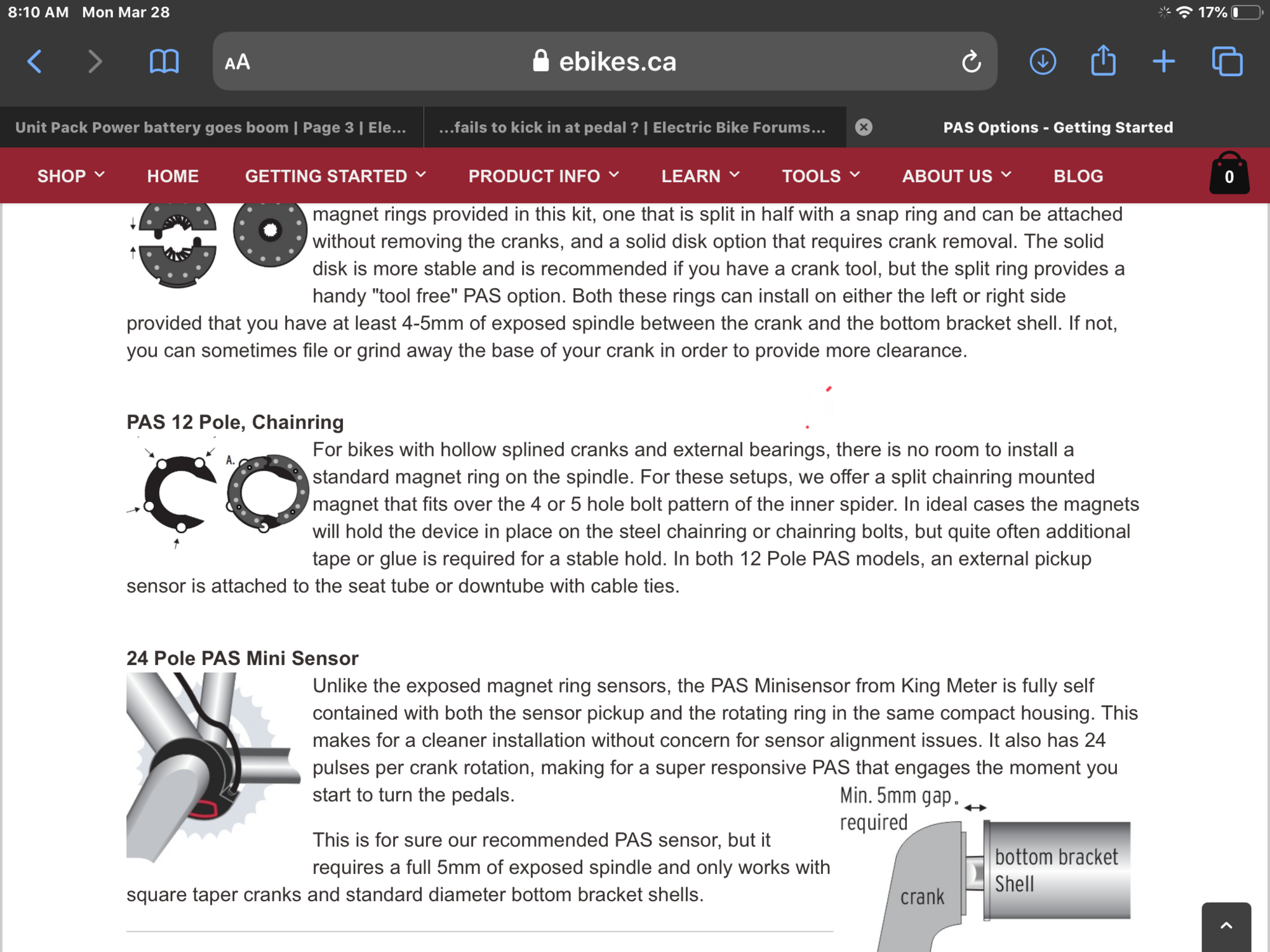

The pickup for the cadence sensor cannot be farther away from the magnet wheel than the thickness of a nickel. Push it closer by using your thumb.
Since it’s not torque sensing and has 9 levels of assist it must have a pas sensor. These days there are improved pas sensors that are much more discrete as well. Chain ring versions too.
I’ve had situations where I couldn’t get closer so I bought a bunch of neodymium discs.
those powerful magnets dont fall off IME.
This is very funny. A guy purchased a bike from a friend in Santa Cruz. It was bucking like a wild horse. I found that I could make it go on PAS by moving the pedals back and forth. Someone had done a sophisticated prank and reversed the polarity of almost half of the magnets. With April first quickly approaching, this is something to keep in mind.
