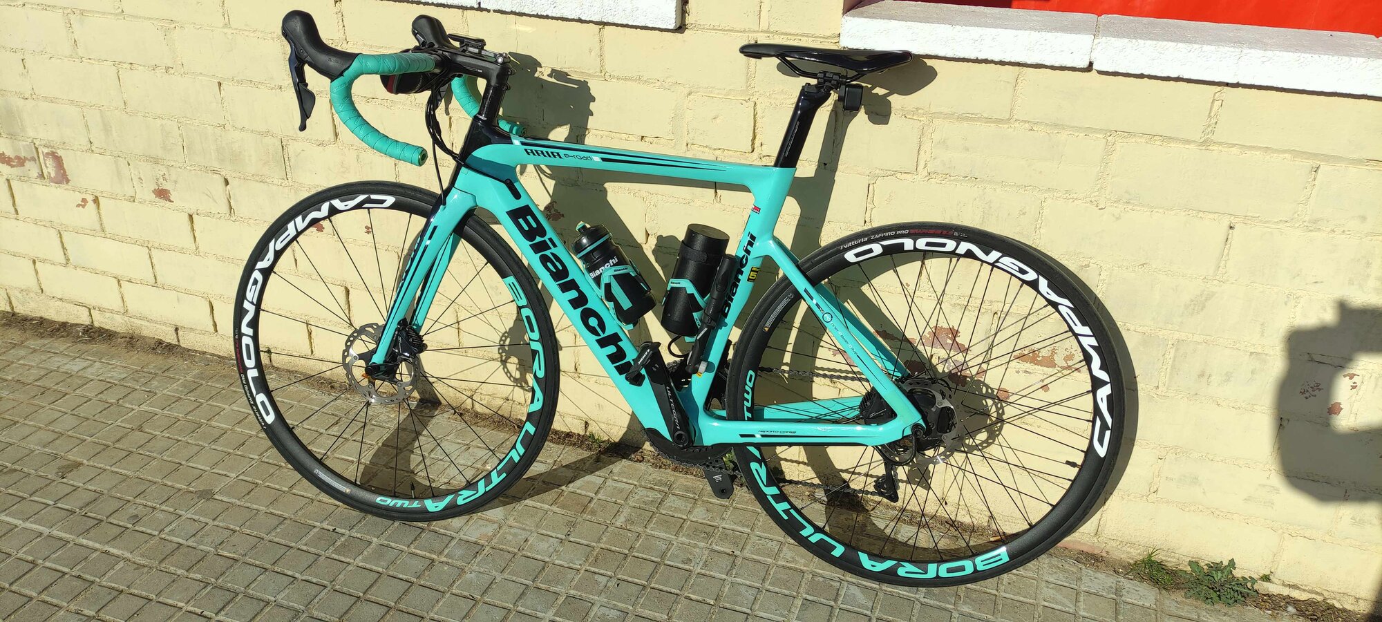

I have the bianchi aria e road, and I have an additional extender, the problem that mahale extenders give is compatibility with the bike's software, so that this does not happen, you have to update the bike's firmware using some cables and the software that You have to provide mahale to the bike dealer, to avoid that they sell some extenders in volabike, Spain, I have one and without problems, it works perfectly.

The one from Mahale will give you problems with the software of the bike's battery, you'll have to update it, if you buy the one from Volabike you won't have any problems, I have one.

The picture of the Bianchi bike has a Volabike range extender battery. I have the Mahle range extender battery.
