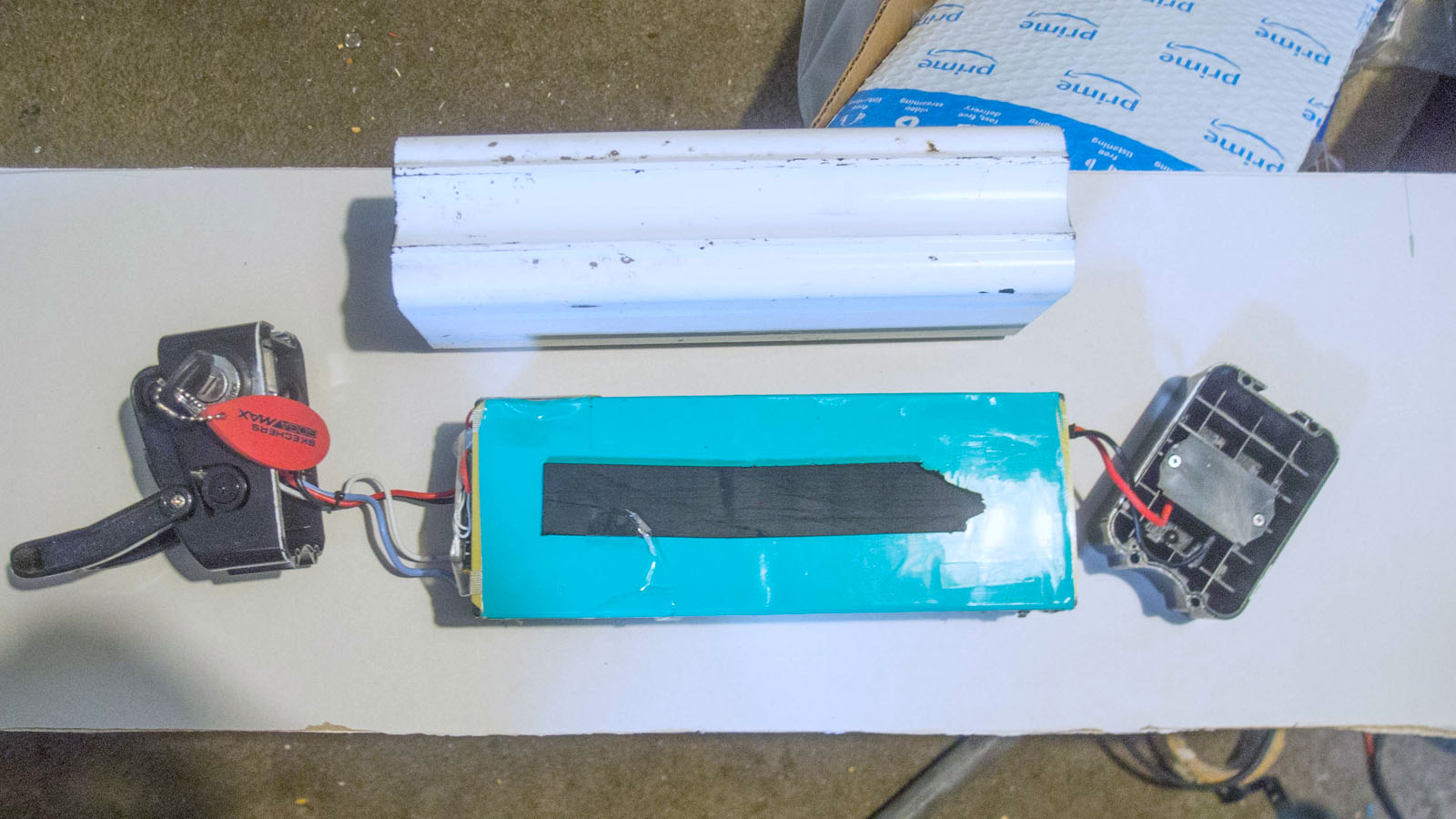

Unfortunately, it uses something like the common 36V Silverfish battery but not quite the same. Doesn't use a rear strut and the key is on the wrong side. so it must attach quite differently. I doubt that you're going to find a replacement,
You don't have the old battery?
A good ebike hobbyist could find a way to fit a new silverfish or maybe a Hailong style battery. It's a labor of love though to do it right, with no rattles or disasters.

Yes, that’s the bike. I have the empty batter cassette but the innards have been removed.
Thank you for taking the time to reply
Well, if you still have the battery cannister, a re-cell service could transplant the cells and circuitry from another battery into it. Not a hard job,
Most? No. Some, maybe. There are e-bike battery rebuild services like Hi-C that may be able to do it for you. Are you sure that everything else is there? Controller? Display? Controls?
