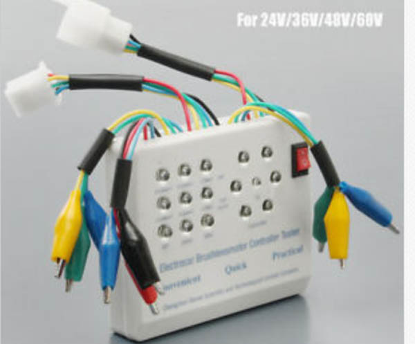

A Bike Doc should have one of these testers. They're set up for the older motor connectors, but you can make a 9 pin adapter. Like 12 bucks on ebay, More on amazon,
You can verify if Hall sensors are good in less than a minute, You can also use it to figure out the pinout on a PAS or speed sensor and see if they work.
Seems to check continuity on motor phases, but I've never had a bad motor.
Finally, if you set it up correctly on a controller output, there is a unique LED pattern display in the circular LED's. If you change the phases, the pattern changes. Could help recognize the right color scheme for the wires if you know the first pattern. In any case, tells you if the controller phases are cycling,
Thanks HarryS, I have one, and am collecting/making connectors. Currently I use a trusty volt meter, and even sprung for a PC based oscilloscope. I need to practice with the gismo on a working bike ;-)
