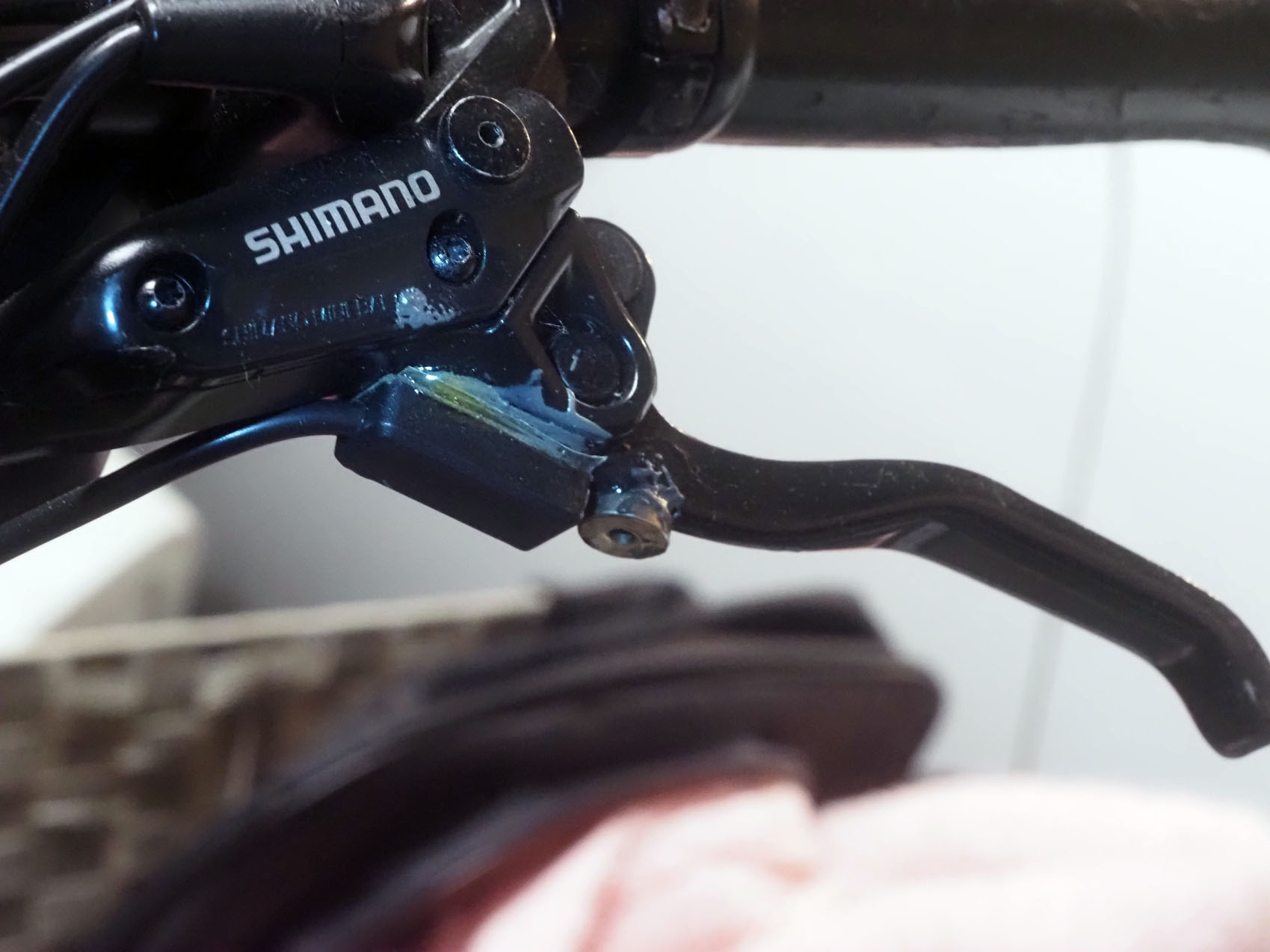

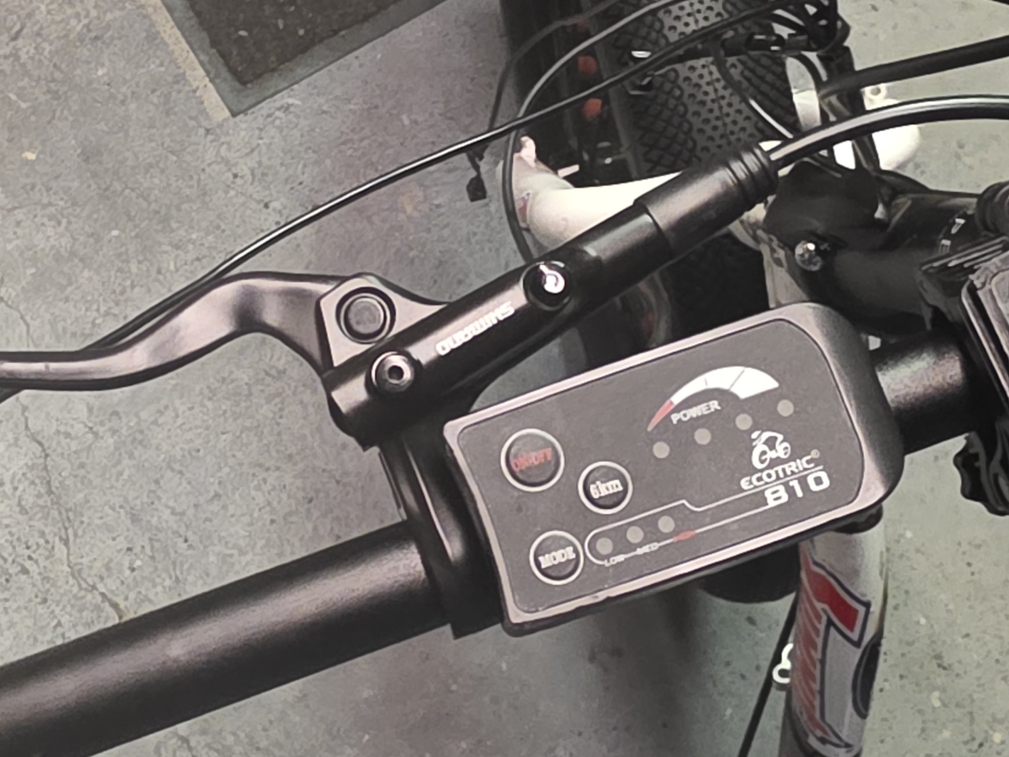

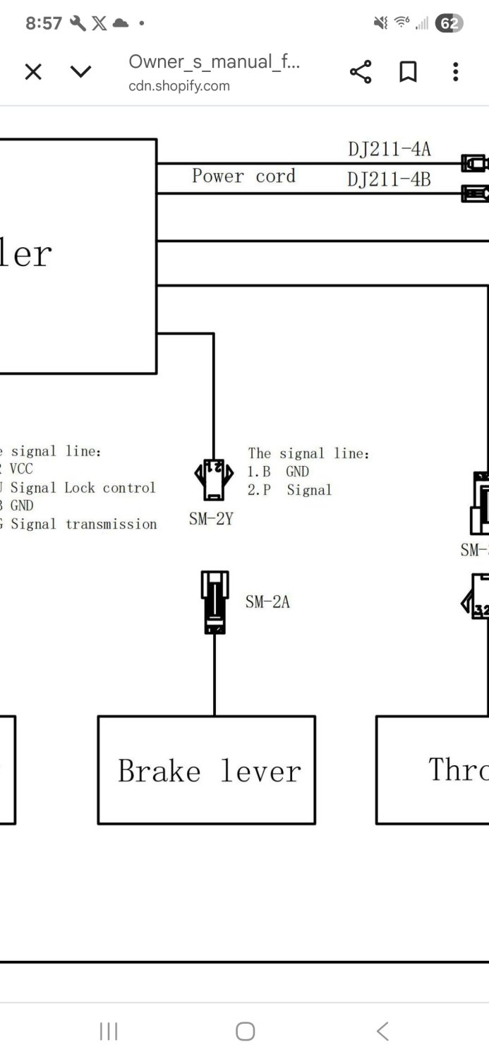

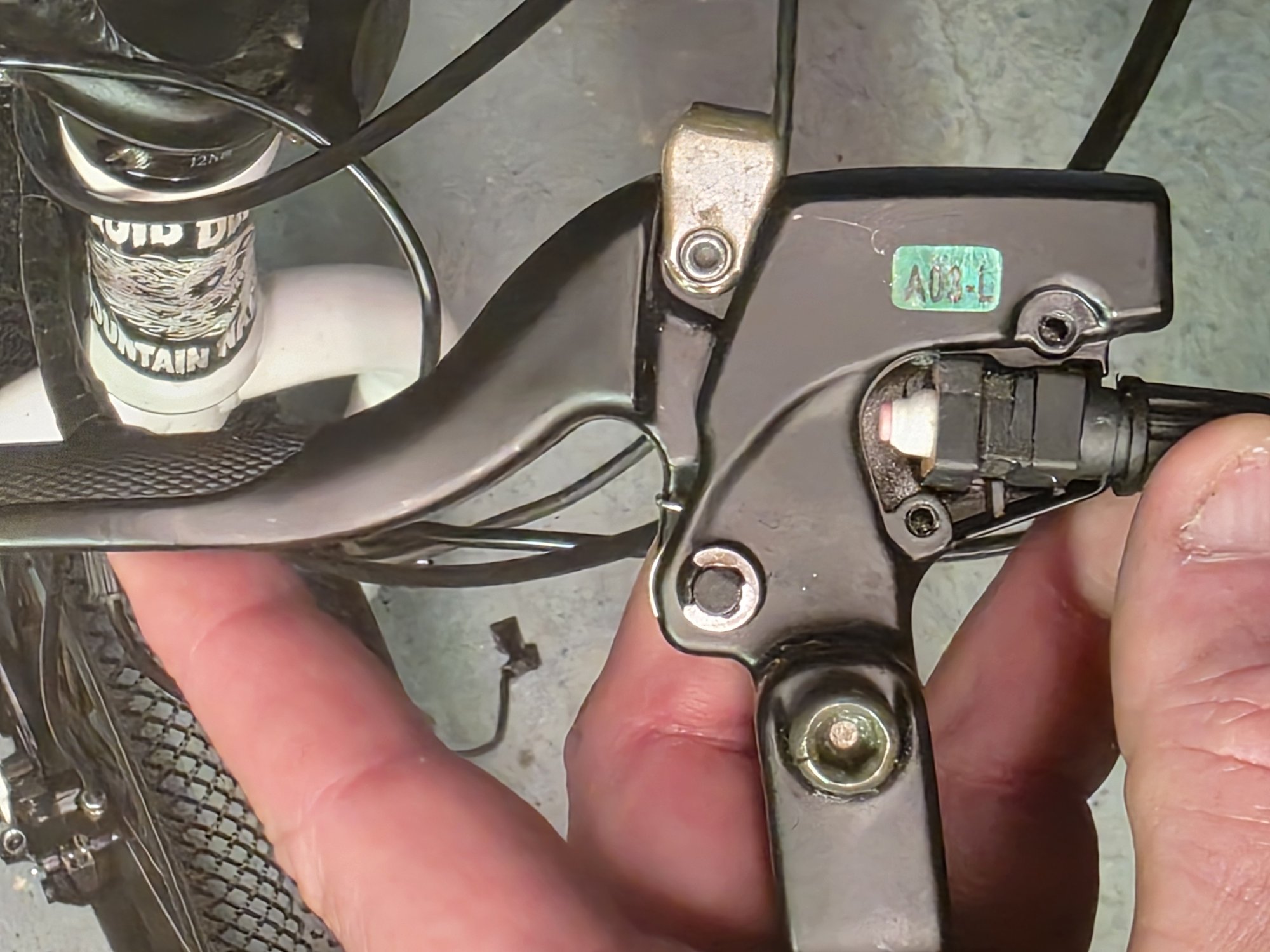

Original 4 yr old manual brakes adjusted & worn out to the point of being non-functional (yes I rode it that way for awhile). Purchased/installed pre-bled hydraulic Shimano MT-201 lever/caliper(s). Brake fitment is good, I was expecting the motor/brake cutoff to be magnetic (bought some universals) but is a 2 wire momentary/latch type.
Current plan
Current plan
- Send back magnetic switches
- Find a small enough momentary/latch to take OE equip place
- Override switches for the time being
