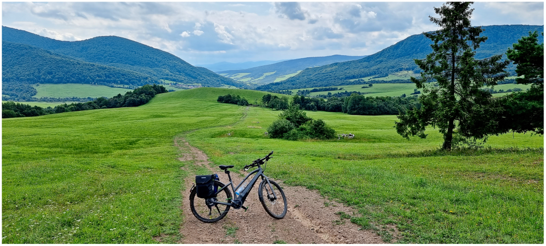

I have been to your country during last vacation. I could have taken my Vado SL 4.0 or "full power" Vado 5.0 there. Guess which e-bike I chose?
"Full power" Vado 5.0 in Slovakia. Nominal weight 24 kg. I climbed Cigeľka Mt (and Javor Mt. before) with this e-bike. Max grade was 18.4%.
Approaching the Polish border.
The sight from Stráňany Pass
On 12% climb towards Lesnica Pass
I would have never chosen a lightweight e-bike for Slovak mountains unless I were young and strong.
