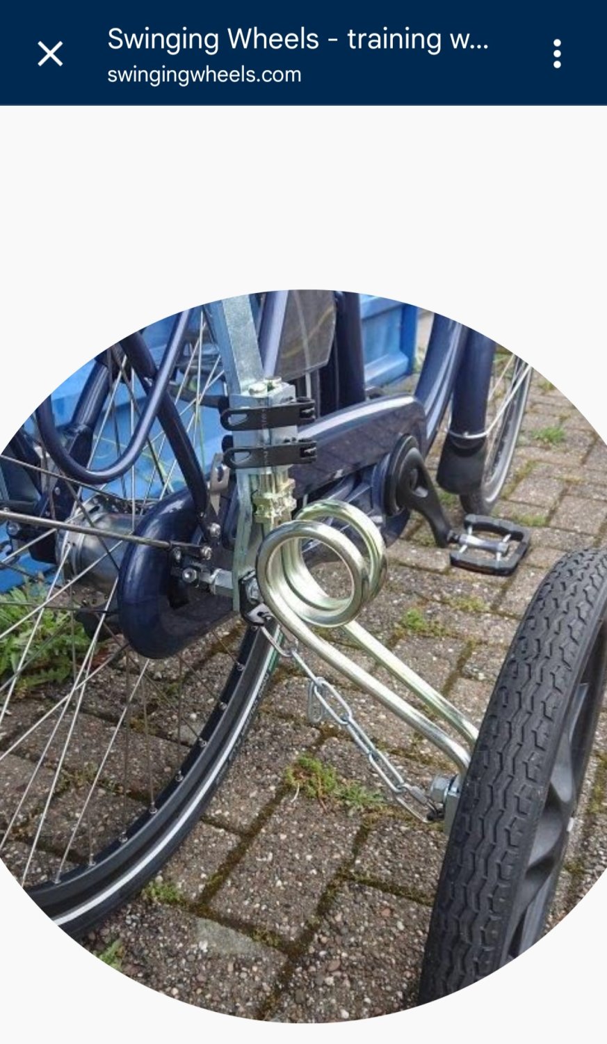

I've watched our kids, and later their kids, learn with training wheels. They sort of work when you're short and on small wheels, harder to tip over. Nonetheless, that rear wheel will lift off the ground when the kids turn the handlebars. Would get worse with a full size bike. Unless you ride really slow, fixed training wheels seem to me like they're too unstable for an adult bike.
I couldn't see anything special about the Swinging Wheel. Maybe it has suspension to allow the bike to tilt, keeping the rear wheel on the ground. That's what is needed.
Yeah, It Does !!!,..
It's kinda 😎 actually..
that was why I was thinking in that direction, with these wheels the bike almost rides like a normal bike but is hard to tip over. Easier and cheaper to get installed than for example https://www.tworby.nl/
