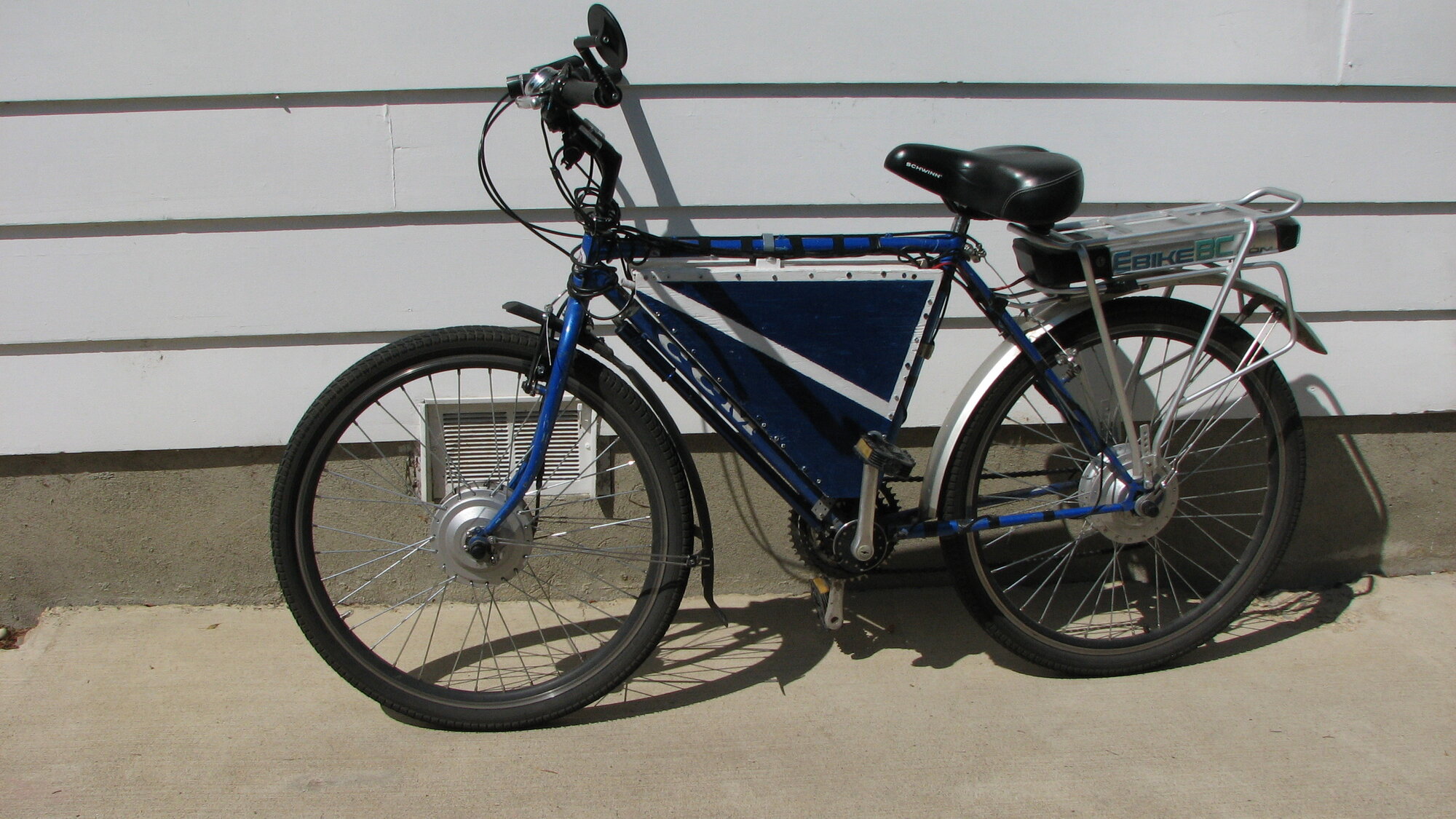

Converted my older bike into a dual motor version for off-road riding, 2 motors 500W each, peak power 1400 W, max torque 160 Nm,
top speed 45 Km/h, one rear rack battery 36 V with 16 Ah , a second battery 36 V with 15 Ah in the triangular middle section of the bike which contains
also two controllers, pedal assist for each wheel individually, also two throttles which can be operated independently or together.
Suspension would be good for both wheels which would make the ride a bit softer.

Spokes are 12wg, I do not go down very steep hills, I am an active senior , well adjusted V-brakes with good brake pads are just fine for gravel roads, works great on moderate terrain,
the battery weight in the rear does not make a big difference in the center of gravity location.

Nice. Got torque arms on the front motor?

Front and rear wheels have torque arms of course, I would not ride without them.Yes, going on gravel or soil requires caution, especially
when it is not packed, I am only an occasional off-rider.
