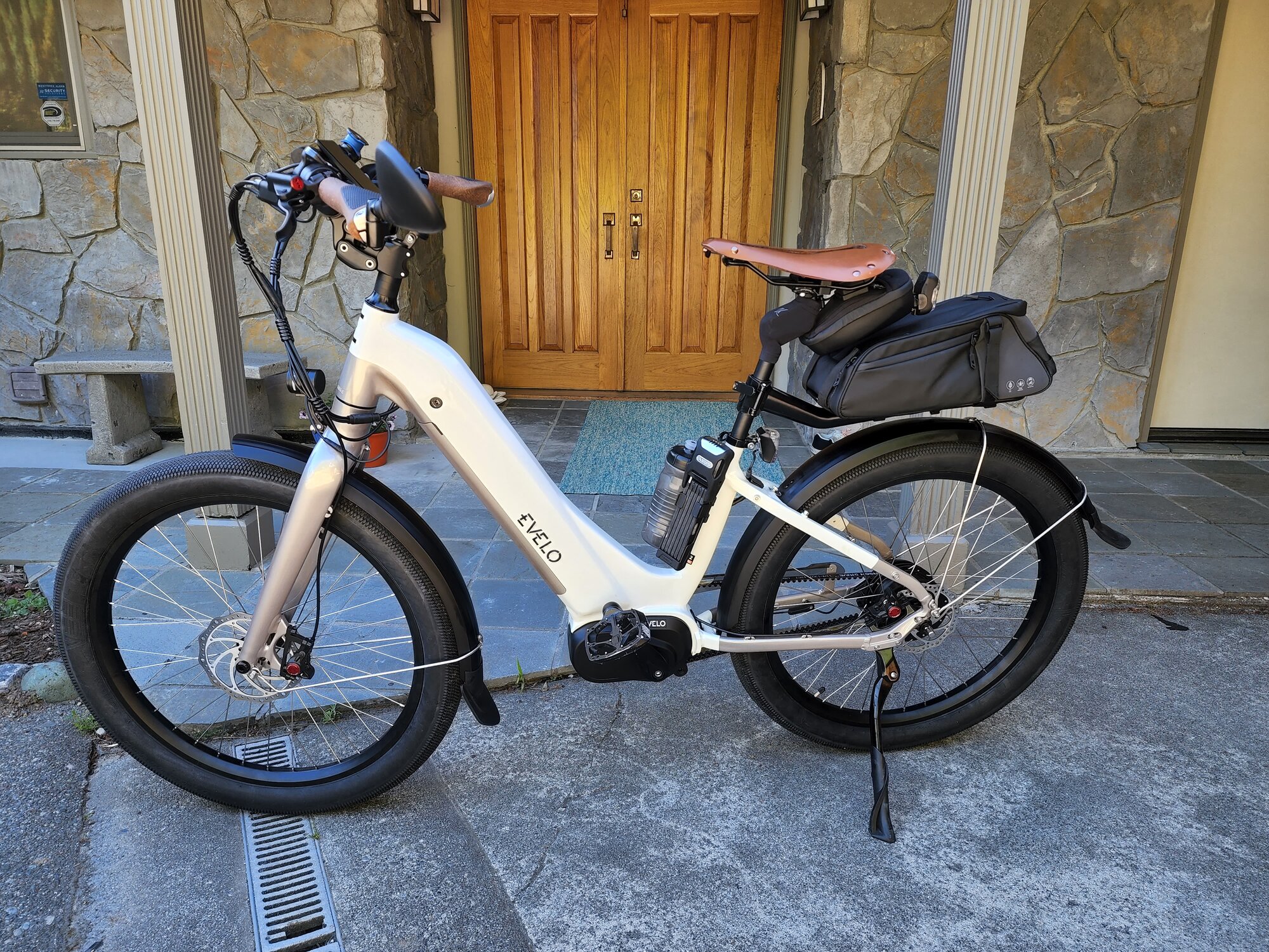

This is the new model Omega by Evelo that I bought. It is an awesome bike with great power, 750 watt Dapu motor, 720 Watt battery, very well built and a Enviolo Automatic CVT with belt drive

Preview....great bike, well speced, well made, great power, quiet, well behaved drive train, good stiff frame, with addition of Kinekt seat post and shock stem, surprisingly comfortable...a real wolf in sheep's clothing. My first experience with a DTC bike maker and could not be more impressed with quality of service and communication.
