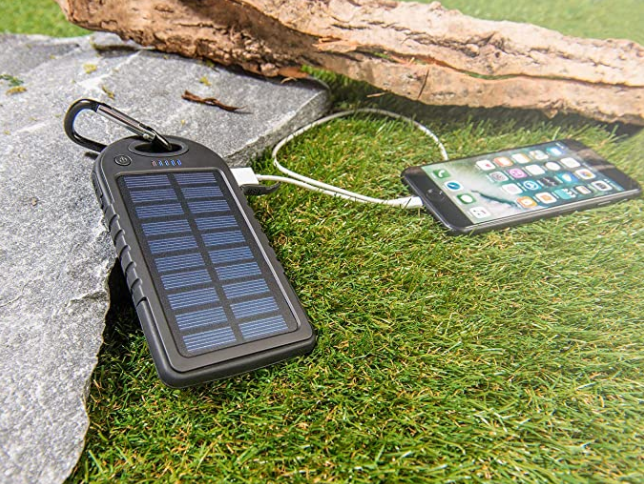

@ Arcon - You might try one of these small solar power packs. I've used this one for quite some time to power a small fan on camping trips just to add some air movement in the tent. It should work equally well to power a GPS. This is just one version, but there are literally dozens of these on Amazon re-branded under different names.
• Battery Capacity: 1200mAh Li-polymer battery
• Solar Panel: 5V, 280mA
• Input: 5VDC/1A
• Output: 5VDC/2x1A
• Dimensions 167x89x18mm
• Includes LED flashlight

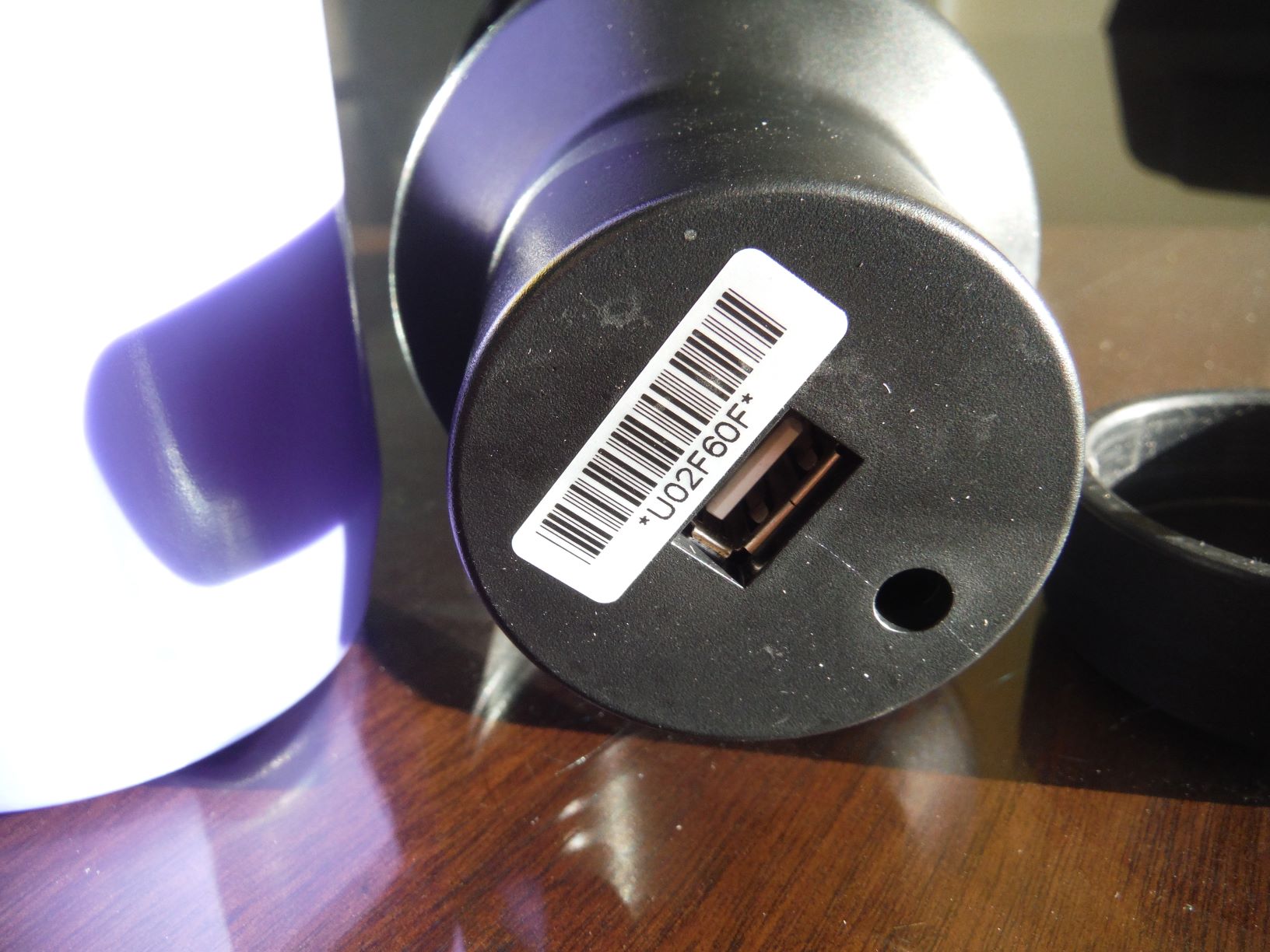

I like the water bottle style batteries. They fit in a standard cage, come is a selection of sizes and have a USB port on top.

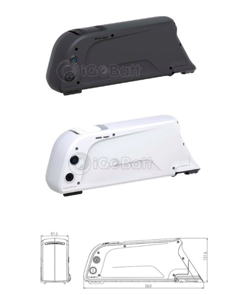

Here are a few options to start hunting (Second one looks like Uma's model):
They are meant to be a primary battery for a home build, so not cheap. You could make a light version with a big HD USB power bank and a water bottle for maybe $50.
Hopefully Uma has a link to someone who stocks it on the NA side right now. Supply chain and all...

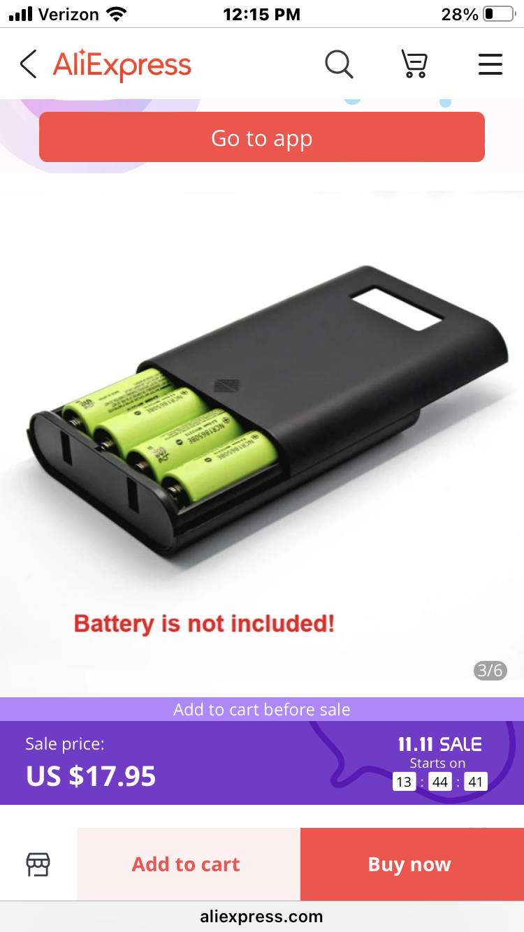

Because I have an iPad, iPhone, bike lights, and other devices that need charging I found a 4 18650 cell power module and prefer using it over my battery packs. I also have a 2 cell version.
