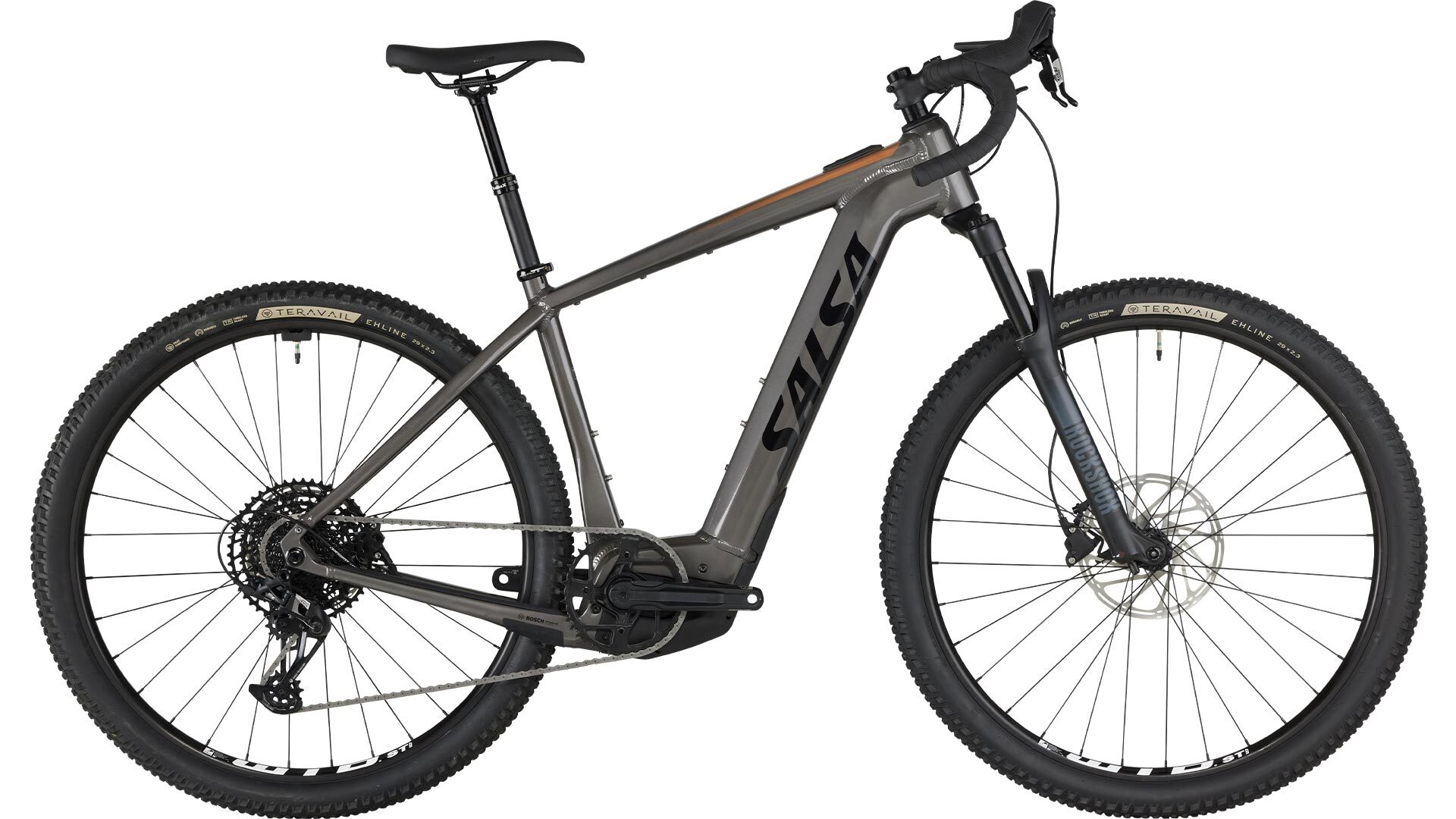

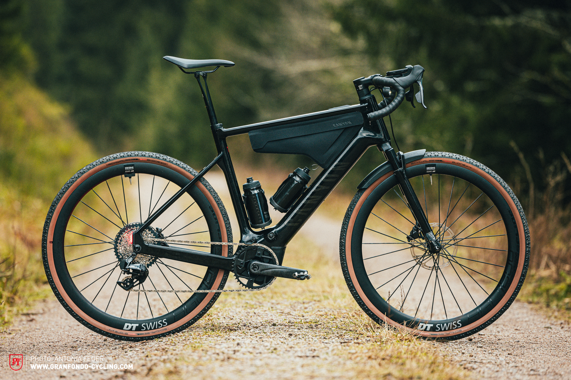

The Canyon Grizl: On and Salsa Tributary are two of three that I know of.

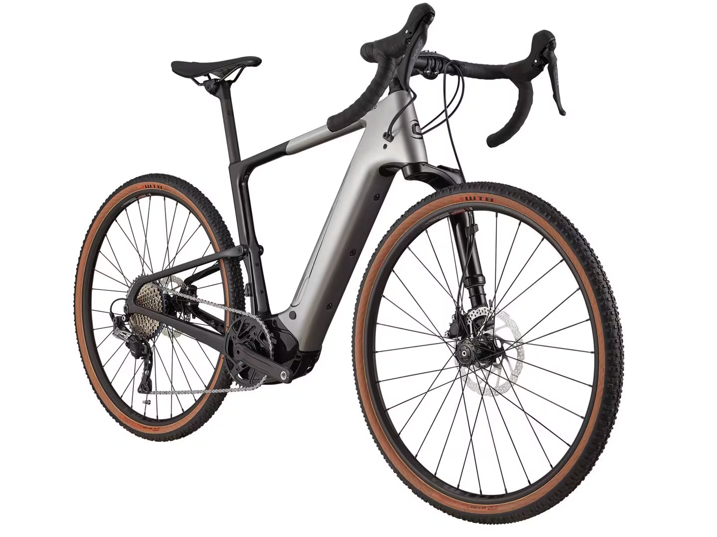

The Cannondale Topstone Neo Lefty 3 is the other.

  • Salsa Tributary. Full power motor, 625 Wh battery, 120 mm travel suspension fork, estimated weight 49.5 lbs (that's over twice a traditional gravel bike!)
  • Cannondale Topstone Neo Carbon 1 Lefty. Full power motor, 500 Wh battery, 20 mm travel "Lefty" suspension fork, estimated weight 39 lbs. I looked at the Cannondale website and it looks that specific e-bike has been discontinued?
  • Canyon Grizl:ON. Full power lightweight motor, 400 Wh battery, 40 mm travel suspension fork, estimated weight 34-39 lbs (depending on the version/price)

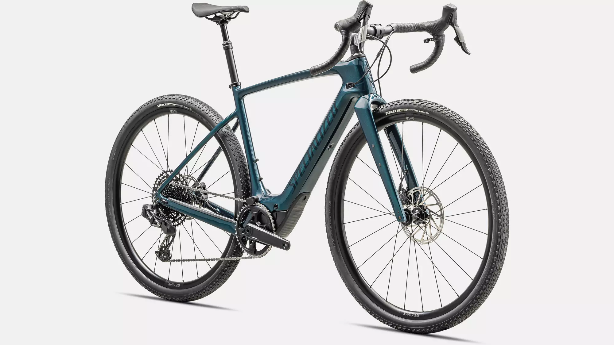

  • Specialized Creo 2. Low power lightweight motor, 320 Wh battery (and 160 Wh Range Extenders available), 20 mm adjustable suspension stem, estimated weight 30-33 lbs depending on the version and price.
Specialized Creo 2 Comp, 31 lbs.

It really depends on where you ride and how rowdy the conditions are. As @Stefan Mikes pointed out, the Redshift Shockstop stem and seatpost suspension setup combined will likely get you through most washboard or harsh bumps. Canyon’s split seatpost also offers up to 25mm of movement to minimize impact and harsh road buzz. With 40mm of travel on Rockshox’ Rudy XPLR fork which comes equipped on both Canyon Grizl: ON and Salsa Trib you won’t have to worry about blowing through and bottoming out. The in-built suspension system on both of those models allows you to tailor the spring pressure by simply using a shock pump. Rebound damping is adjustable using a 2.5mm Allen key and locking out is a matter of reaching down and twisting a dial on the fork crown.

That Salsa Tributary looks like a hardtail MTB with drop bars to me. Which is a real thing people do.

And since @Stefan Mikes mentioned the Creo 2: I did an online chat with them and they sure made it sound like there wouldn't be any more Creo 2's in stock. It would make some sense that the Creo line might come back this fall with different components. I'm doing my part to cause this by buying a Canyon Grizl:ON instead.
