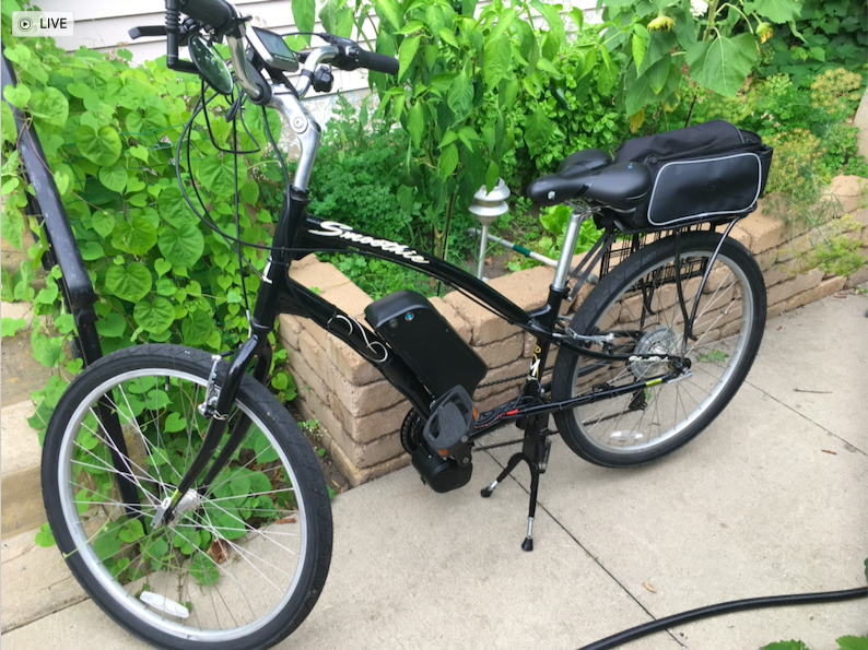

The earliest version was not as reliable as they've become. We trialed samples maybe 5 years ago. I donated the bike to a less fortunate fellow and he's put 3500 miles on it and I donated another $200 in repair parts. Over that time. In fairness, it is road hard and put up wet. The worst issues were with the displays and firmware. That has also been significantly improved.
