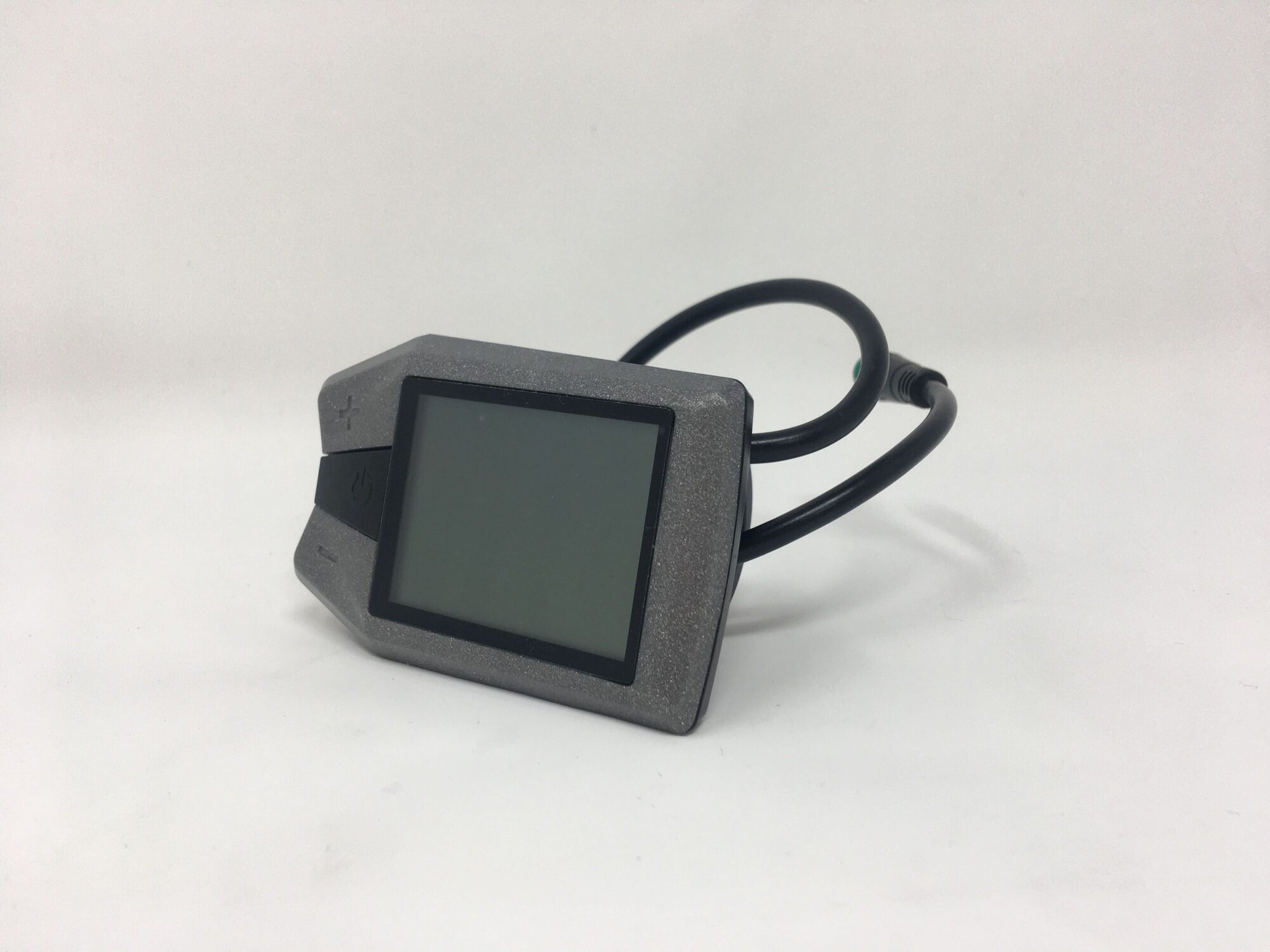

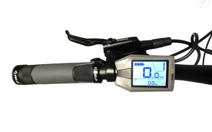

Hi, would anybody know how to adjust parameters on this display please,This is a new display installed by dealer where bike was bought and different to old one. you press + - together to access menu. When cycling through to the speed limit i found it is only 20.5 km/h
which is only 12.5 mph. I wish to increase to 25km/h 15.5 mph UK legal limit. When in menu I cannot get any thing in there to change change. The bike make is Oxygen, Any help would be very much appreciated.
Many thanks

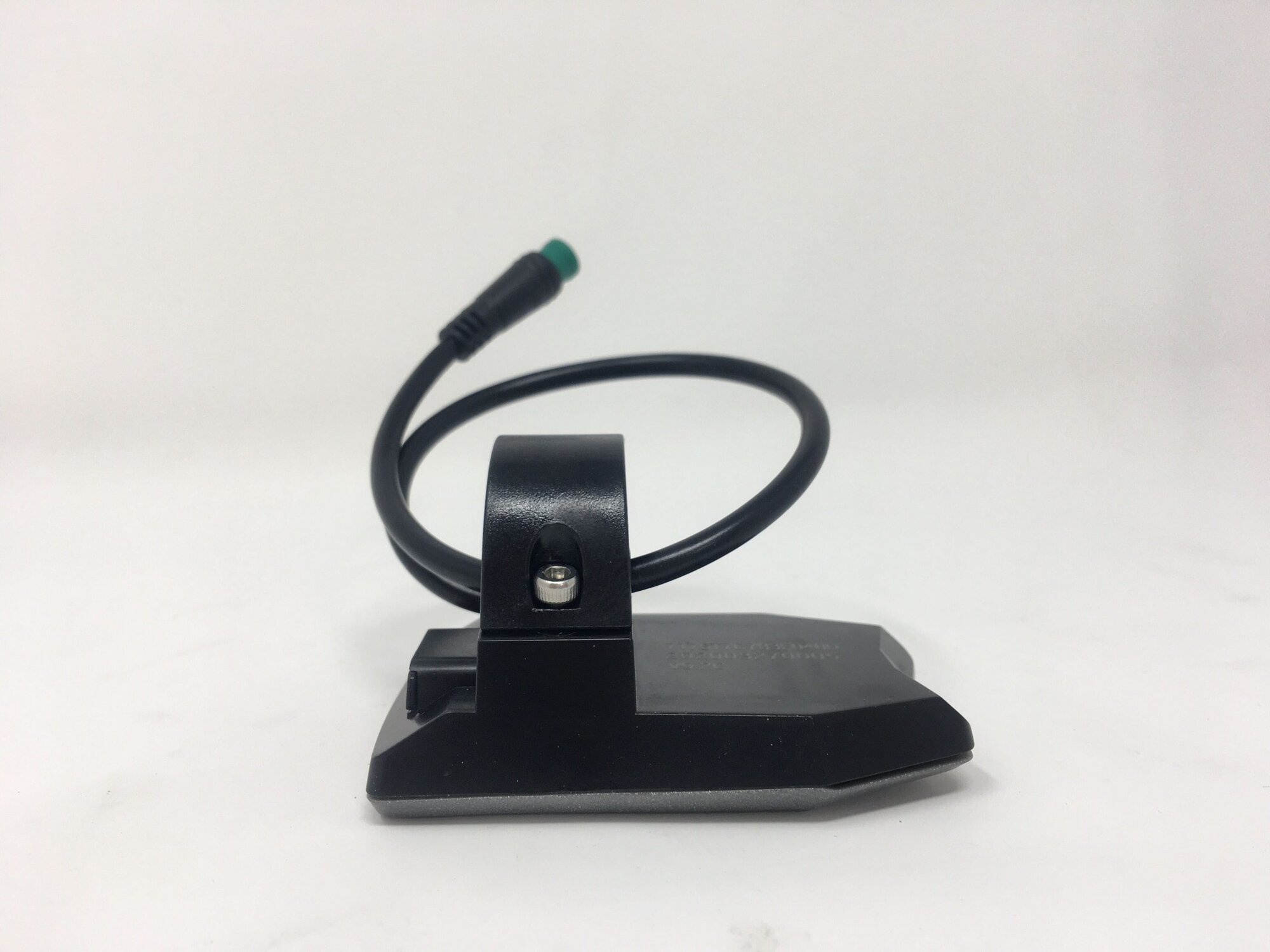

@ Novice - Can you make the image larger by attaching it? It's the size of a postage stamp. Also, a picture of the back might be helpful.
Are these better?

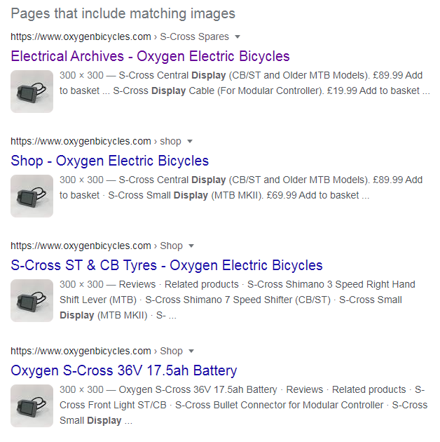

@ Novice - I put the picture into Google image search and came up with these links.
You might want to contact Oxygen Bicycles and/or EcoRacer see if they have a PDF copy of the owners manual they're willing to share. Hopefully it includes specific information on the controller.
If you can post a picture of the back of the controller that clearly shows the text, it may be possible to determine the part number or serial number and look that up that way.
(www.oxygenbicycles.com/product/s-cross-mtb-2020-screen-compatible-with-all-s-cross-models)
(www.webshop.ecoracer.se/en/product/s-cross-l-white)
If you know the eBike's motor manufacturer; (e.g., Bosche, Bafang, etc.) it might help track down who makes the controller and display as they are usually matched to the motor.
