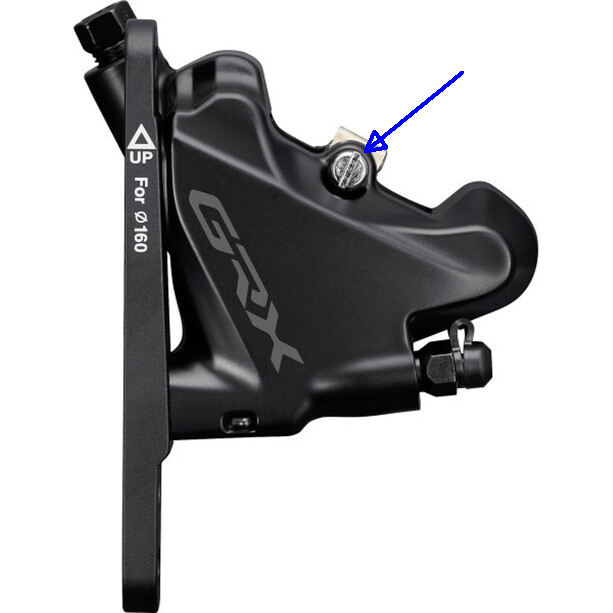

Besides, the brake pads in GRX 400 are secured with a screw to be removed with a flat screwdriver.
