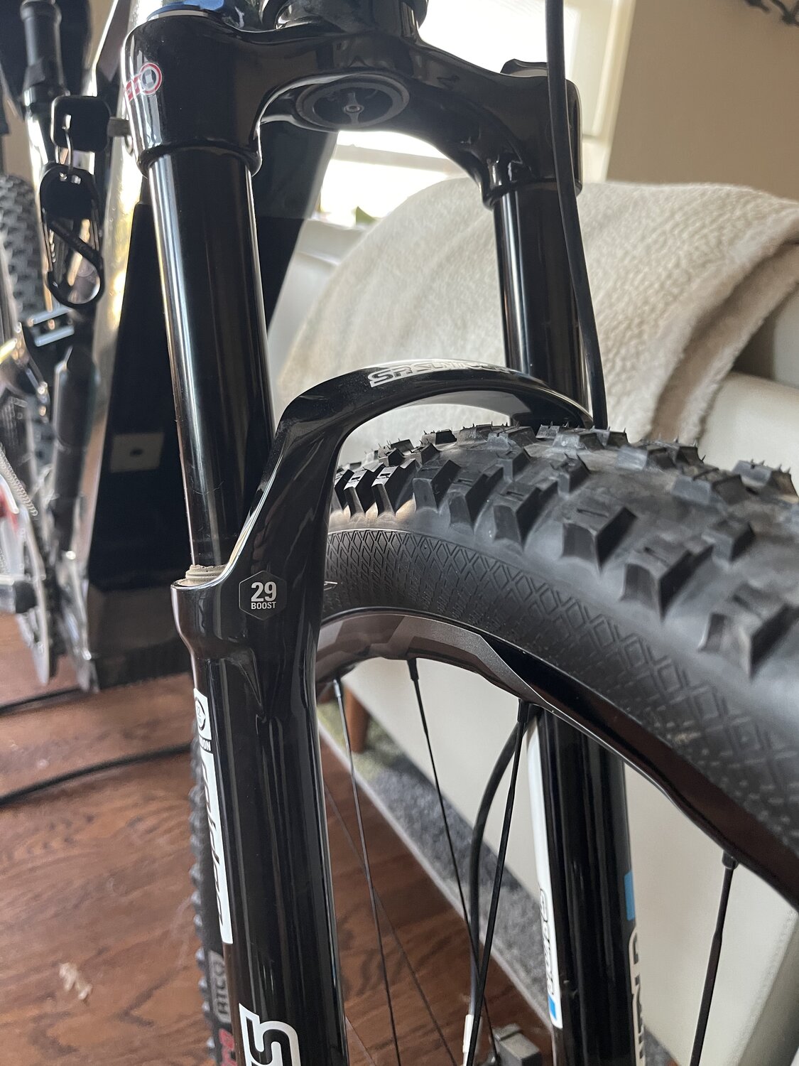

The ‘mullet’ conversions is done and the 29x2.6 fits on the Suntour Raidon without issue. Mavic wheel and Kenda tire.
Looks like it raised the bb height maybe a 1/4” from my very rough measurements. Have not had a chance to try it out yet as my rear brakes have lost all pressure while just sitting in a stand(?), but looking forward to getting on the trail with this config.
Takes a few rides to get use to but you'll like it better. I tried mine out a year ago and never looked back. Ride it hard it will not disappoint.
