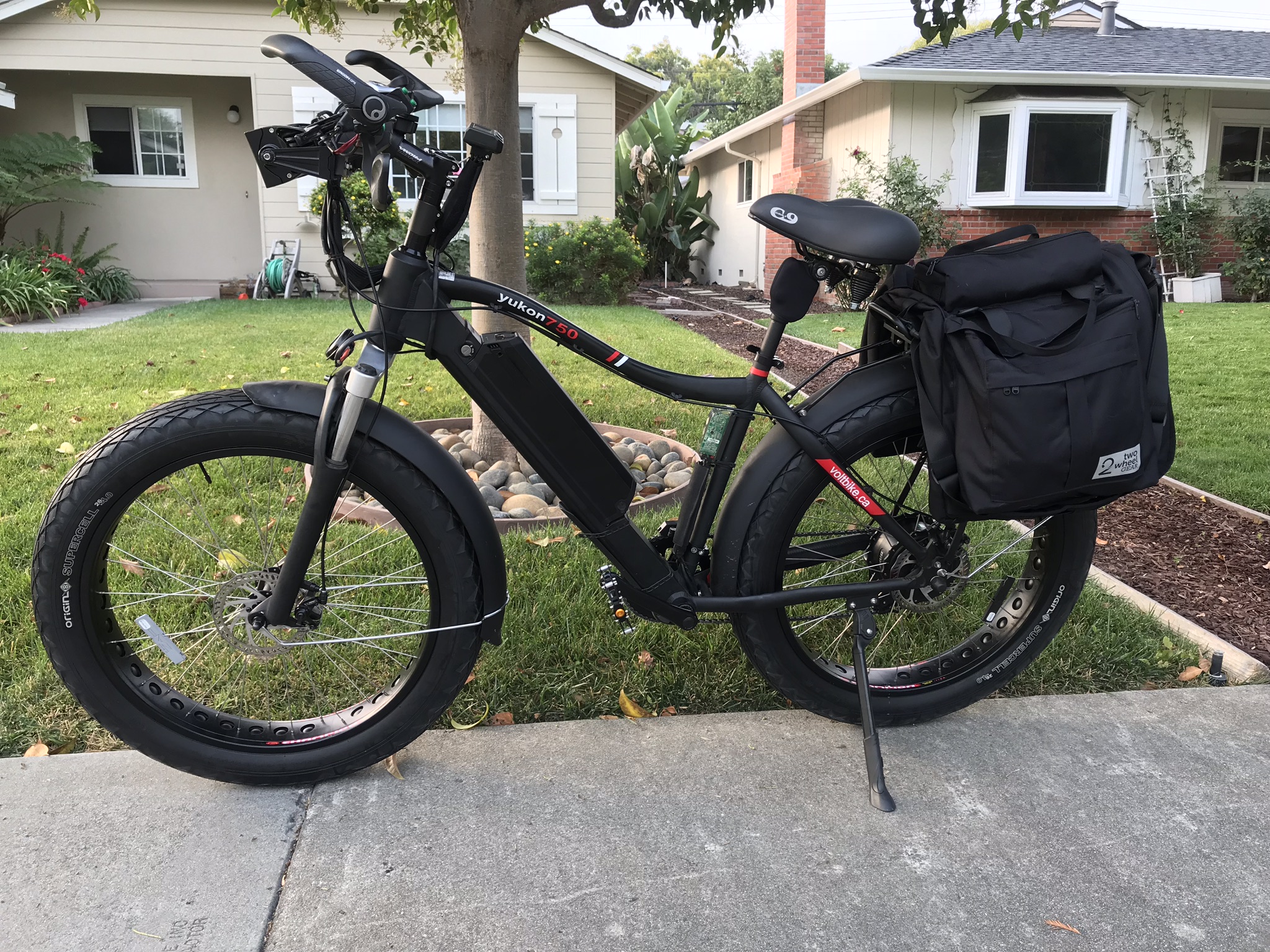

Felt like blogging so I decided to start a thread to see if anyone else has customized their Voltbikes. I have late 2016 model Yukon Limited and made some (what I consider) upgrades. Check them out below and feel free to post your own!

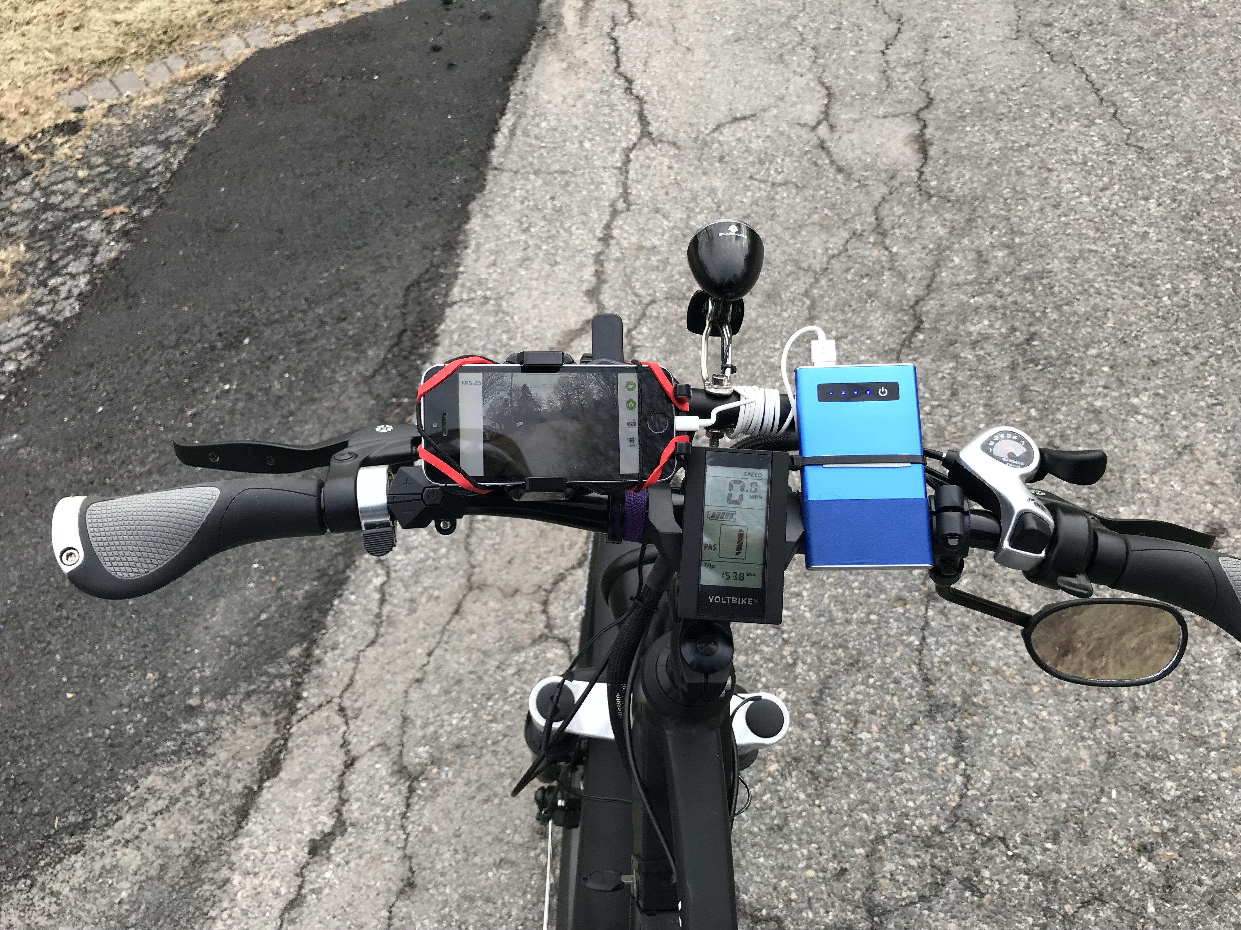

Here are some pics! Some of my mods are replaced APT LCD display with Cycle Analyst (CA3-DP), replaced stock controller with Phaserunner by Grin Technologies (Dimensions 99mm x 40mm x 34mm), DNP 7spd 11-30 Freewheel (11T helps with the higher speeds I can go now), potentiometer (assigned to control overall power level), digital aux 2 button input (I have it assigned to control PAS levels), Momentary On/Off Switch by PerfecTech, Lifeproof Bike Handlebar Mount for my iPhone 7+, longer 720mm OUTDAD handlebar, Ergon GP5 grips, EM3EV Power Switch with horn button (switch wired to LED spotlight), 48V Uxcel horn, YITAMOTOR 36W LED spotlight, Classic 2.0 Garment pannier for commuting (https://www.twowheelgear.com/products/commuter-garment-pannier), Suntour SP12-NCX Seat post, Pro-Bikegear slap guard, Venzo side mirrors, Blusmart Wireless rear light and Zefal DT Armor frame guard.

Ha, kind of hard to miss the dents in the front fender @rich c . I didn't feel like going through the hassle of sending them back to Voltbike since they would not fit properly so I was a little rough on them with vice grips :D I like to think it adds some "character" to the bike. I agree that the some of the additions I have made take away from the integrated stock look, but the performance upgrade is worth it (30+mph). When I replace the battery with new modified extended dorado housing that contain a new 2170 battery pack, I plan to integrate the power electronics a lot better to get back to the stock look. Thanks for the feedback!

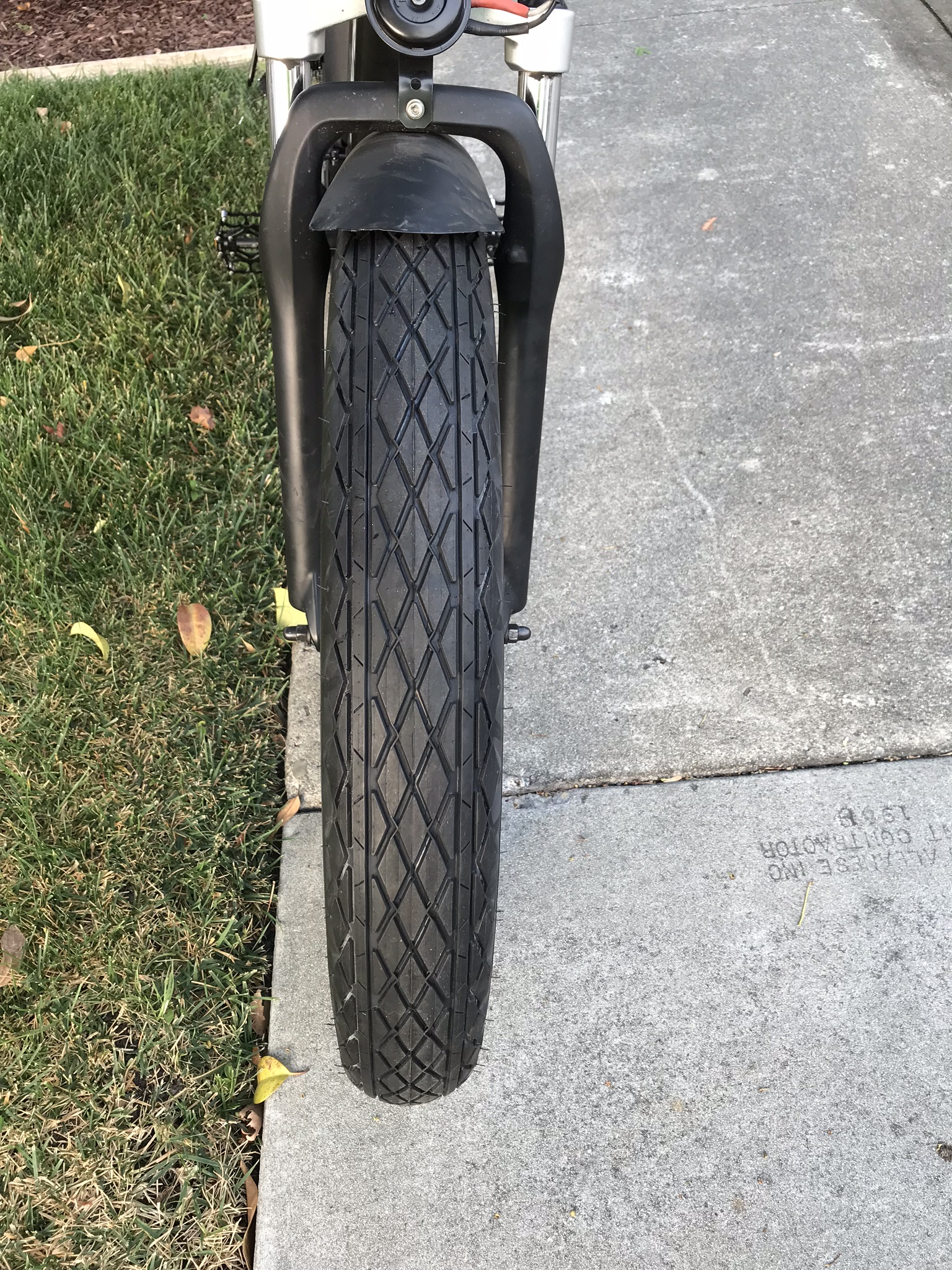

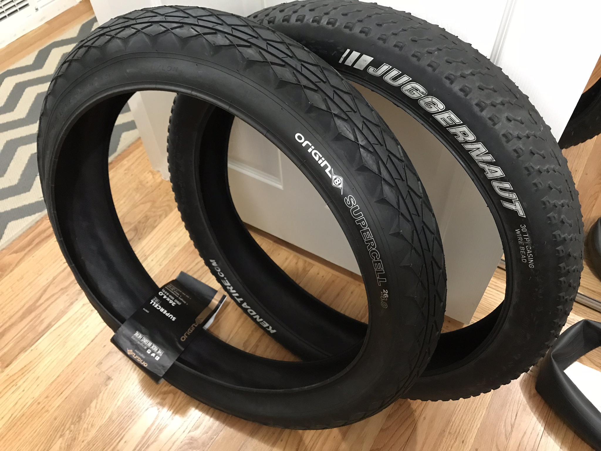

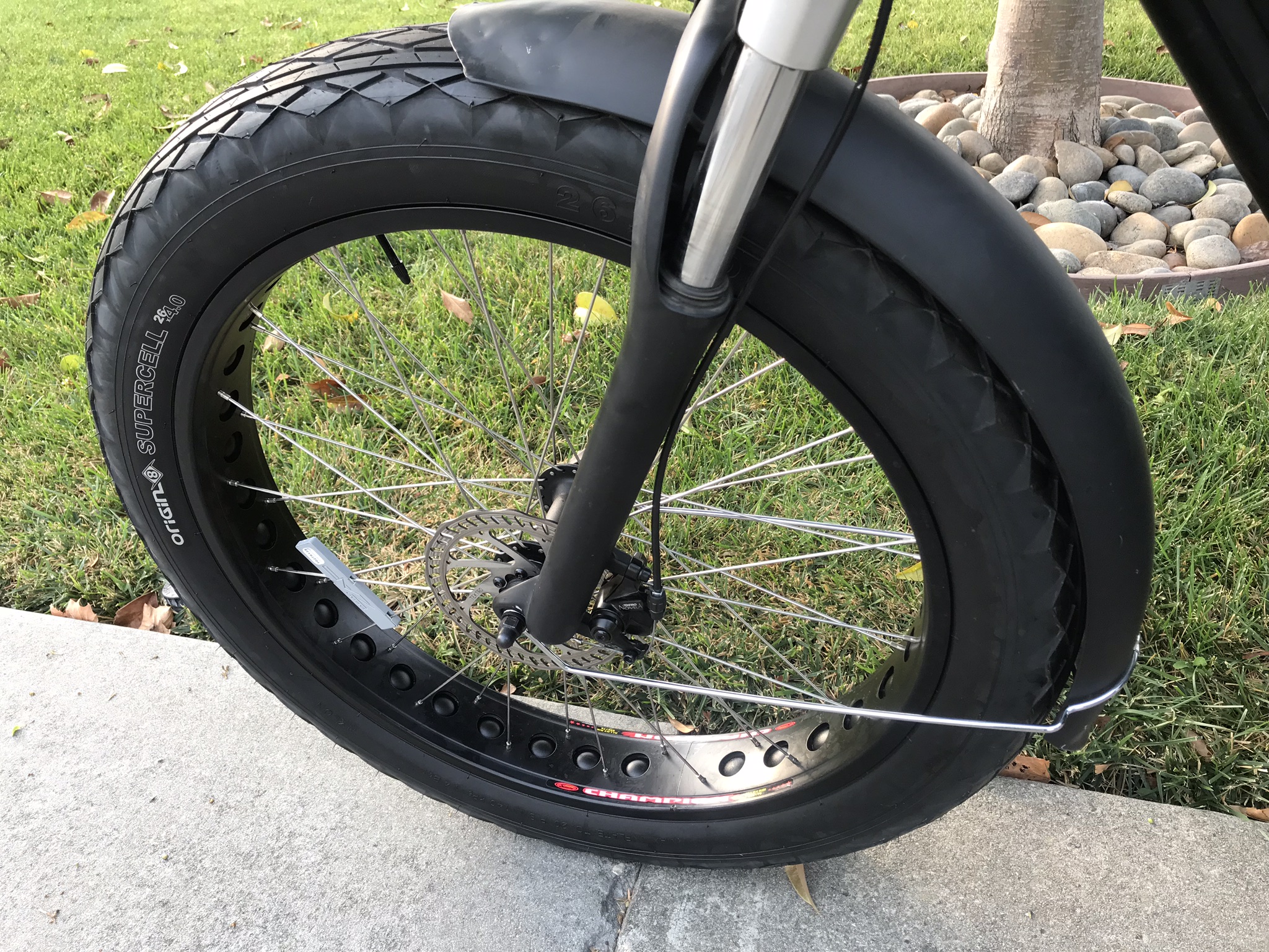

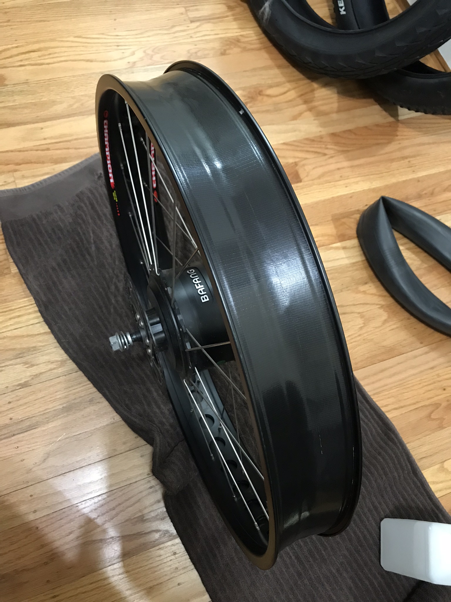

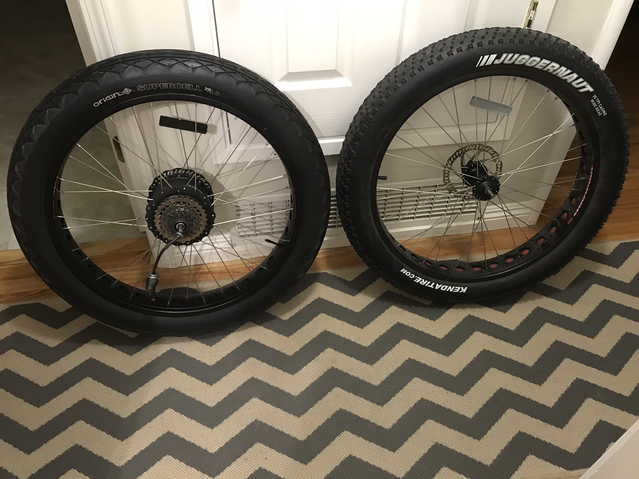

I recently swapped out the nubby stock Juggernauts for Origin8 Supercell tires. Talk about a huge difference! My ride is so much smoother and quite. I also converted the wheels to tubeless and have not looked back. Here are a few pics:
Origin8 next to the stock Kenda's:
Gorilla tape shown applied to wheel for tubeless conversion. I also took the liberty to change the liner from red to black. A lot more stealthy
Origin8 mounted next to stock Kenda's mounted.

Close up on tire tread (I took some frustration out on the front fender during another upgrade).
Side view of front tire tread. View attachment 18715

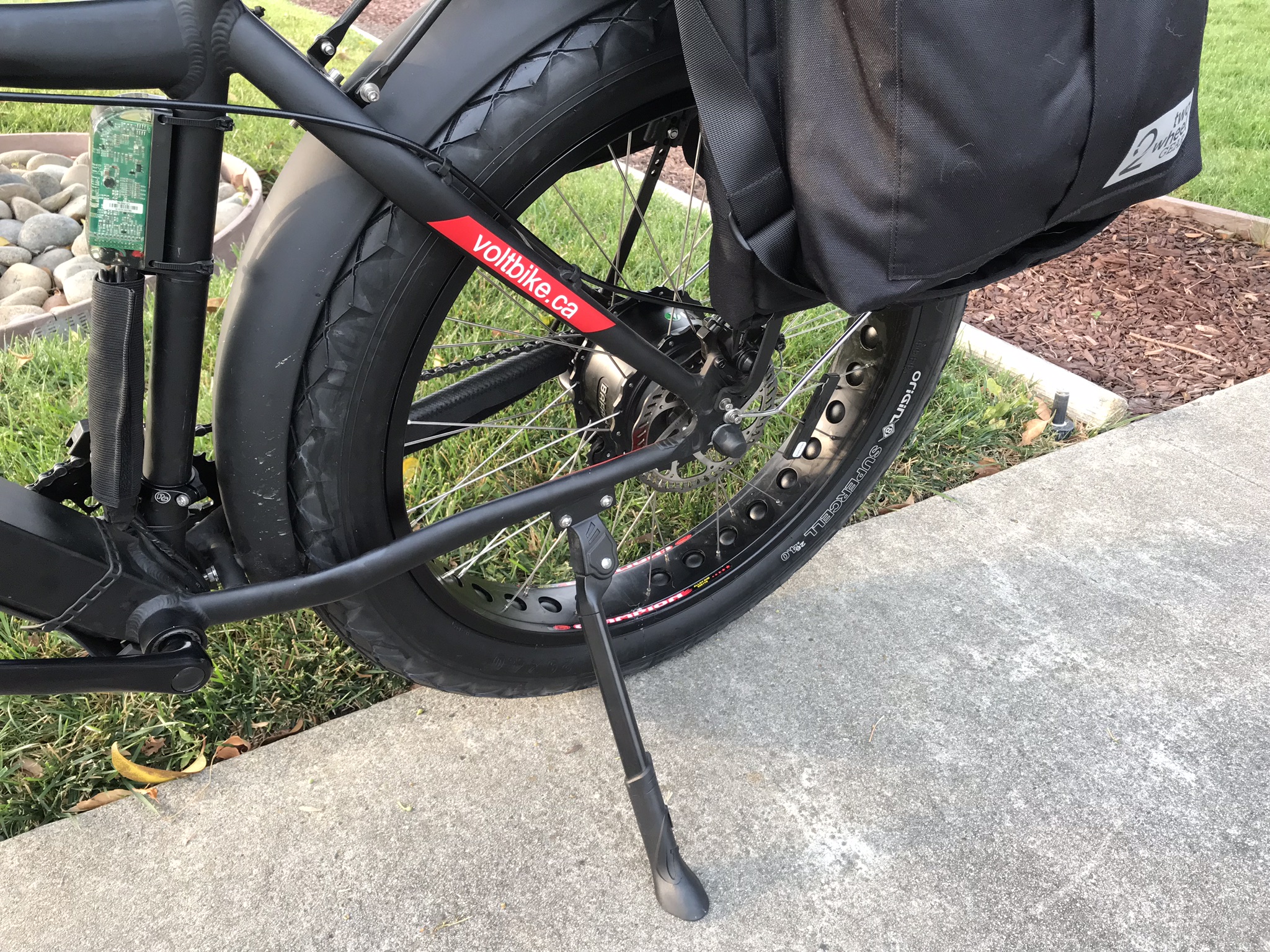

Side view of rear tire. View attachment 18716
