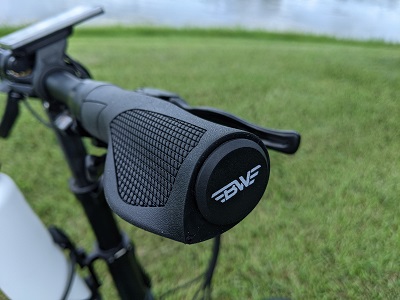

First thing I changed were the grips. The bike came with good quality lockable Velo grips, but I wanted something a bit more comfortable. I looked at a lot of grips, and luckily chose a pair that fit my hands perfectly. BW USA Ergo grips are available on Amazon for $16. They are lockable and made from a rubber like compound made by Kraton. They feel great on your hands, and the palm rest wing actually flexes a bit, like a mini shock absorber for your palms. They are lockable as well.

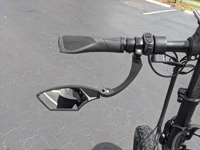

Next I added a mirror. Found this one by Hafny on Amazon for $22. You can mount it above or below the handlebar, I chose below as you actually can see behind you a little
better because your hips are narrower than your shoulders. At least I hope they are. :)

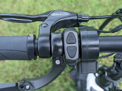

I clamped the mirror to the right of break clamp, and moved the throttle and on/off PA level switch to the right. I also reversed the order of those last two items. From factory the bike
(from left grip in) comes like this grip/brake/throttle/on-off & PA level switch. I changed the order to grip/brake/mirror/on-off PA switch/throttle. I don't use the throttle all that much and this makes it harder to push it by mistake. Ask me how I know. :)

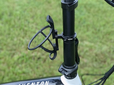

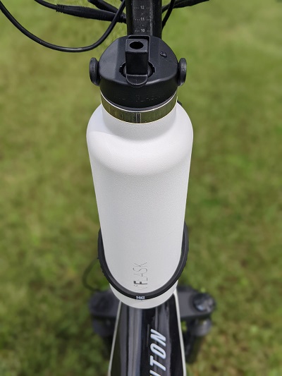

Next I wanted to install a bottle cage for my water bottle. Unless you wanted to start drilling holes in the frame :eek: I saw 3 possible locations where I could mount a clamp style bottle cage bracket. The seatpost, the handlebars, or the head tube. I chose the head tube because seatpost mount is not the easiest to reach (plus I collapse seat when not riding) and water bottles on the handlebars unbalance the bike. The headtube on the Sinch is flared, its bigger where it meets the frame. There is also a lever you use to fold the headtube and handle bars when folding the bike. So I measured the diameter of the headtube just above this lever and it was about 40mm. Most bottle cage bracket clamps are made for smaller tube diameters, but there are some that handle larger tubes. First I tried one by Bikase (large size firs 31mm to 43mm) This one is plastic and when I mounted a bottlecage and full water bottle on it it sagged, not rigid enough. I looked for a metal one and finally found a metal one called DeepRoar water bottle cage on Amazon that handles up to 41mm tubes. Works perfect.
I use stainless steel water bottles cuz they keep things cold longer, so I chose a bottle cage made by Elite called the T Racer that is made from some kind of nylon fibers and won't scratch your stainless bottle. Also looks cool on the Sinch :cool: NOTE: The T Racer cage will not fit a stainless bottle more than 2.8 inchs diameter. My Iron Flask 24oz bottle is 2.8 and it fits perfect. Does not rattle or sway. Get the Straw Lid, you don't have to tilt the bottle or your head to get a drink.

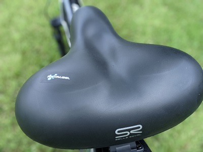

Next was probably the most important, the Saddle. I ride for fun, I don't like pain in my rear end, and if the road bike warriors sneer at me I don't care. 😁
I like Selle Royal saddles, they are made in Italy and are high quality gel seats. They make skinny racing saddles, medium saddles, relaxed saddles etc for every type of riding position.
I found this Selle Royale Journey on Amazon for $44 and it is money well spent.

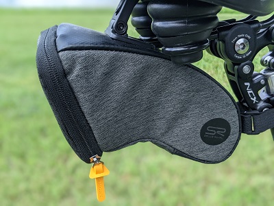

Another cool thing about Selle Royale saddles is they have a clip system in the back which enables installing a saddle bag behind the saddle. I wanted something to hold cell phone, keys, bike tool etc and the medium size is perfect. They also make a small and a large version. $18 at Amazon

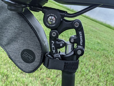

For even more rear end happiness, I decided to get a suspension seat post. About 50% of my rides are on unpaved trails that can get bumpy. SR Suntour NCX is very affordable ($110) and works very well. It has 50MM of travel and you can adjust the firmness. Their standard model comes with a spring that handles rider weights of 140-180 pounds. I weigh 225 so I bought their extra firm spring for $15. This is a really good addition to the Sinch, it really improves the ride. Suntour makes this post in both 350mm and 400mm, same price, if you are taller like me get the 400mm.
