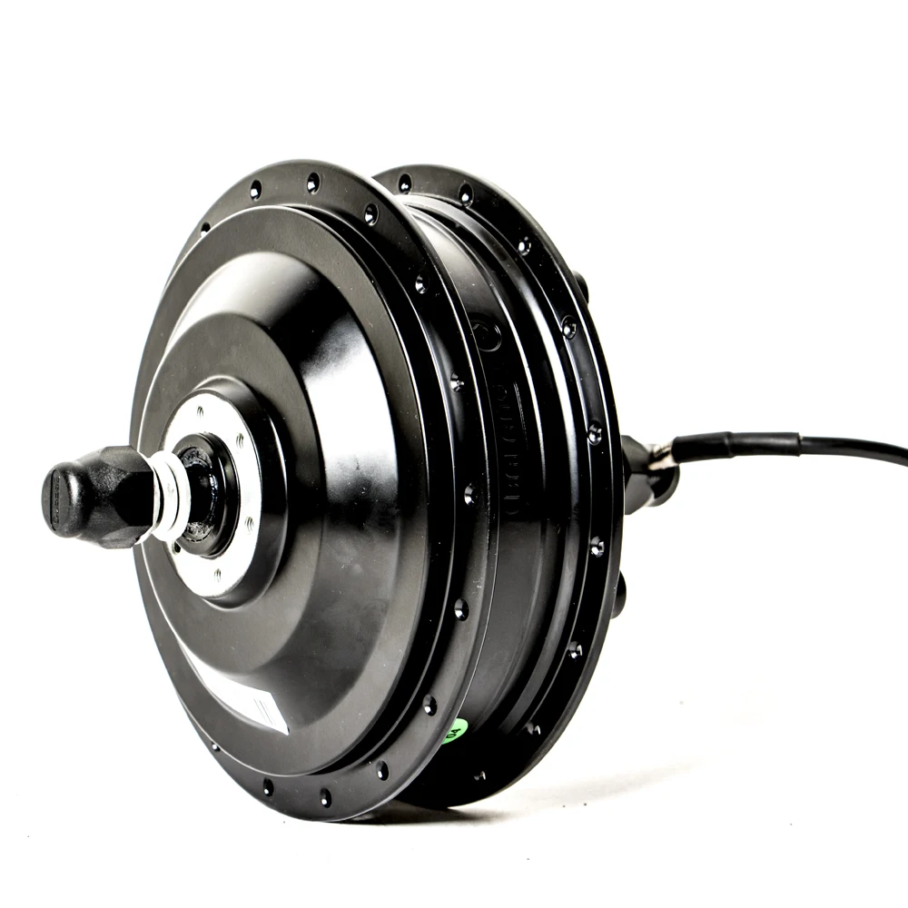

So I have a CrossCurrent Air with CCS controller.
I do not have a budget to spend $ on GMAC + Phaserunner, I'm thinking about simply replacing the motor.
Although it may not happen soon, I just want to start looking around, because when my motor is done, I want to use that excuse to replace the motor.
The stock CrossCurrent motor is Bafang SWX02 motor
It 's rate at 350W, has 45Nm of torque, reduction ratio of 5:1, 180-350rpm.
and I have been wondering simply switching the motor will improve the performance of bike.
Bafang RM G360
It has 12.8:1 reduction ratio.
I had been used on Surface 604 Shred, which is pretty fast bike at 32mph top speed.
However, the Surface 604 has12MOSFET 12A controller, would I see any improvement just by switching the motor?
Bafang RM G04
Sold by Eunorau (and I'm sure it's been sold elsewhere too)
It caught my attention because it has been advertised to 65Nm of torque. Which is a significant improvement.
But Eunorau seems to be a bit inconsistent with the torque rating..
The interesting thing is, the prices seem to differ quite a bit between CSTand BPM. (I'm guessing it means cassette and freewheel?)
eunorau-ebike.com
www.aliexpress.com
Bafang G310
I get the impression that the G310 isn't really a performance oriented motor.
Grin recommends not to use more than 700W max.
I have feeling this is a very entry level motor? Because Grin has GMAC, I don't think they need higher performance Bafang.
www.ebikes.ca
www.ebikes.ca
