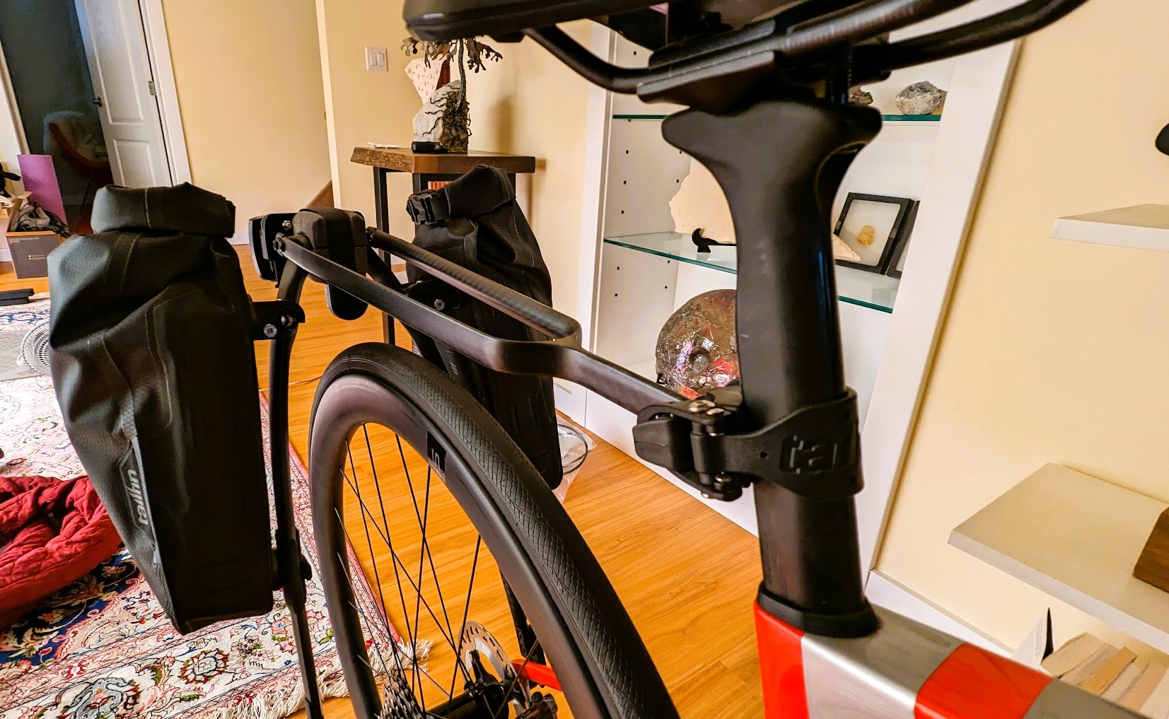

Cargo rack - Tailfin seems like the clear winner, but wow is it pricey! Also looks easier to remove than other racks, which is a big plus. Really dig the aesthetic. Buy once/cry once?

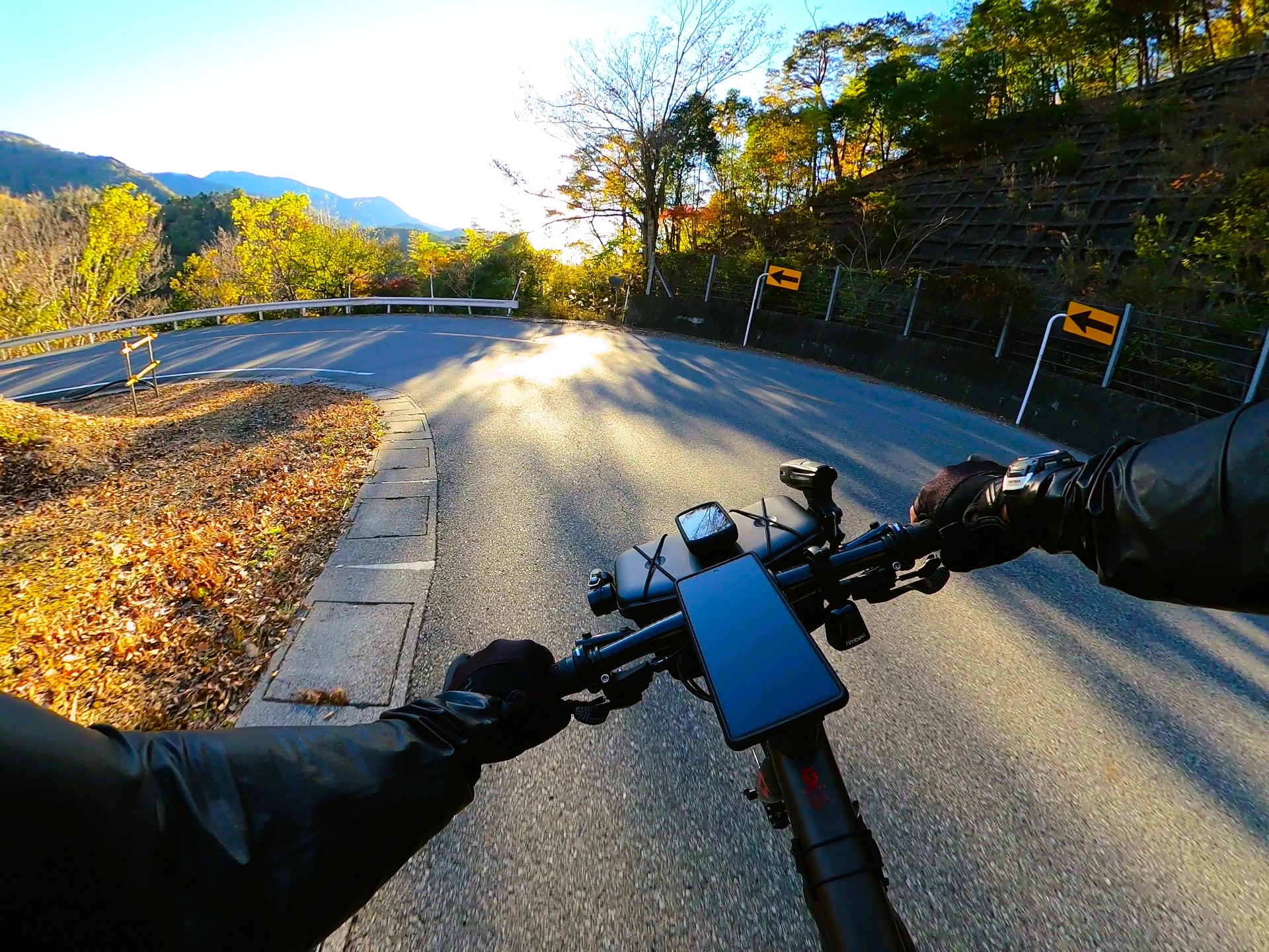

I would say keeping the phone in the rear jersey pocket is safe :) Haven't you thought of installing a bike GPS computer? Especially a Wahoo ELEMNT computer as these are fully compatible with SL e-bikes. Why to install the phone on the bars?
And hey! Do you really intend to install a cargo rack on a carbon e-bike?! Tailfin makes big undersaddle bags, which are appropriate.
Pricey perhaps but worth every cent, IMO. Tailfin’s universal thru axle kit and proprietary QR dropouts could enable you to swap their rack over to a different bike(s) in a matter of seconds all without touching any part of the frame. These 5L mini panniers can be used in a pinch for overnight or multi-day trips if required. We’ll be splitting our ride time with the racks, panniers and a trunkbag on our Creos as well as our manual road bikes.

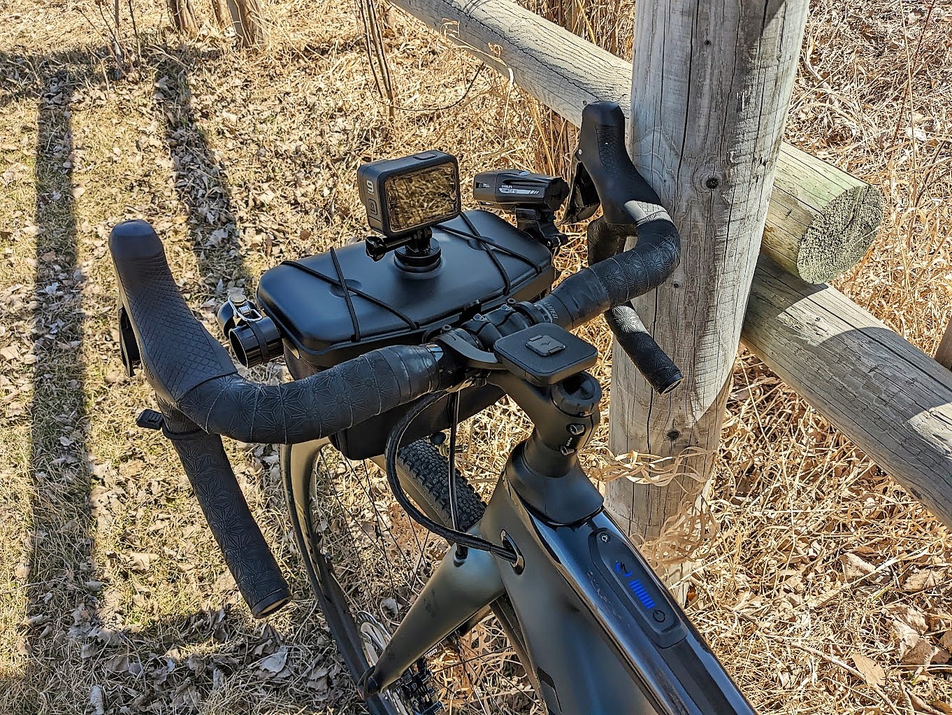

Another thumbs up for Peak Design. On two bikes, including the Creo, I’ve reversed mounted the PD out-front mount to accommodate a 3L Routewerks handlebar bag. Handlebar stubs on either side of the bag can be fitted with accessories solving the problem of a lack of real estate along the bar. A Garmin adapter on the bag’s hard polymer lid allows me to either fit a head unit or a GoPro camera. For quick access, the lid can be opened and closed while on the fly. Tech adapters for Wahoo, Quadlock and Barfly are also available. With a flick of a lever, the bag can be removed in a few seconds from its rock-solid mount and shouldered using an integrated strap hidden inside the bag. Don’t mean to diss the Ortlieb mount but it’s cable system looks cumbersome and appears to sag over time.

Will look into the Wahoo. Seems like a good way to go.
Still weighing the options. We're doing most grocery shopping on bikes these days splitting the load into a few trips throughout the week. My wife has a strong interest in trying some bike camping. Tailfin installs in seconds which leads me to believe I will actually remove it :)
That is a very clever solution! I love how you can easily remove everything and pop it onto a different bike. The photos and writeup are extremely helpful.

What I am afraid of is the weight of the cargo on the rear rack might compromise the structural strength of the frame.
A rather funny story: As you know, I own an aluminium Vado SL, equipped with the factory rear rack of the weight limit of 15 kg. I used to pack even 22 kg gross onto that rack, split into two panniers. And yes, the rack got bent, making the rear fender rub the tyre! :) The rack turned out to be irrepairable so I had to buy a replacement. Now, I load far less onto the rack but instead am riding with a very funny bag on my back. It is a huge, lightweight and cheap supermarket bag made as a backpack :) I load it with several kilogrammes of delicate groceries (like, eggs!) to relieve the load on the rear rack :)
AR, I can recollect a story read on these Forums several years ago. A Forum member started bashing TREK for making "a terribly bad e-bike". As it turned out, the guy bought a carbon road e-bike and converted it into a utility e-bike... Fenders, rack, kickstand, everything. He overloaded the frame and damaged his e-bike in two weeks...
That is why I decided to opt for a rack which doesn’t impact the frame whatsoever. All of the weight is focused on the axle and the seat post. Regardless, I can’t see myself loading up to the max even for an extended trip.
Creo2 is spec'd to 25kg rear cargo + rack capacity. See the Creo 2 Rider Workbook for more details on rack sizing/specifics - including their suggestion of the tubus Vega Classic rack which is rated to 25kg. I keep meaning to try this Bontrager MIK-compatible rack with my Creo E5 sometime since I have a MIK compatible trunk bag.
