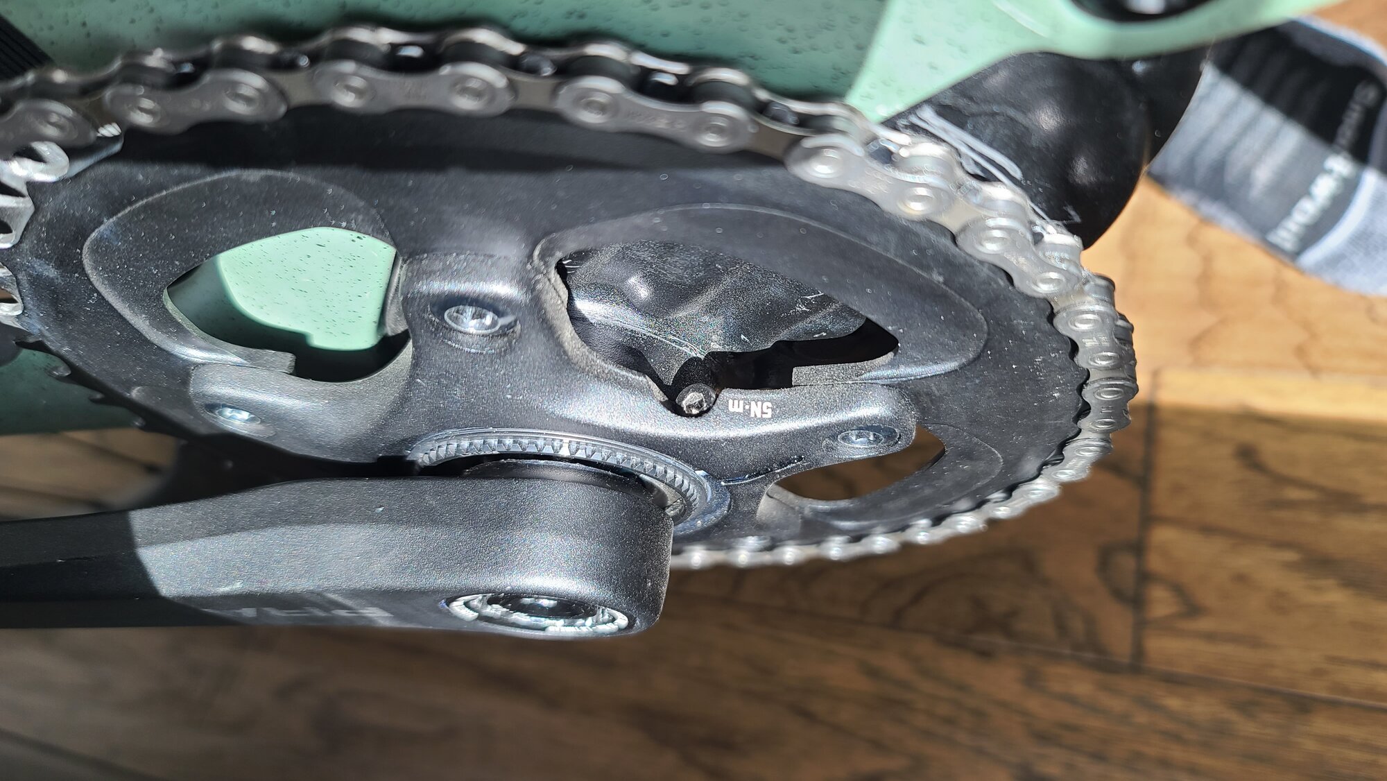

I've seen one other post listing a similar sounding problem that was attributed to a loose screw (accessed through the front chainring spokes) that the poster said tightened a crank spline. I checked that screw (a Torx) and found it tight.

Mine was the chainring being loose on the crank spline. Tighten up the pinch bolt.

FYI, even though my pinch bolt was tight, grabing both sides of the chainring with my hands I was able to wiggle it back and forth.
