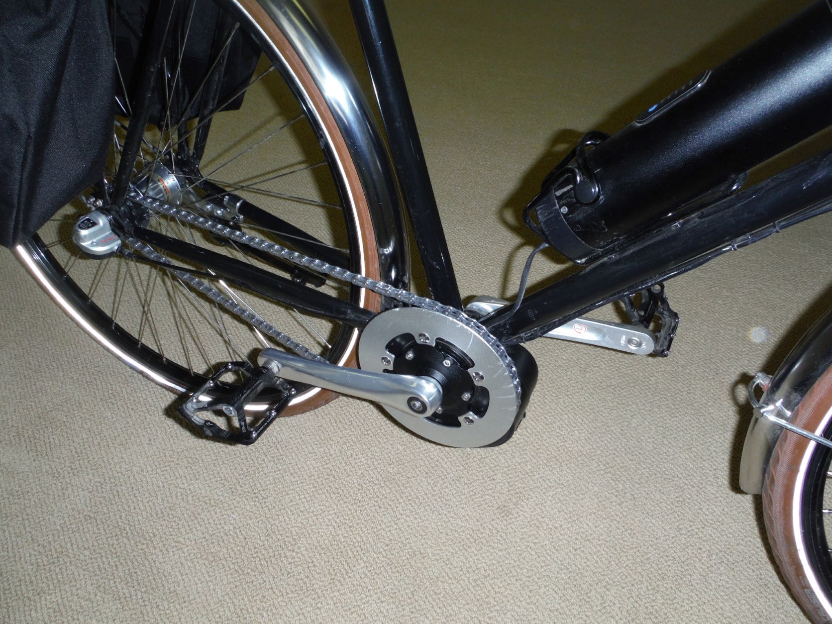

A screw of a motor's cover plate had backed out, causing a click each time the quick-link passed. It was totally hidden behind the chainring. It was a good opportunity to do a tire rotation when installing the new heavy duty e-chain. It is a KMC Z1eHX Wide. It lasts like a belt at a fraction of the cost.
