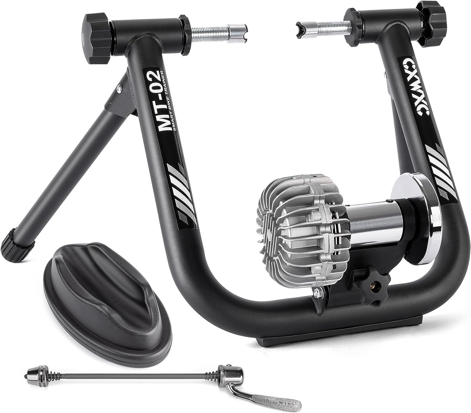

This wouldn't work for your bike? I've had a similar trainer for many years, it is very stable. QR axle isn't required but I'm not sure if it would work on a hub motor with the cable exiting from the end of the axle though (haven't tried). They can be very loud. A dedicated exercise bike is better IMO.
I used something very similar to what @EMGX showed above. But mine was an old trainer stand in the garage that I hadn't used for many years. I took my old road bike and set it up in front of the TV, and now I try and use it at least some of the time I am wasting exercise time in front of the screen.
A trainer like this won't work with a motor whose cable exits straight out of the axle.
The difficulties of doing this with a 20" bike have already been well gone over above. You would be far better off with an inexpensive analog bike that you connect to a stationary trainer. Far better off means you will be able to have something to ride indoors vs. nothing, which I am afraid is where this is going if you try and re-use the Lectric.
