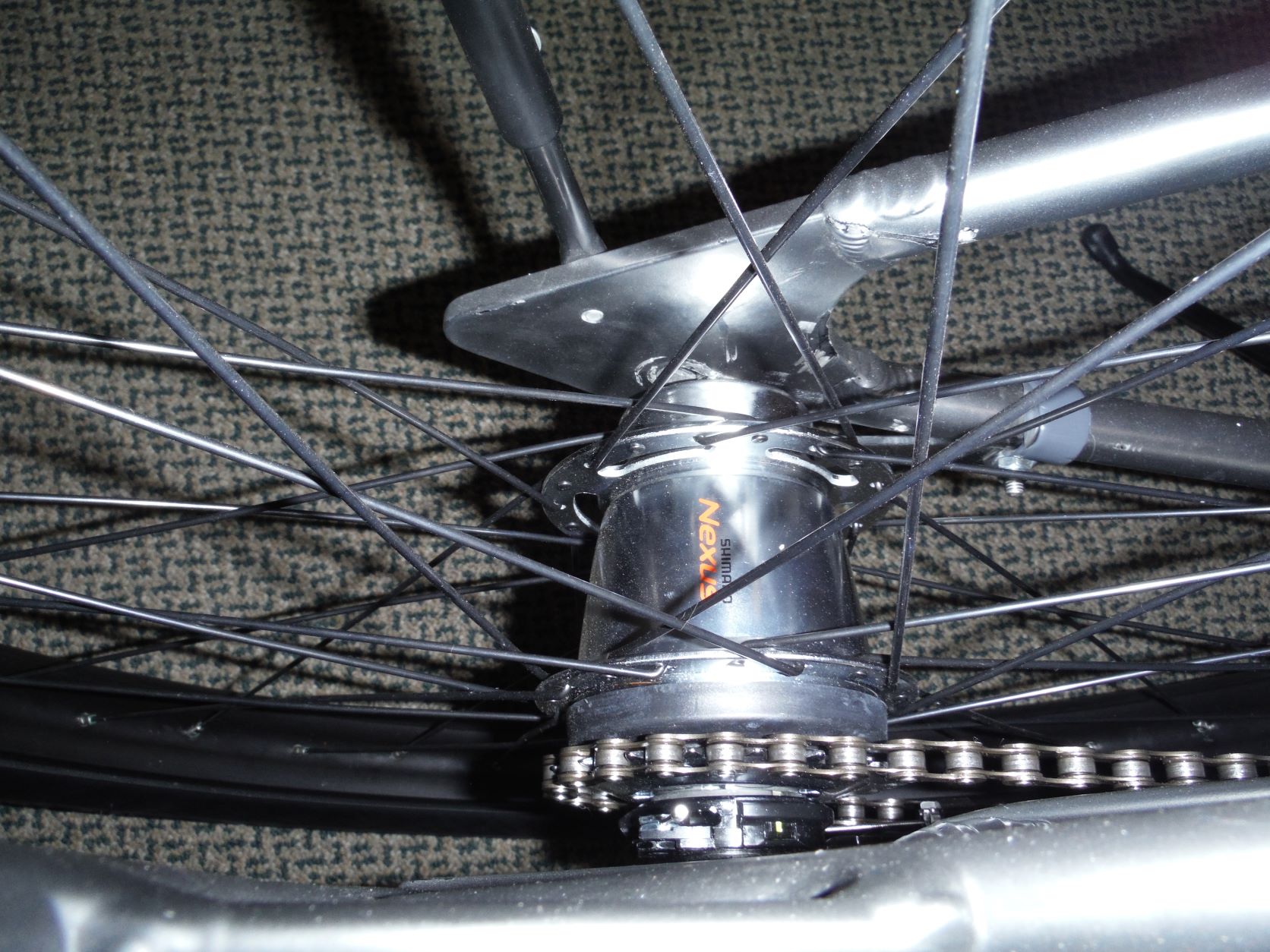

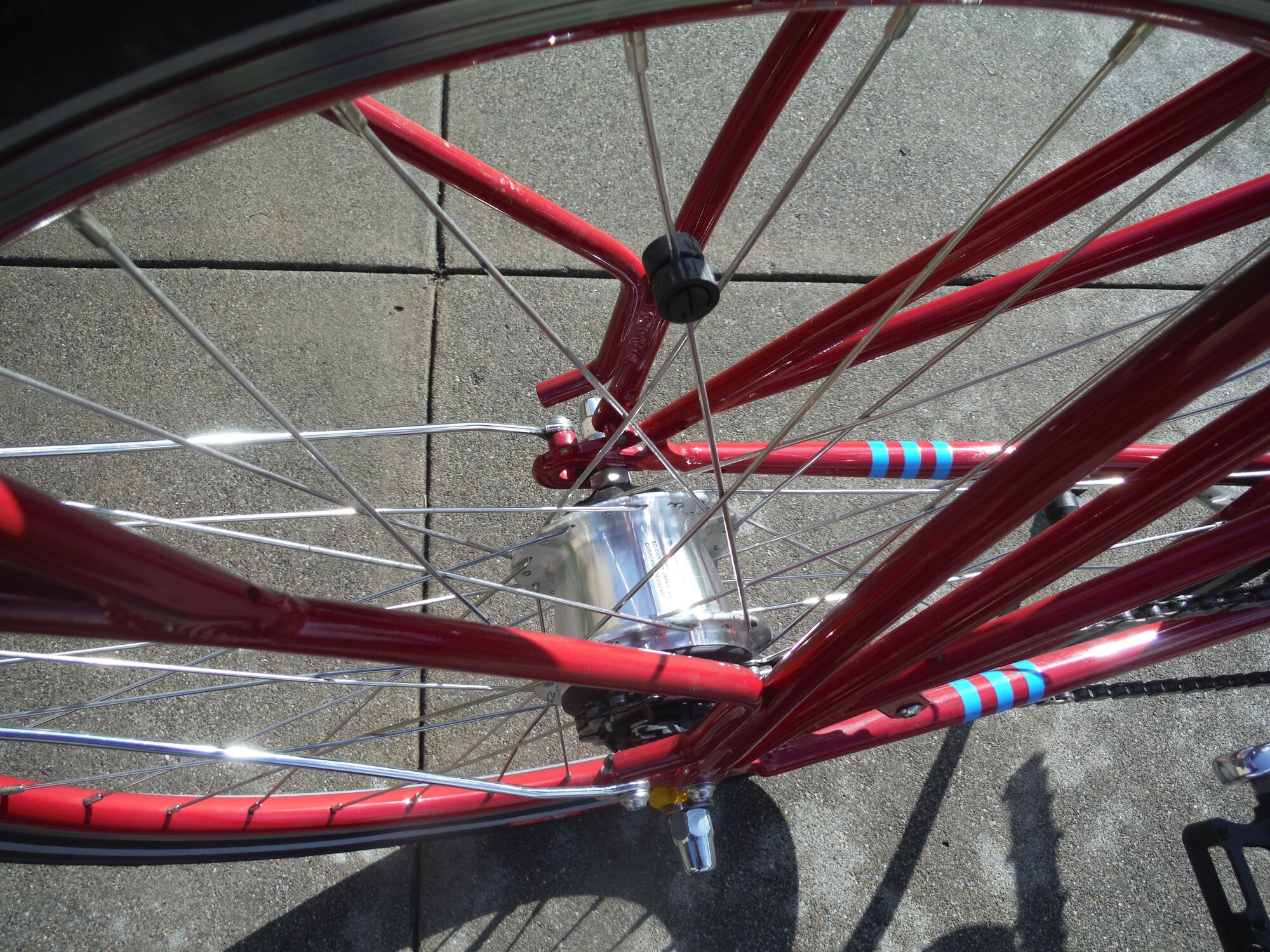

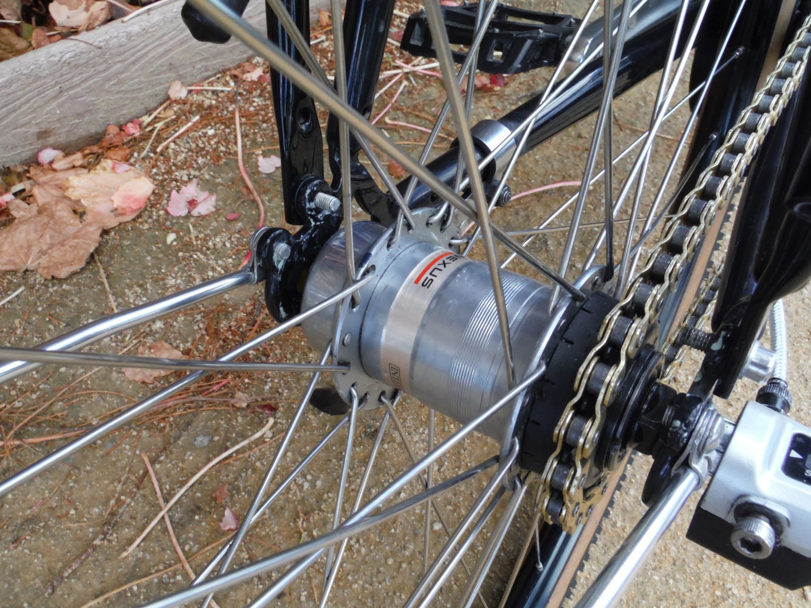

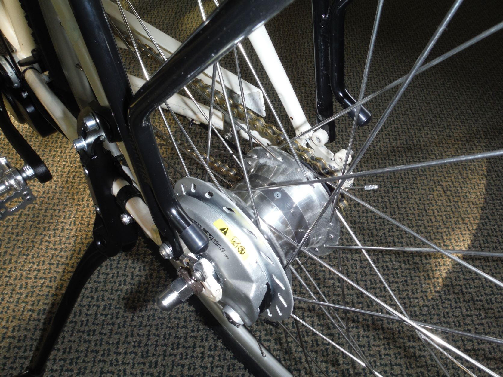

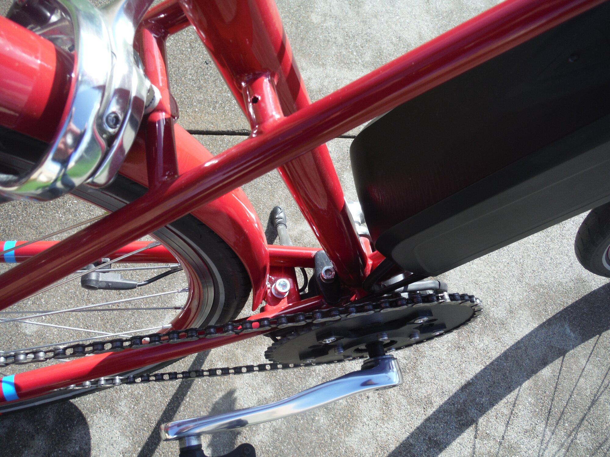

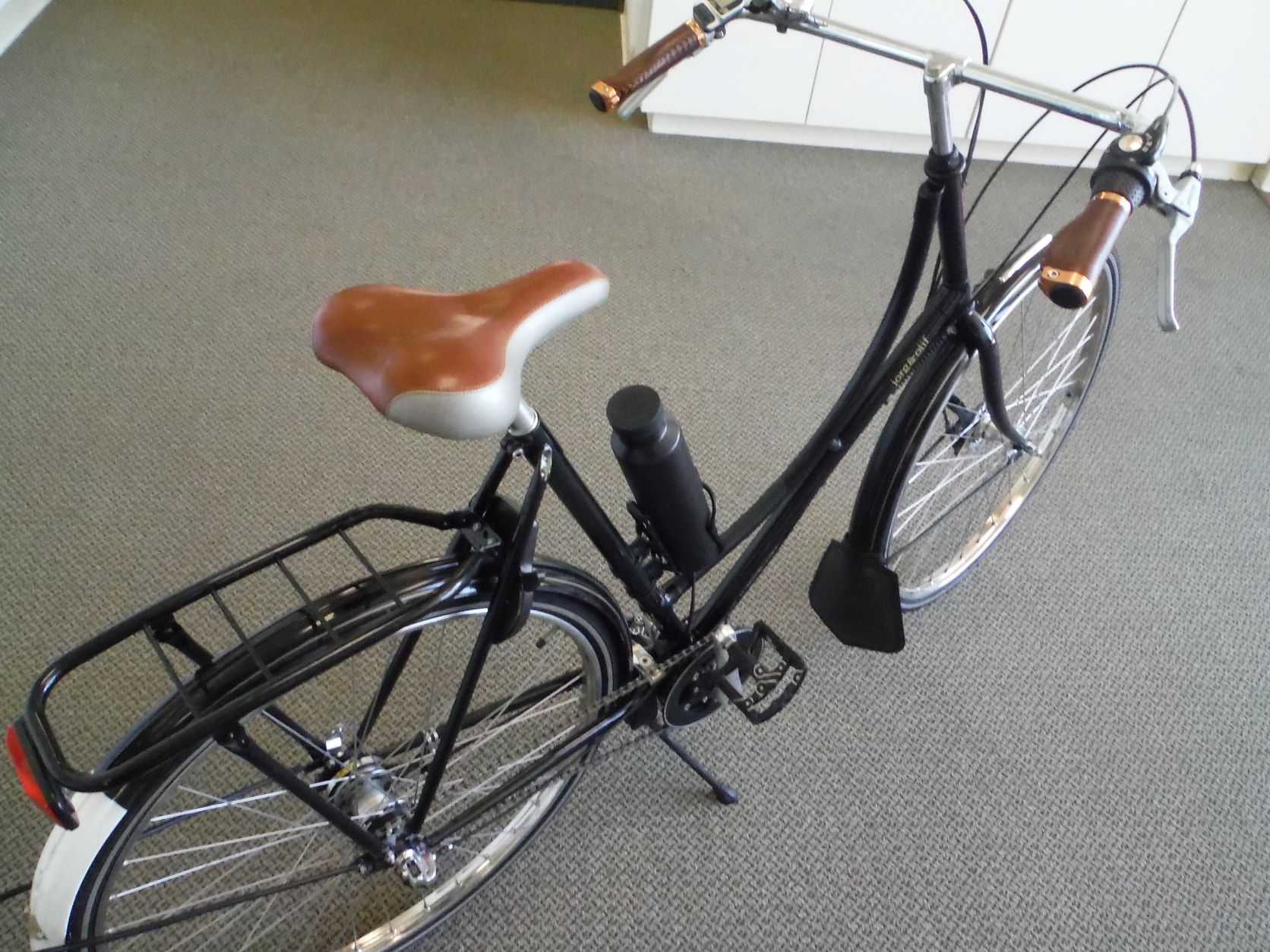

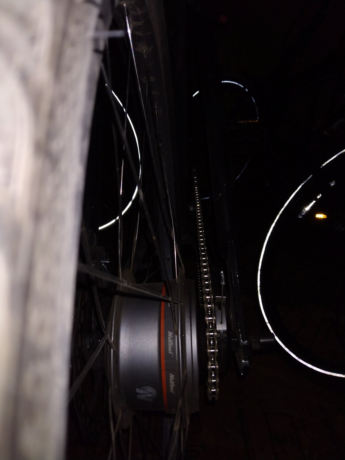

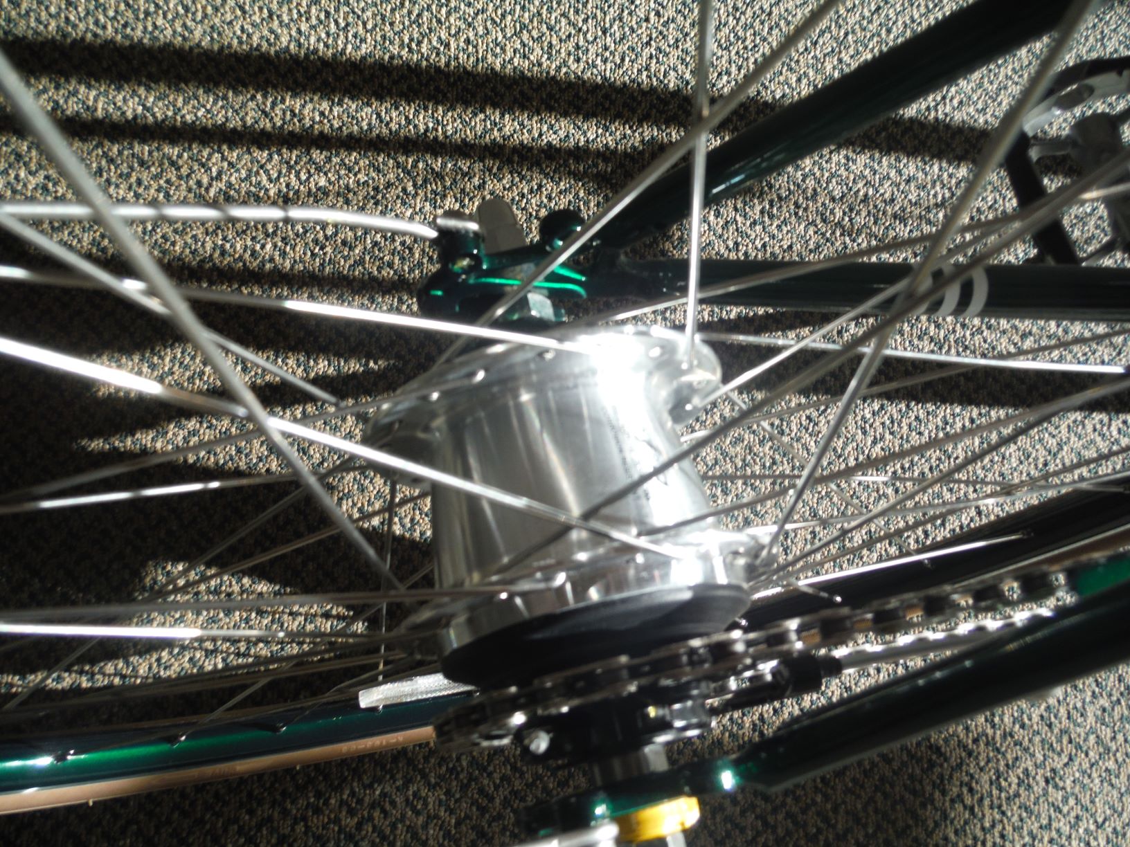

Here are some TSDZ2 IGH chainlines. Oh, when selecting a motor, know the seller's reputation. Do you have to ship a dud motor to Outer Mongolia for $500 in shipping? Is there any support? How much is the total cost after all fees? Also here is how that latest Vida build turned out.

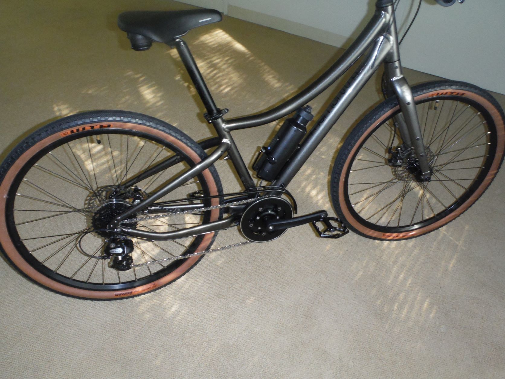

I am awaiting the new curved back HB and that Vida is ready to fly. The controller is set a 16Amps. Speed at a 45Kph limit. Wheel size, 5 inches in diameter. No speed sensor wire. That is chopped for immediacy of feel. The lines of this bike are by far to sexy.
