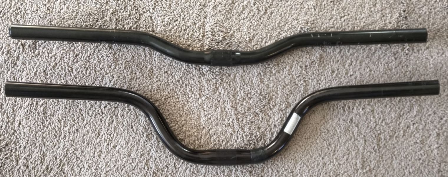

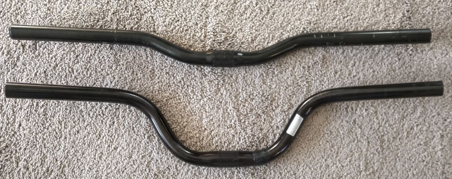

I agree with what Joe and Roy said. The top black bar is the bar that came standard on two of my bikes, and it is a disaster. From that bar I went to the lower black bar. It helped, higher and a little closer, but it was too flat. My last bar is the one in silver. It rises 3 inches but your hands are in more of a 'handshake' position. The bike in my member picture is a fake Townie. The rise here is maybe too much, and it starts to hurt my back a little. You can definitely experiment. Good grips can help, and padding on gloves. You might want to spend some time doing research on things like seat suspensions and front suspension forks.

View attachment 5912 View attachment 5913
