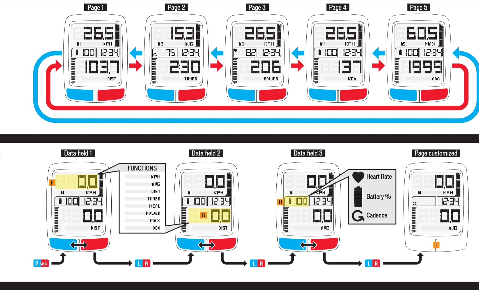

Assuming you have the TCD the ODO function is there, the data field is kinda odd, it says "odo" and below shows your total mileage.
These should be the default screens when you scroll through with the front button on the handlebar remote.
My apologies! Instead of relying on my failing memory I should have looked it up...😕
The TCD-W display has 8 parameters that can be selected for 2 screen positions. An odometer (odo) is one of these parameters. Just confirmed it on my Vado. There are also 5 screens that can be setup and selected with the left or right display button.
My preferred display has speed and trip distance selected. I could have the odometer on a 2nd screen and switch back and forth.
