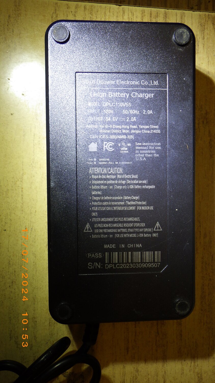

@Urbancowboy do you have any pictures of the charger marking label or to link to it for sale online? Is it safety certified?
And how about your e-bike is it safety certified as well?
Please note poor components and materials within a battery charger, e-bike electrical system, battery pack, etc. can cause electric shock, explosion, or fire field event. Having safety certified products and systems reduces this risk substantially. That's why every refrigerator, washing machine, water heater, and other products in your home have safety certification. e-Bikes and their chargers should not be the exception especially when one could argue they pose substantially more fire/explosion risk.

Attached a Pic of the Back of one of the Chargers. My Bike came with 2 Batteries and 2 Chargers and yes I charge each Batterie individually, they are not allowed communicating with each order while charging.

I can confirm the battery charger is UL Solutions certified and certification record can be found here: https://iq.ulprospector.com/en/profile?e=4787040 (if you are logged into the free system this link will work) or here https://productiq.ulprospector.com/en/profile/4787040/qqjq.e518934 (no login abridged version).
If you feel it's getting to the point of burning the skin, please send a UL Market Survellience request and we will investigate asap: https://market-surveillance.ul.com/.
Please note, a certified charger does not mean the full e-bike system is certified, please ensure to only buy e-Bikes that are safety certified. If you have any pictures or links to the e-bike I would be happy to check into that.

Thank you very much for your information.
My eBike is a Fucare Gemini X purchased new 2024 via Amazon and came with the 2 Chargers I am using. My Avatar shows my eBike.
