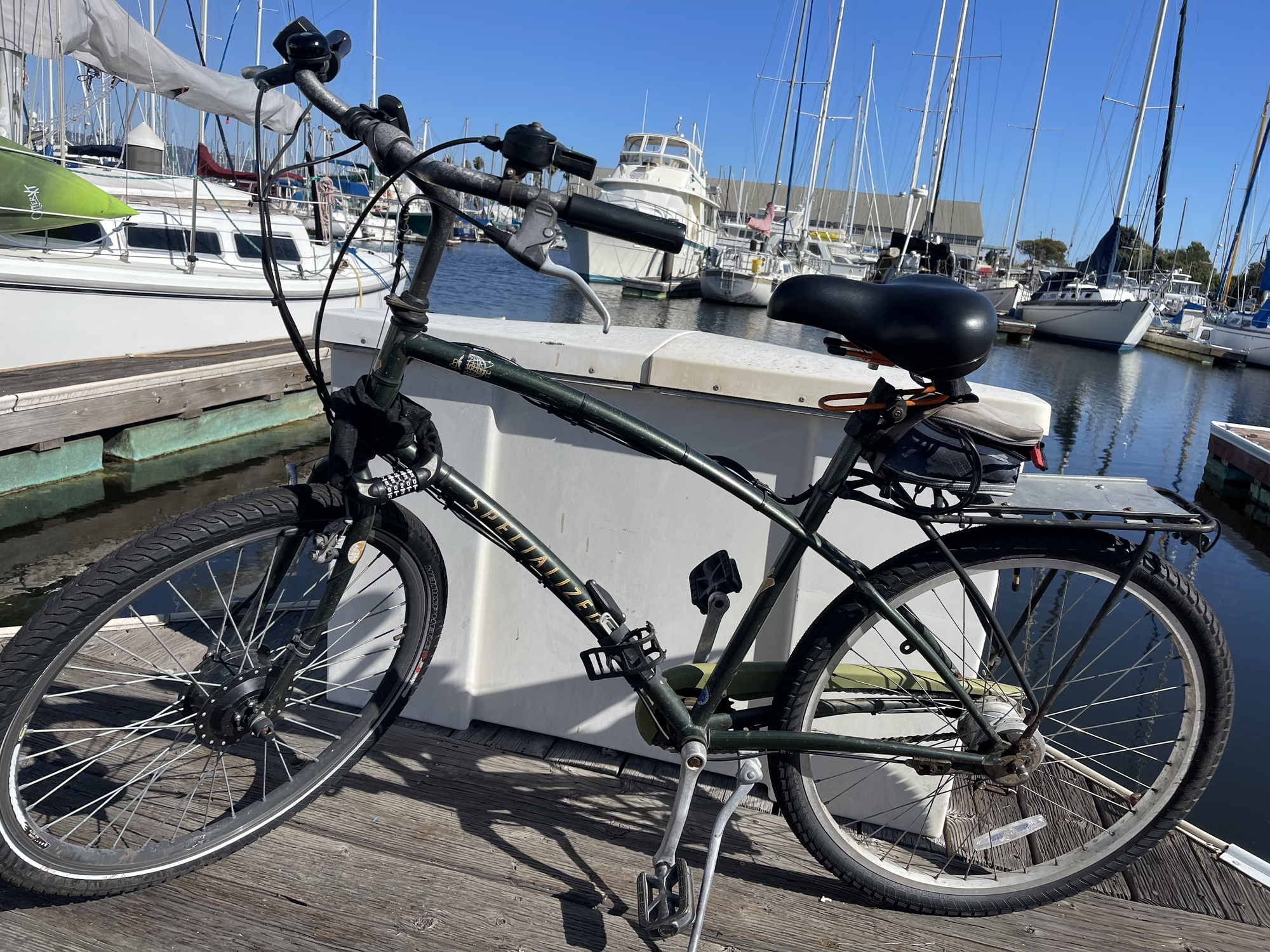

My first electric bike is a Specialized used bike that has an add-on front motor and simple throttle. It is still running and has a considerable range. It is not an aluminum ultralight but I basically like the bike and it convinced me that everything I suspected about ebikes was true!

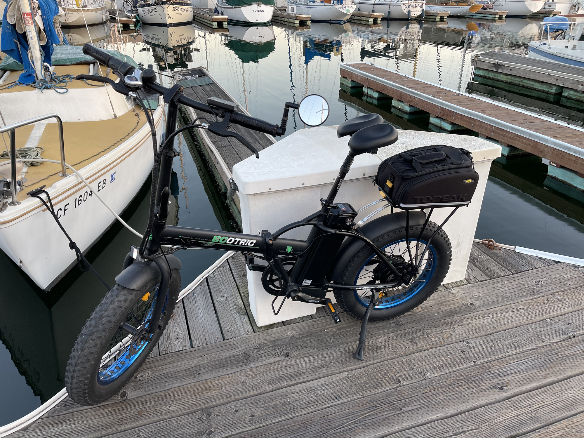

So next, I bought a "real" ebike - a used Ecotric in Like New condition and it has been excellent as well - all things considered.

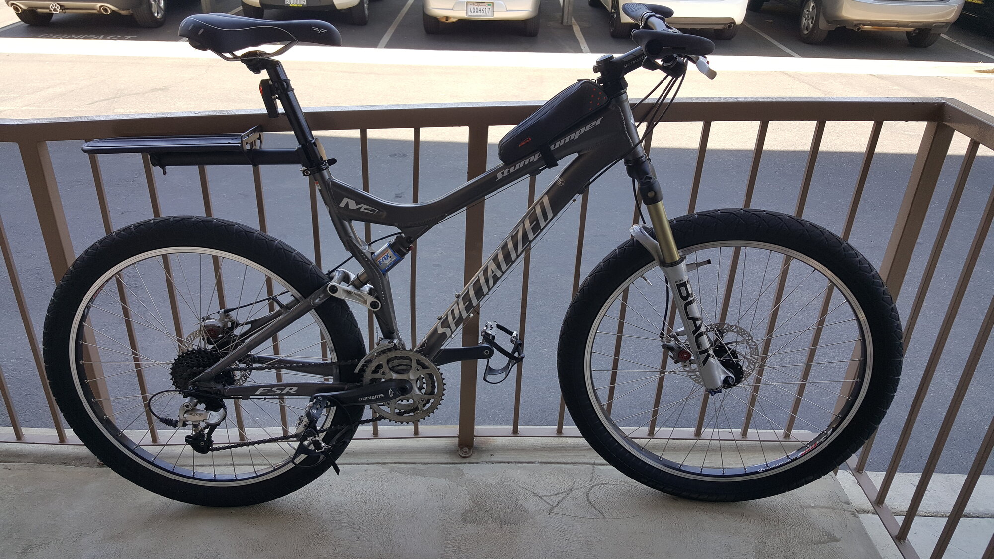

Specifically for myself, I am looking at something like a Specialized Stumpjumper full suspension Aluminum Alloy bike - they can be found in very good condition used for less than $1,000, and can easily handle my 200 pounds. I am familiar with front, mid, and rear motors and I am leaning toward a rear hub motor (though I have had no problem with the front hub bike I own).

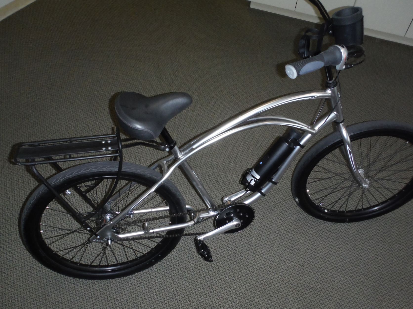

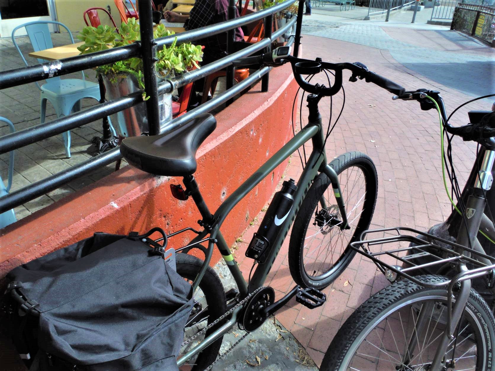

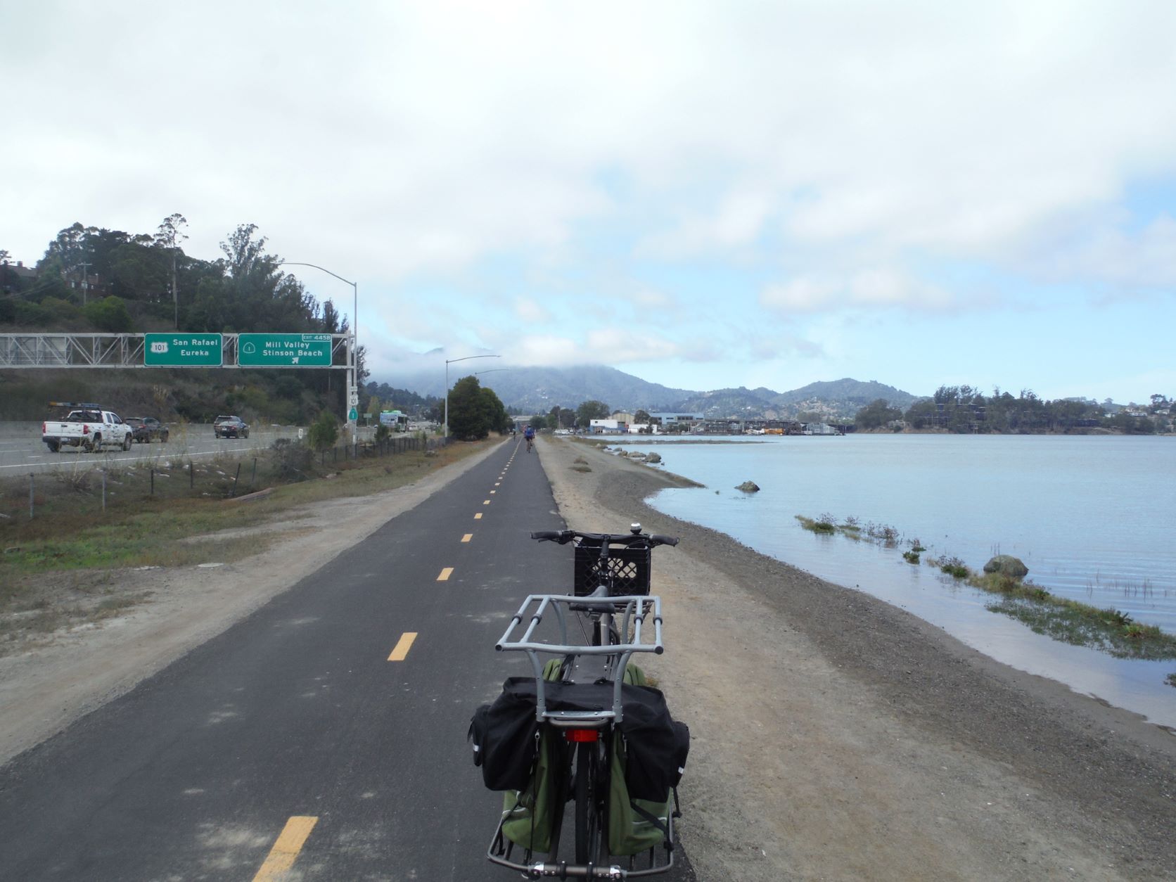

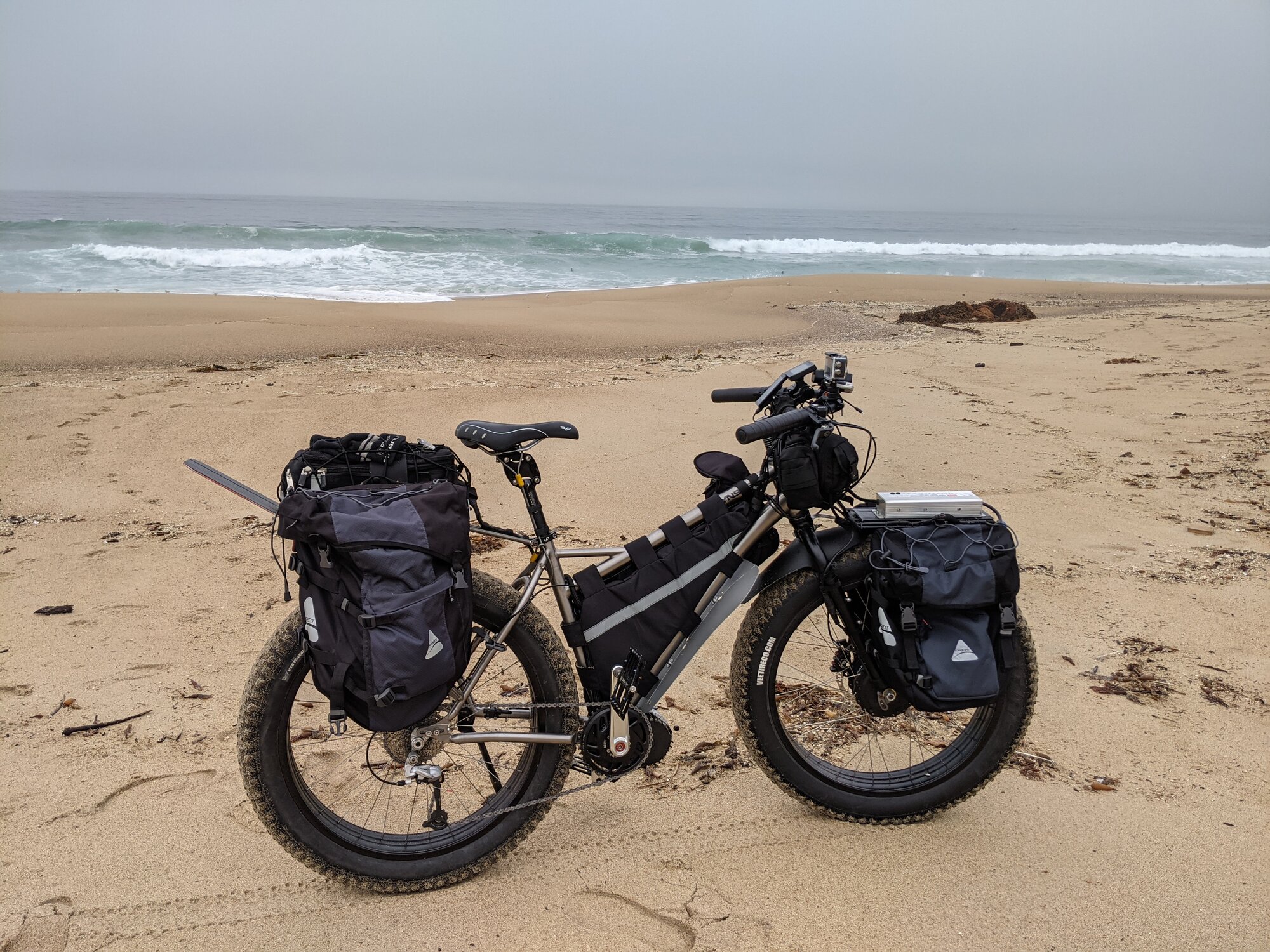

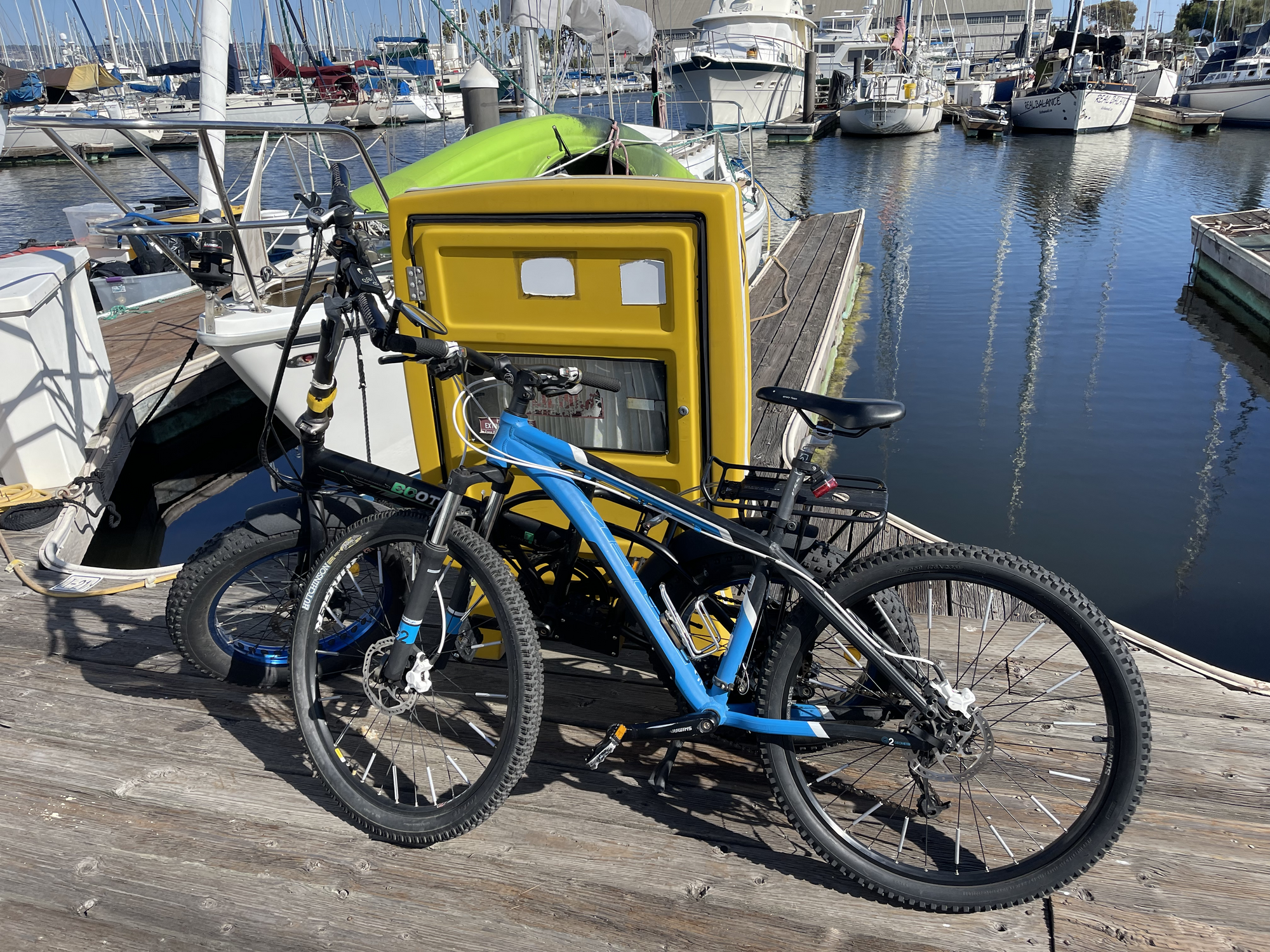

I love crank forward frames with BBSxx series motors. In my support days we sold scores of kits to San Francisco residents. Quite a few to a fellow that rents bikes and does tours there. Kitted Electra bikes are super comfy. No hand or arm pressure. Total upright view of traffic. TSDZ2 is another option. But BBSHD can do ANY hill there.

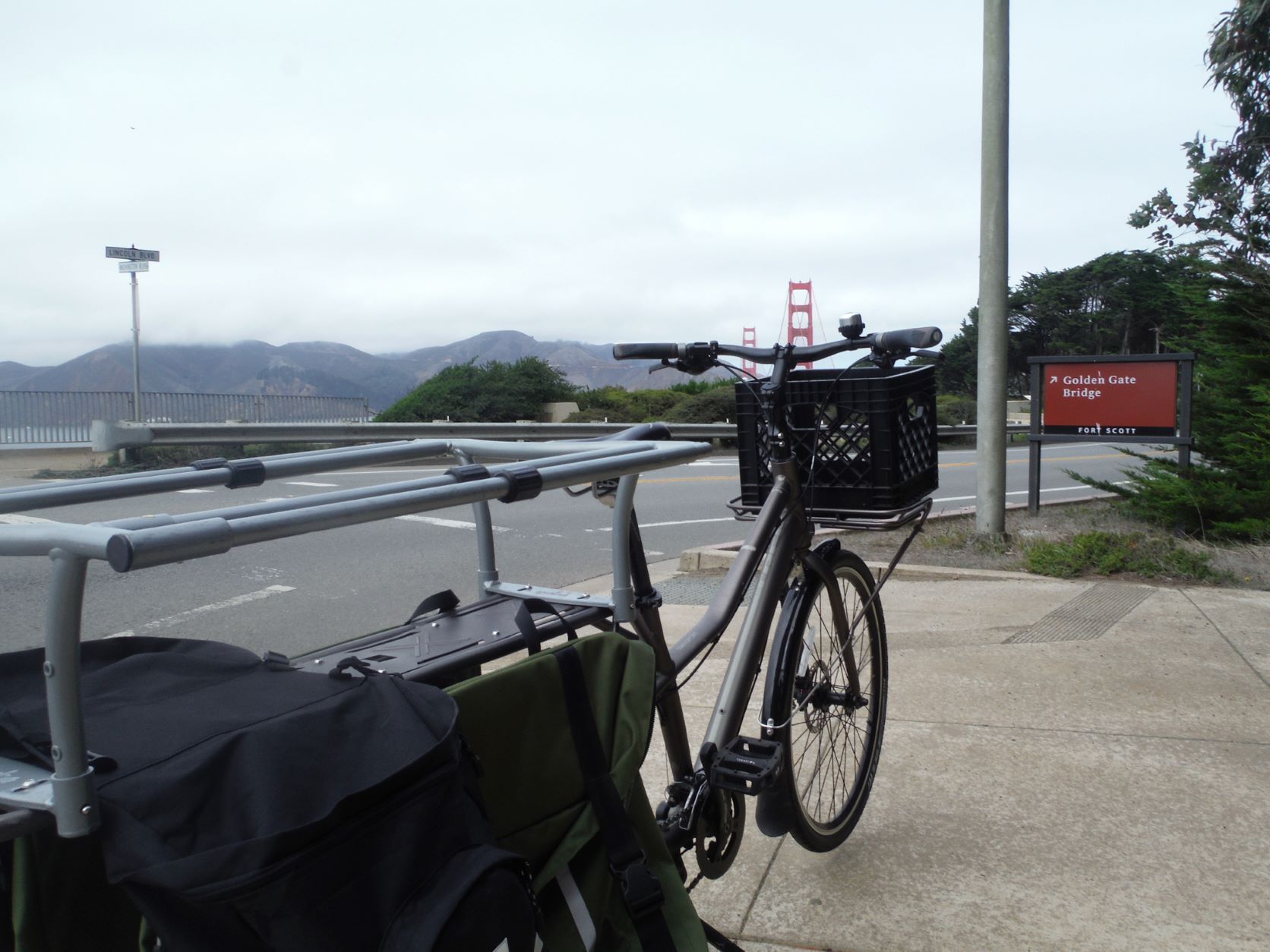

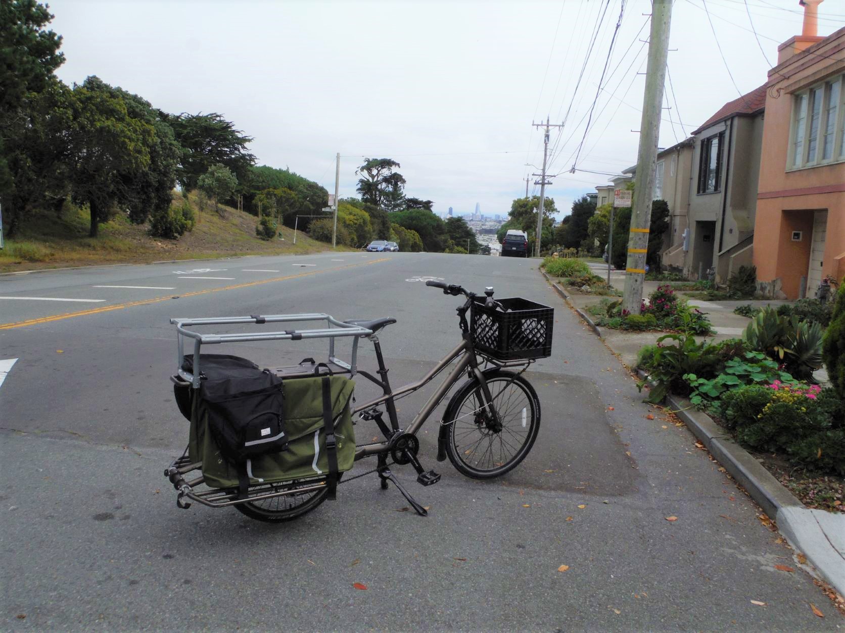

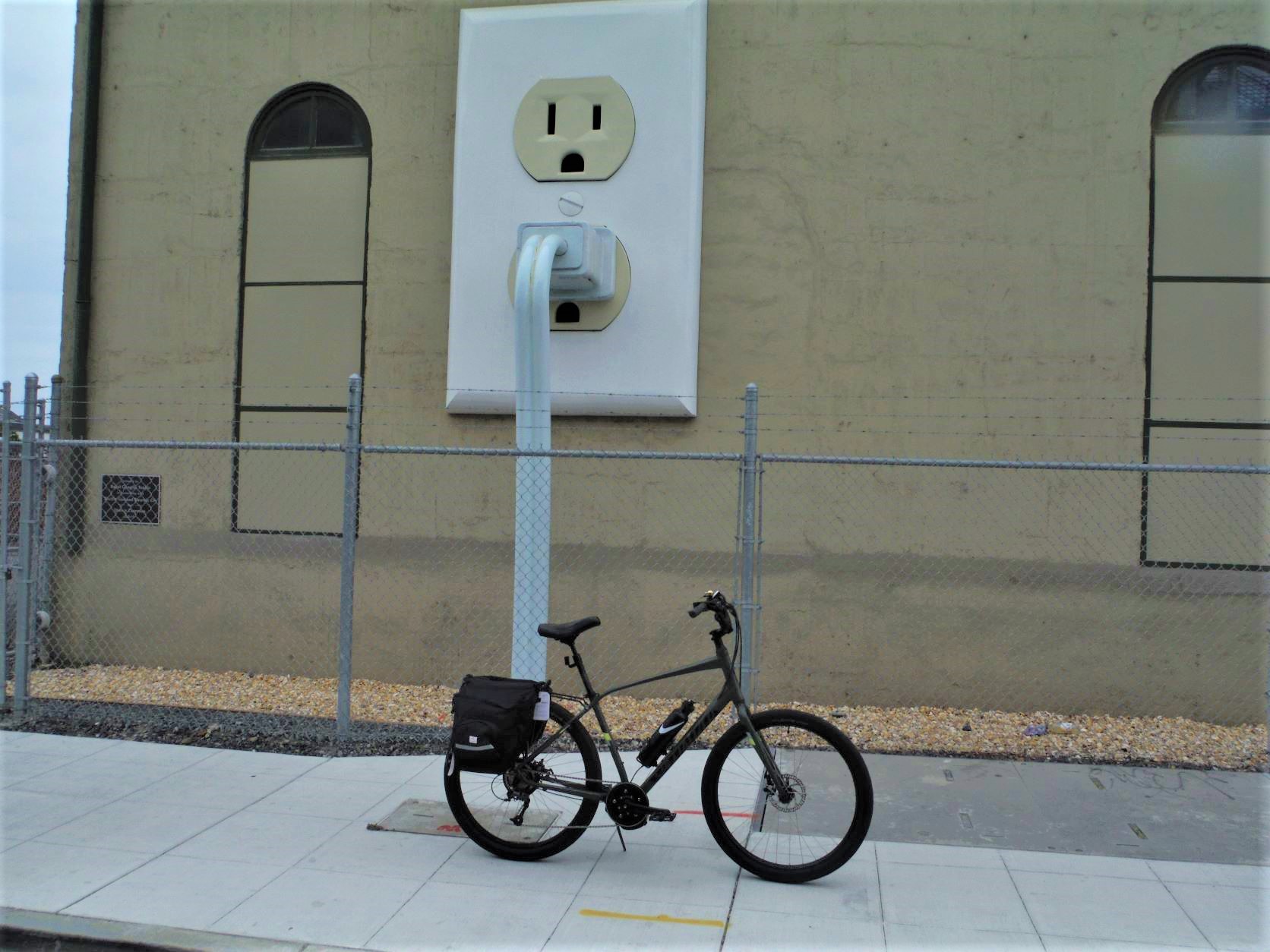

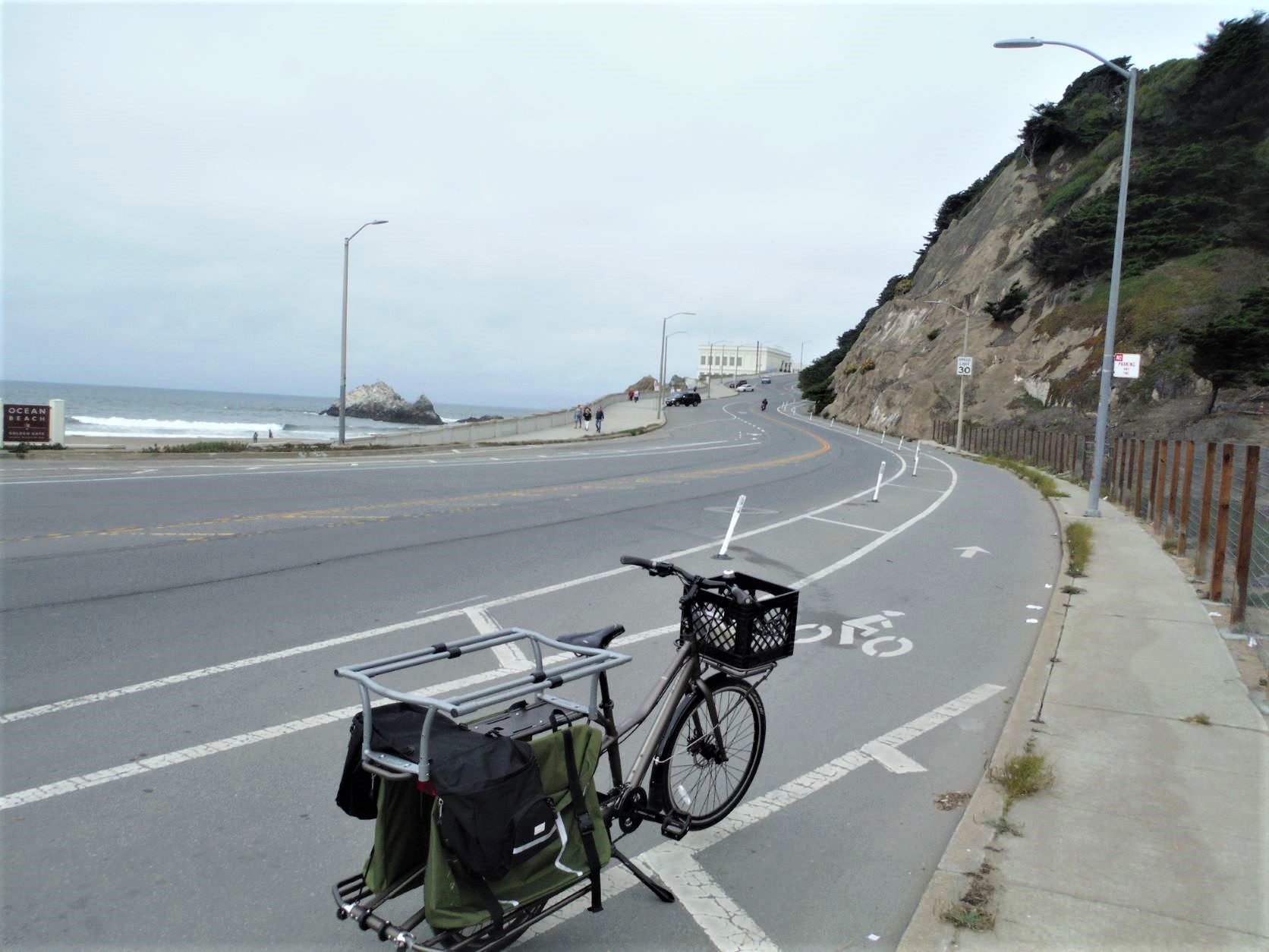

On Saturday I purchased a cargo bike South of the park but because of the Bluegrass Festival had to ride it to Ocean Beach, past Cliff House and up Sea Cliff to the GG Bridge. There were 40mph winds on the bridge, head on. I made it to Larkspur with 5 min. to spare to catch the train back to Petaluma. I will be converting it to a mid-drive. Mid-drives are better for hills and wind because the motor goes through the gears. @tomjasz is a highly respected and knowledgeable member. He is correct about crank forward. A Specialized Roll is also a super comfy bike with a 'lax geometry' and upright position without pressure on the hands. Here is one Roll that I made electric and here is an Electra that I made electric. I name bikes and call this Electra, Klunker. If you want to know who is saying these things you can look me up and read reviews on Google Maps. Search: Petaluma, 5-star, Bike, Conversion.

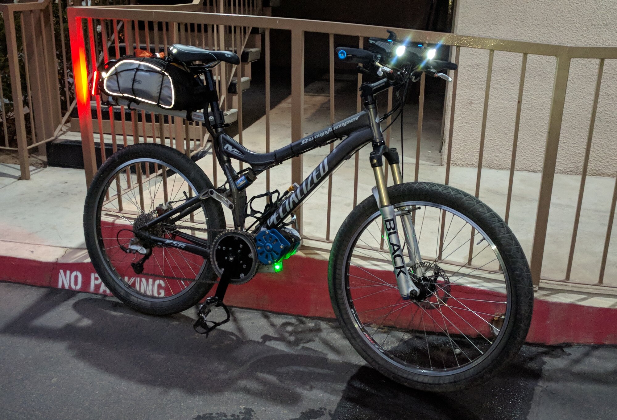

My second or third ebike was an old Stump I dusted off from the back of my garage.
I put a Cyclone on it, though. That was my first mid drive bike and I picked one of the least noob-friendly motors to use for the build, but it was a great learning experience. I made plenty of mistakes, not the least of which was using that rack for the battery, which never worked right.

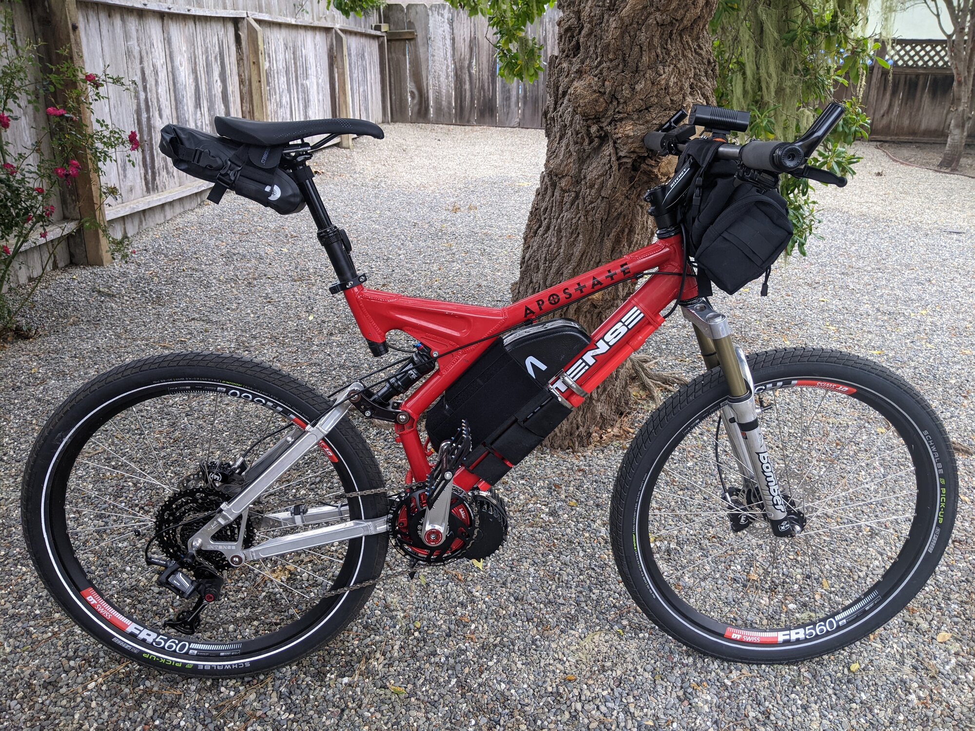

Looking at the triangle now, I see a perfect place to put a Wolf Pack style battery like I did on this bike that I built earlier this year:
About that big hub you want: Look around at the e-mtb's that are out there in the world. With the exception of the Steralth Bomber, its clones and light e-motorcycles, nobody uses a hub motor. The ones that do use a BIG one in the back with a gigantic battery that is 72v, 96v and lots of amp hours. They are not meant for pedaling and that huge motor really takes it out of being a bicycle. They are a kick in the ass but you throttle them and the pedals are vestigial. MTB ebikes use mid drives. And for your first build I strongly recommend a BBSHD like I used on the red bike. If you are a bit adventurous and have more money to spend, the Cyc X1 v3 that just came out is, I think, finally ready for prime time. I have a Cyc v1 on my Guerrilla Gravity Smash, and while its rewarding to ride the motor kit hasn't been a consumer-oriented product until now.

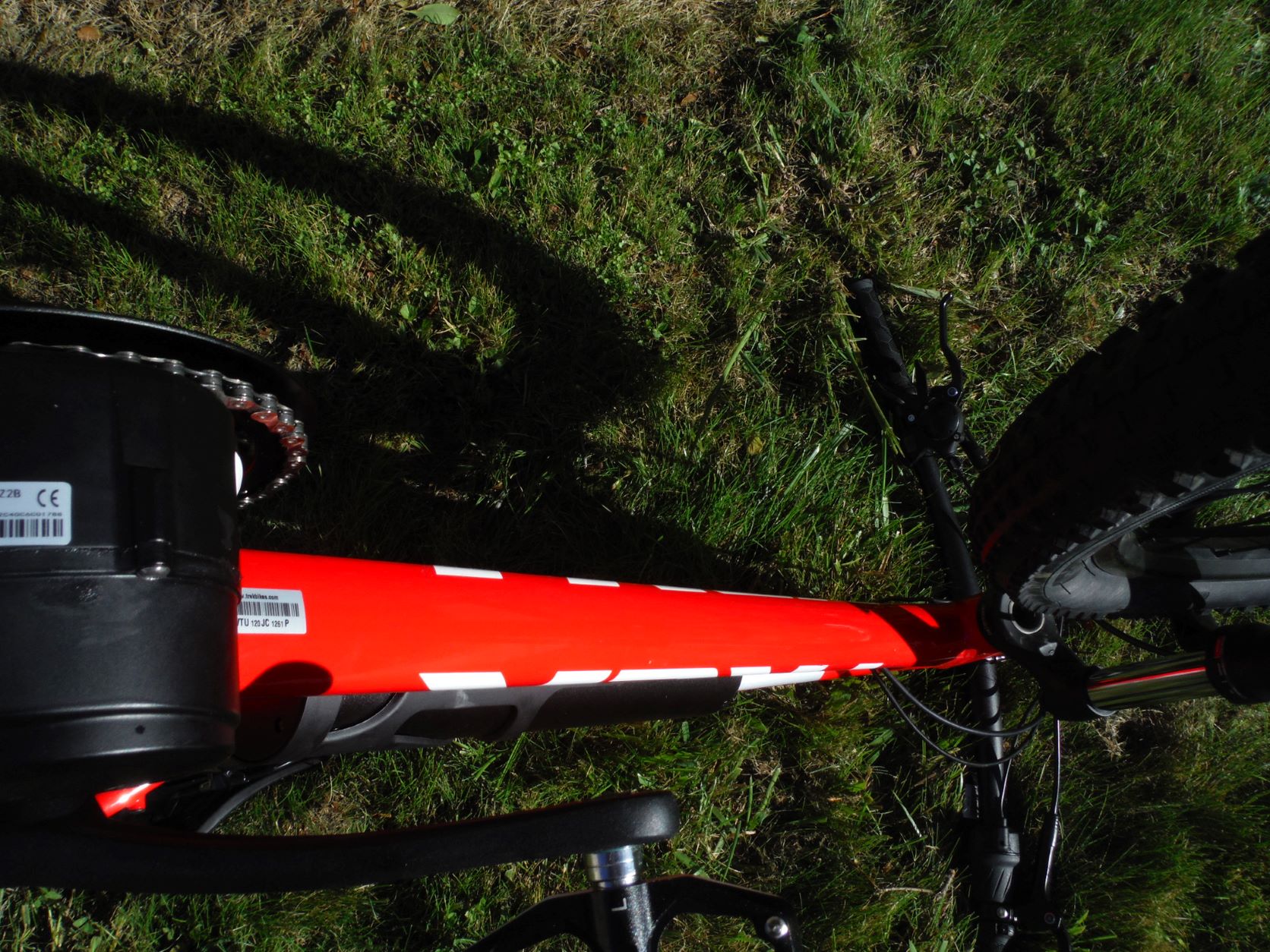

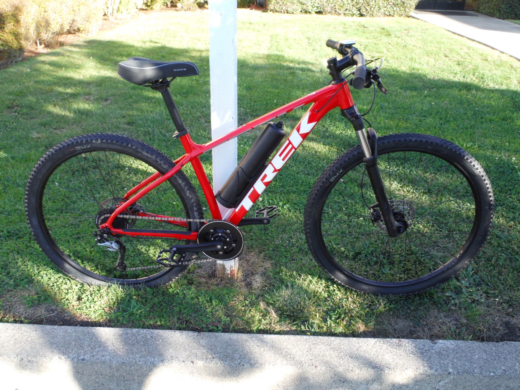

I recently did a duel clutch torque sensor 48Volt motor on a red mountain bike with 750Watts. Keeping weight low and centered is ideal. The rack pack does not work. Then bike will want to flip on corners. For most rides a 350W mid-drive is fine. Look for the wire management on the 48V, 750W, 10.5Amp/Hour red Trek. But the Trek mountain bike, MTB, does not have a lax geometry, geo, of the kind that @tomjasz recommends with the pedals forwards. @m@Robertson is also one of the very most respected members of EBR. Listen to these experts. These are the best and they know.

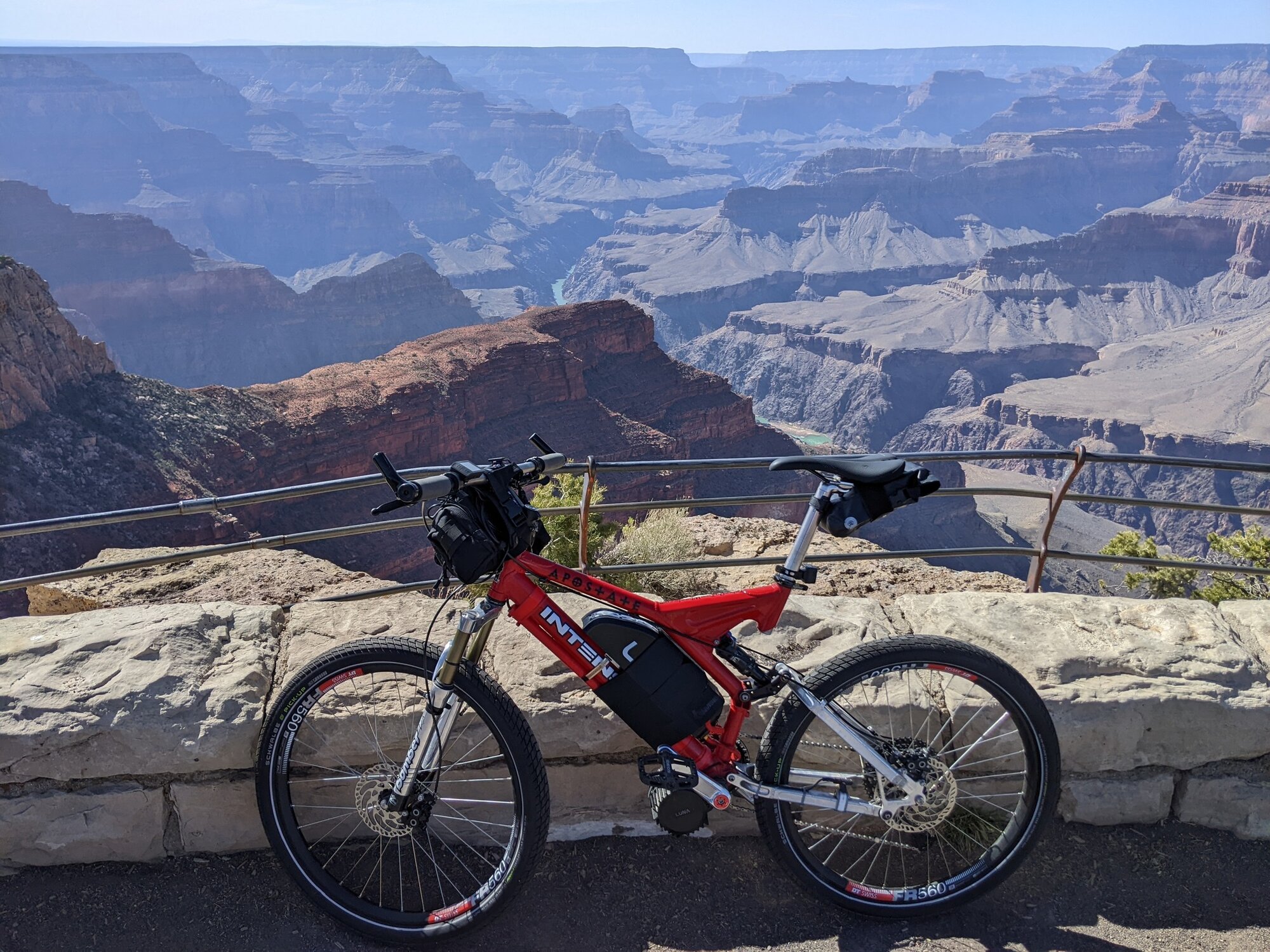

Which one? The Stump or the Tracer? I guess the answer is 'kind of' on both of them. Sadly, the Stump was murdered while it was undergoing shakedown cruises. T-boned by an inattentive motorist while commuting home about a month after build completion, so I never had any chance to evolve it.
The Intense Tracer on the other hand I have done quite a bit of fooling around with. In terms of an upright position, I NEVER use steering tube extensions as they introduce an obvious (to some at least) point of catastrophic failure. I also don't use adjustable stems for the same reason, and I've actually seen those fail during severe braking events. With that said, I'm no stranger to using an angled stem, which has no safety issues. I've used more than one Ritchey 30-degree stem and they are of good quality, and I now have one on that bike. Note the bar position is STILL not particularly upright thanks to the long extension I want for proper leg position on street pedaling. This bike also now wears some good smooth-rolling Maxxis Aggressor knobbies so its sure-footed in dirt, which the Pickups were not. Still silent and smooth on pavement, too.
The next move to bring position further upright is an uncut steering tube. If you are buying a fork, don't cut the steering tube. Use spacers to get the bars up higher along with that angled stem. Then, put a handlebar bag on to hide your sins. It is very effective, and you can dispense with the idea of wearing a paper bag over your head. Note I put the same bag on the Tracer as well as 2Fat below. Thanks to the photo angle you will have to surmise the uncut tube's protrusion above the top tube is there since you can't see it. On that bike it also has a 30-degree Ritchey stem but reach on that bike, given its long top tube, required something like a 60mm stem so not much elevation gained from that part.
the next step would be a riser handlebar, but I have never felt the need to go so far.
