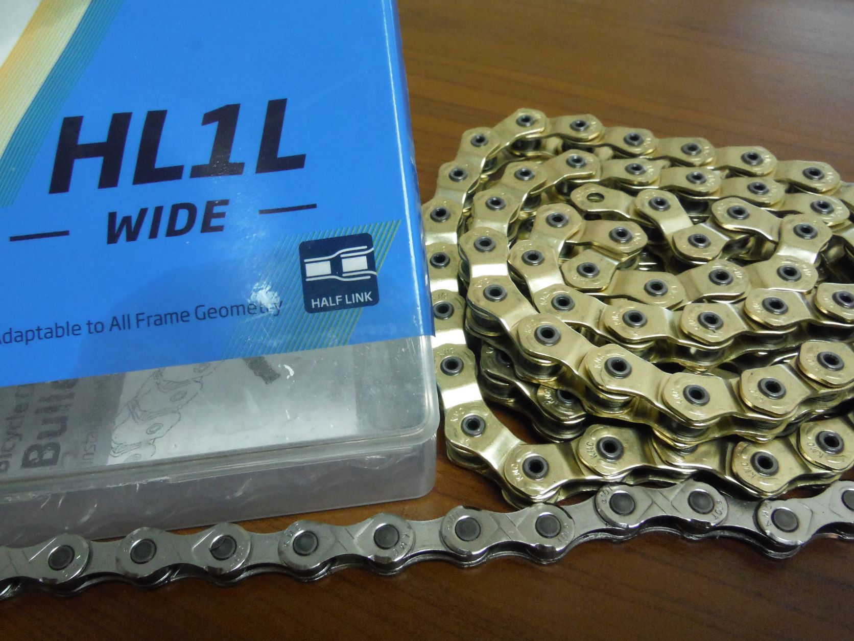

Yes, exactly @Calcoaster. If you already have the chain put a dot of paint on one link then count. The quick link adds one. I am using half-link chains on many of my IGH bikes. These chains are super strong and last as long as a belt. There is an initial stretch then they settle in for the long haul. The half-link allows for a precision adjustment of length.
