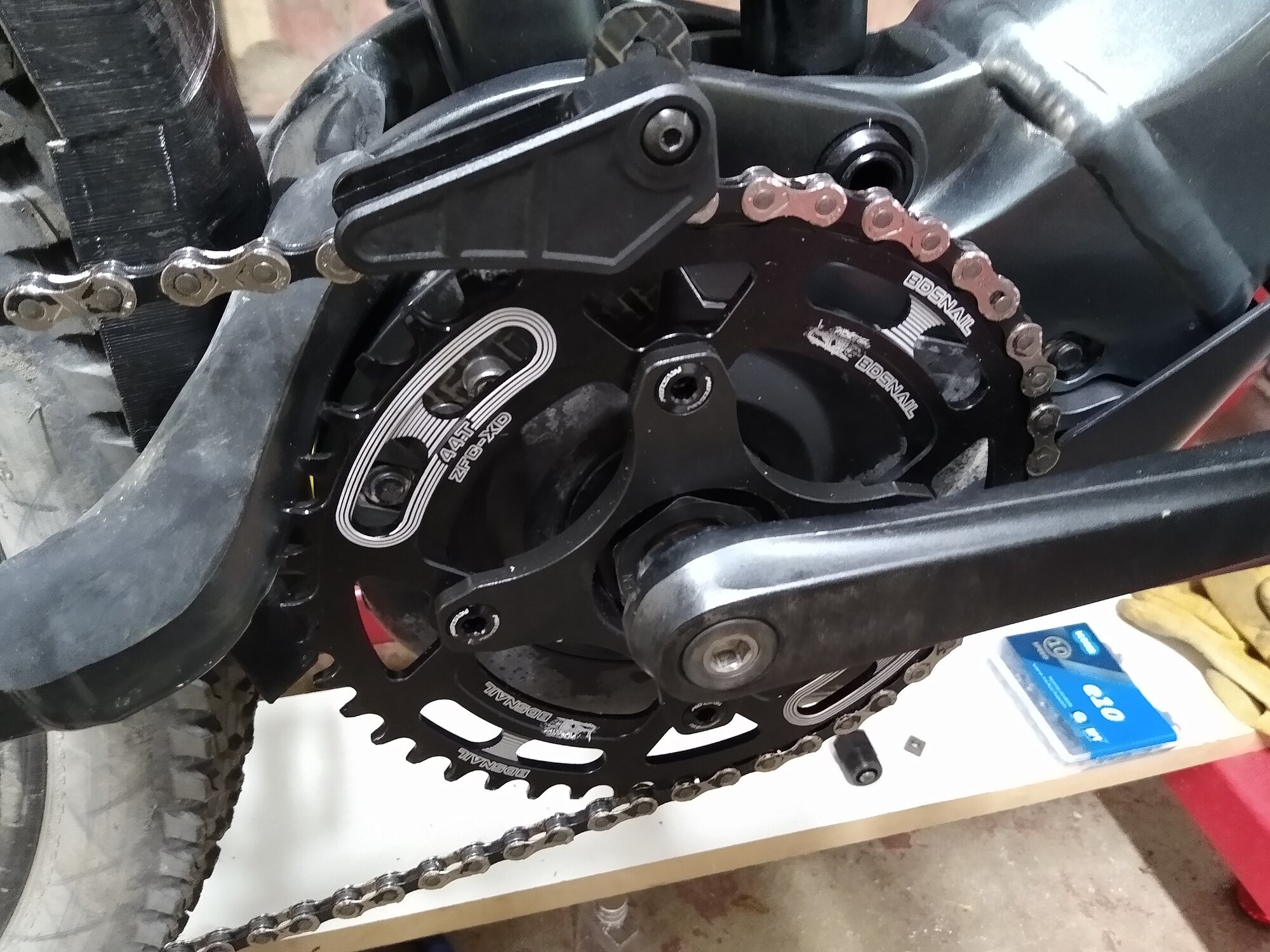

I have a 2021 Stance E+2 which has the Syncdrive sport motor. I would like to fit a larger chainring but I am struggling to find a ring or spider that fits the shaft. The Syncdrive sport has a 30mm diameter shaft whilst the PW series motors seems to have a 33 mm shaft. So the standard Yamaha/Giant spider such as the 1225-Praxis-902 won't fit. https://www.reveloutdoors.co.uk/Gia...OLT--1225-PRAXIS-902 /accessorydetail/3-46955
I suspect the two speed type - 122-9ap13-01v might fit https://www.ebike24.com/giant-e-bike-spider-chainring but I cant find anyone who will sell it or ship it to the UK.
Any ideas?
I managed to get the spider 122-9AP13-01V
This is two speed spider but the outer hole set are on the same q-factor as the original chain ring and then lets you fit any 104mm BCD chainring. For up to about a 42T chainring it will probably work without any further mods but I went for a 44T and this just grazed the chainstay so I needed a 1mm packer underneath the spider. The chainguide needed lengthening and I also put it on slightly longer standoffs but the standard 122 link chain fits fine.
