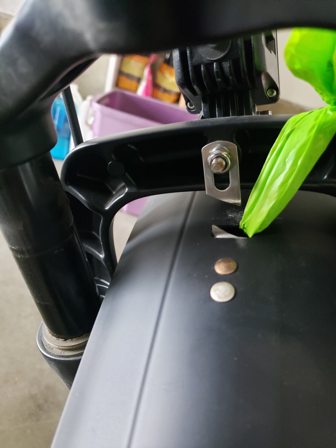

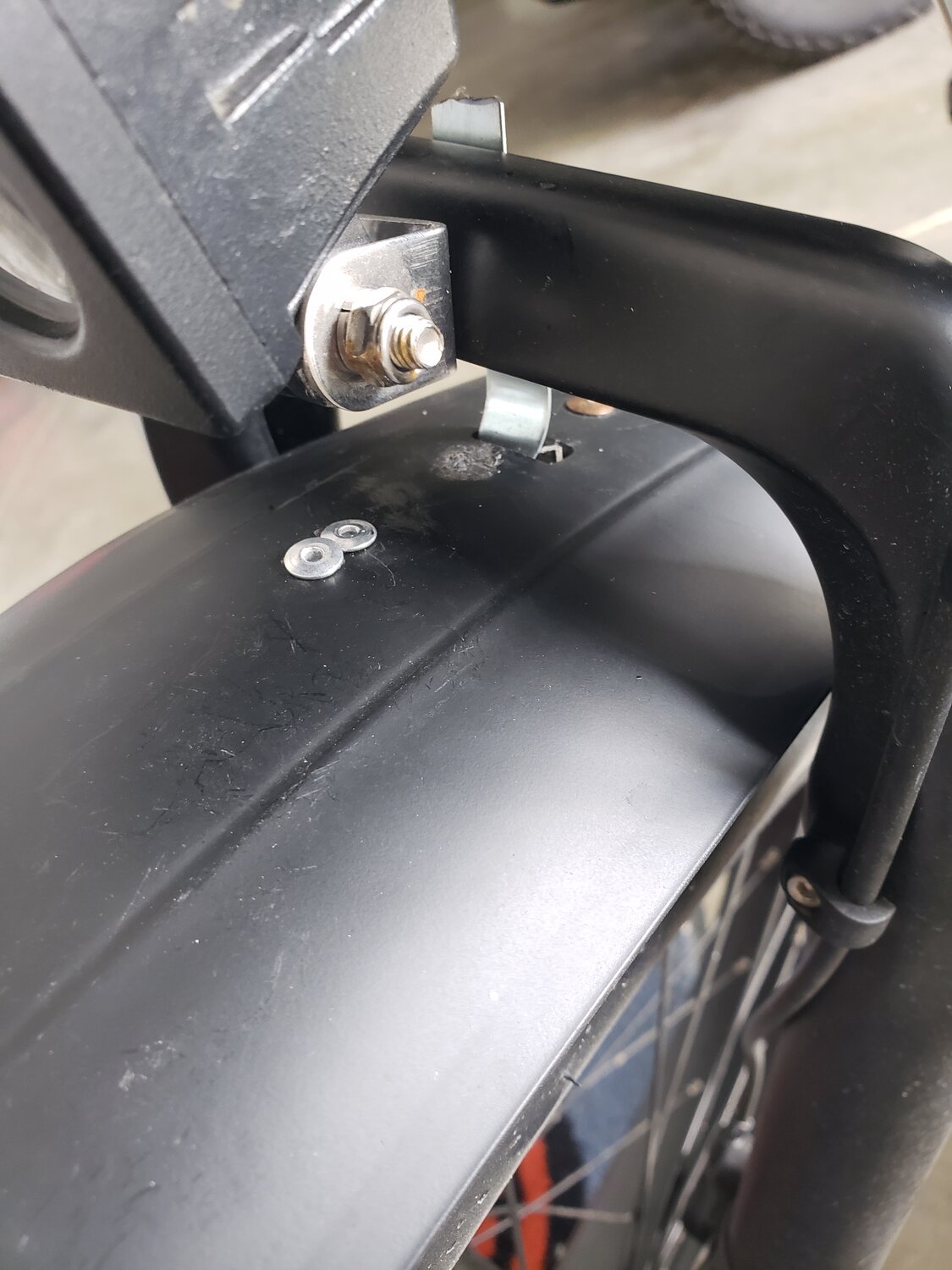

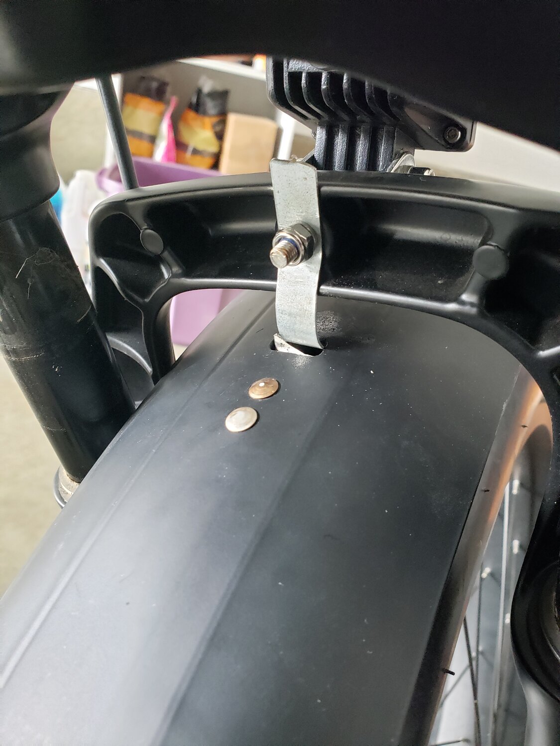

Sorry to bust in on a CCX question, but I also had a fender issue on my RCS. I think the vibration from airflow while carrying on my bike rack is what caused it. I could see the fender vibrating a lot at 60 mph. It was the fender mount that failed as you can see in picture #1. I used a dogie bag to tie the fender up for the ride we did. I contacted Juiced bikes and they said I would need a new fender as the bracket was not available by itself. They gave me $10 off the normal price. With shipping it was going to be $48. I looked around and on my workbench was a clip for one of my garage door remotes. It looked to be the same size metal. I bent it to shape and drilled holes in the fender. I installed it with 3 pop rivets. Works perfect... In the future I plan on putting something between the tire and fender and securing with a bungie...
