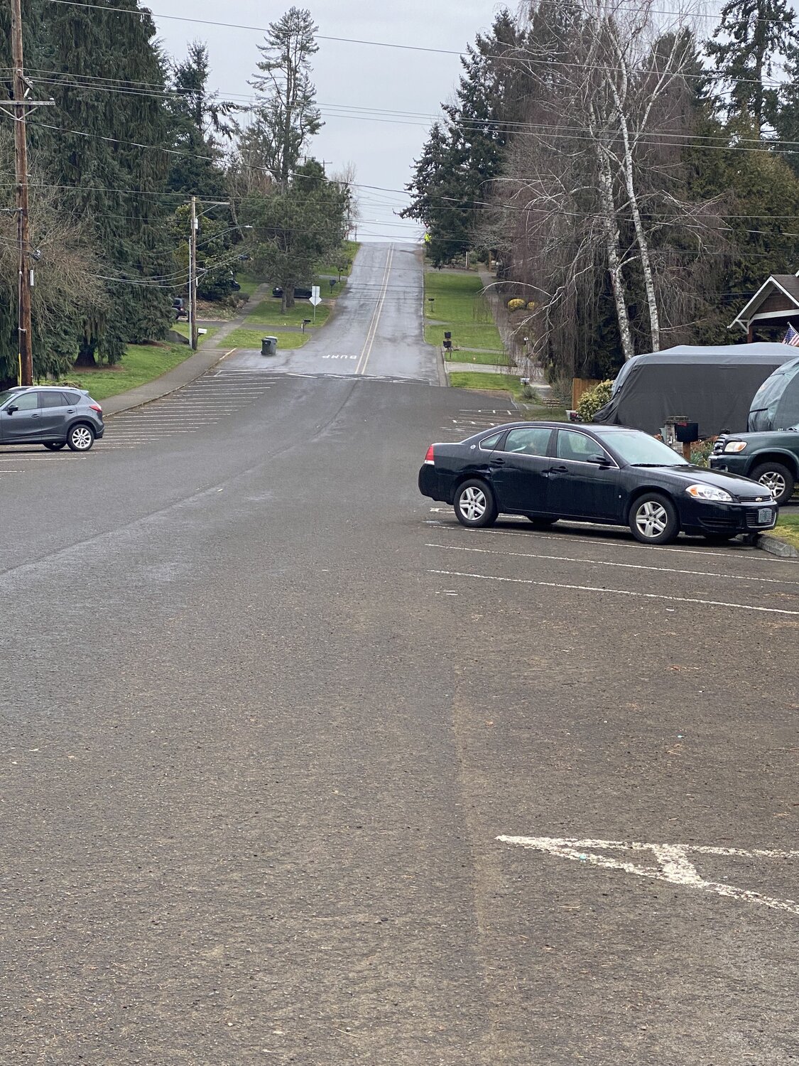

it would help yes but the spacing sucks so for most of my commute the gearing spacing sucks. on our bosch powered tandem we have the 11-32 and can climb all day. but I would like a lower gear to spin up hills more but this bike its not really needed. I have climbed these hills on my other bosch bike with only 63nm. I can climb 15% grades for a mile or more. it only takes about 250 to 300 watts. but with the larger cassette you can use maybe tour instead of sport or turbo.
That is a steep hill! What size chainring are you running with the 11-32 cassette?
