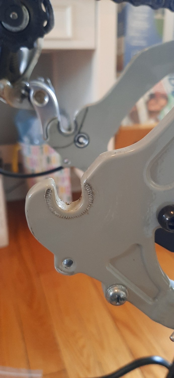

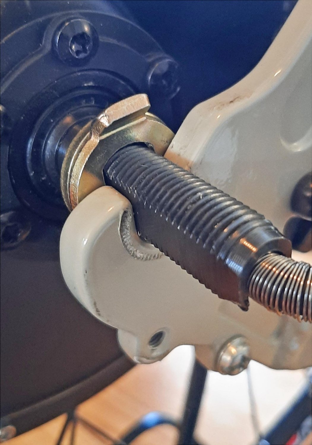

So i built a 3000w e bike (still upgrading certain things.) And when i initially get the axle into the dropouts its perfectly vertical. But then once i torque it, it moves a bit. And then stays there during and after riding. Is this okay as long as it isnt moving? (Torqued to 50ft lbs by reccomendation by the way) Thanks.

I see. I think that peice would help a lot actually. And yeah id like to add a picture but for some reason it will not let me. Thank you

Usually, the axle is pretty snug in the dropout. It might rock a little, but you shouldn't see any spacing between the axle's faces and the dropout, Certainly shouldn't see it turn much at all. I guess you could put a wrench on the faces of the axle as you tighten the buts to keep it vertical, but you shouldn't have to do that,

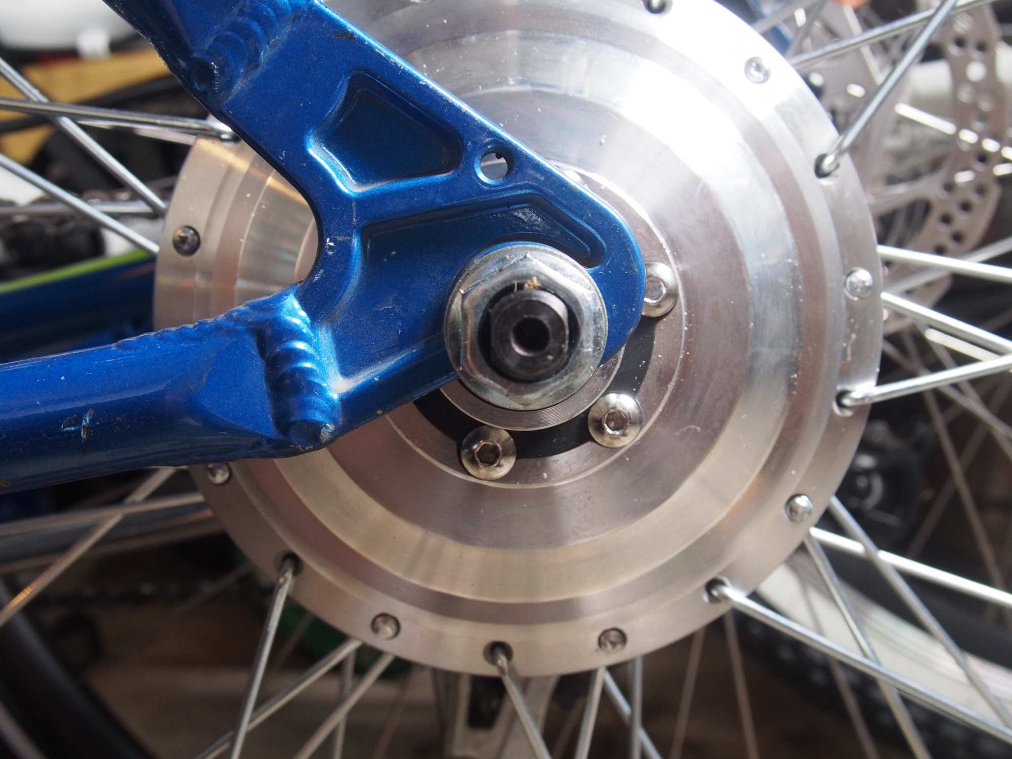

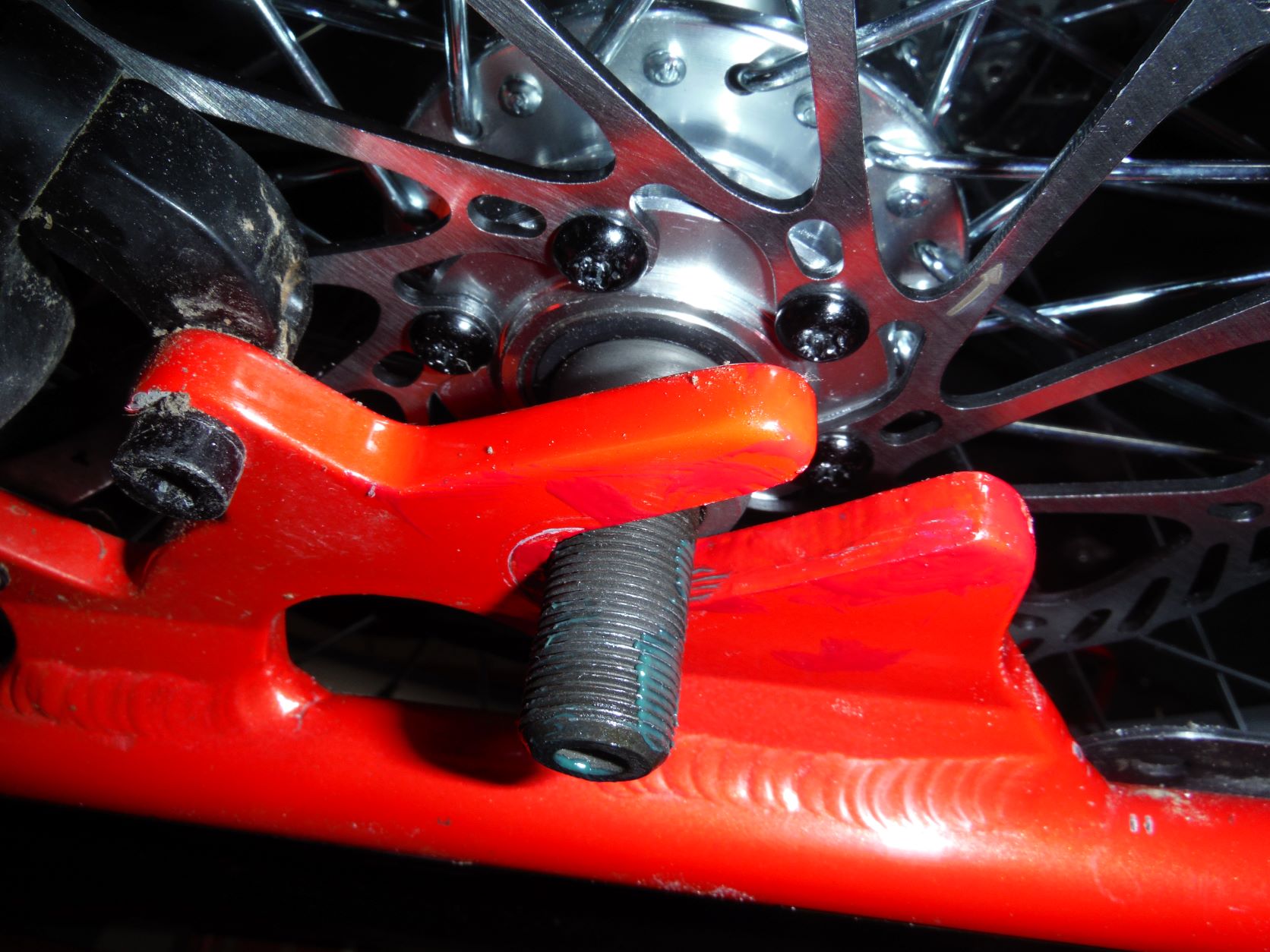

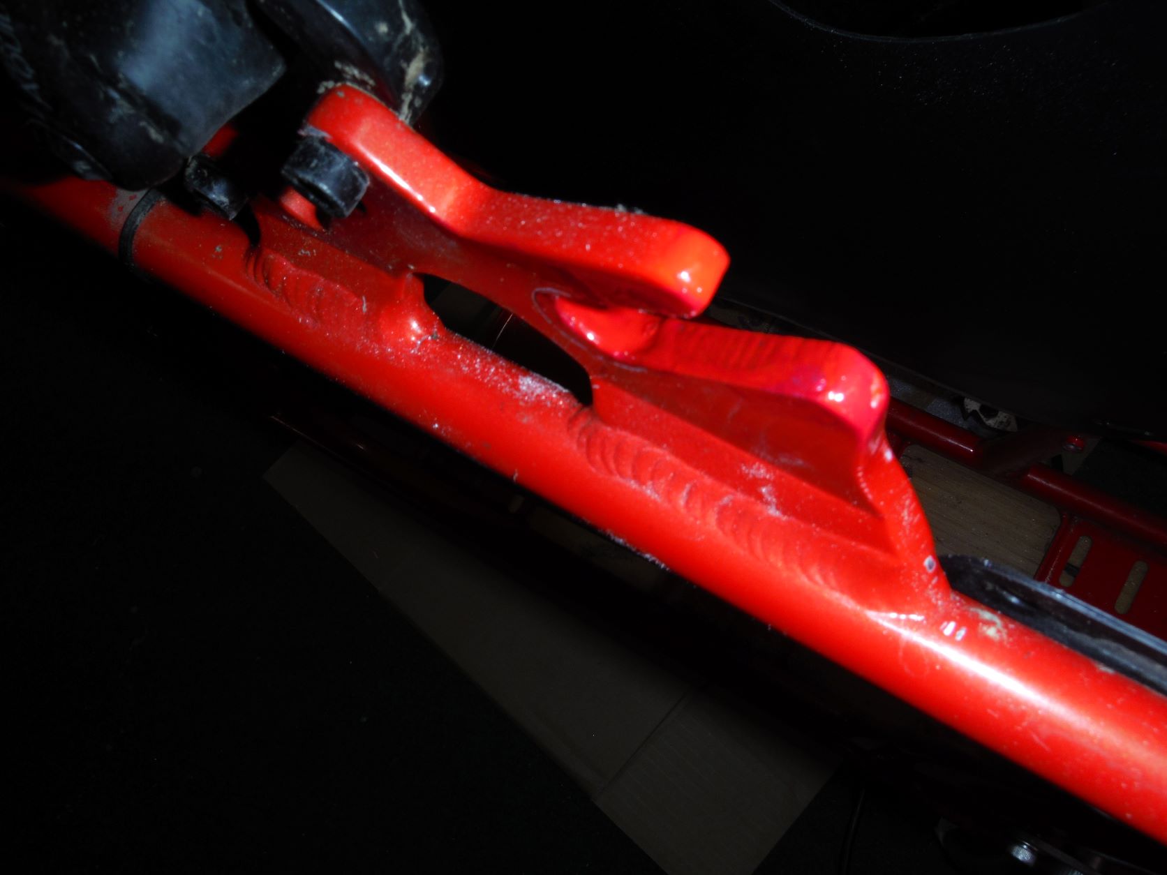

Here's an example of a not so good install. This ebike axle is 12x10 mm, and the normal bike dropout slot is cut for a 10mm axle, meaning the motor sits a little high. What a lot of people do is file the slot and the derailleur guide about 1 mm deeper, so the axle nuts will fit over the old marks. Otherwise, you lose too much of the gripping area of the flange on the nut.
This is a pretty good frame for a motor because it has a lot of metal for strength. When an alloy frame is files, the cut area has to be rounded like the original to prevent cracks at the corners.

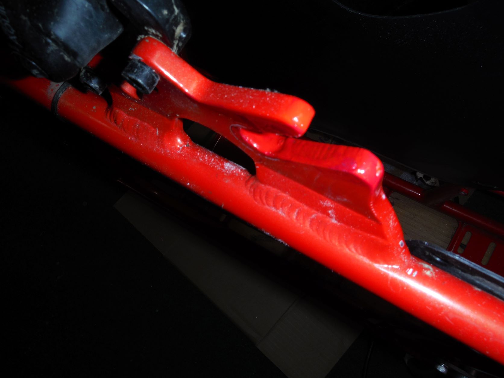

t
This by the way was my first ebike motor install ten years ago. I proudly posted it in a bike forum and some busybody like me said the alloy frame looked too weak. What do I know. Nothing. Well, I moved that motor in a steel frame and never had any problems. In hindsight, the blue frame was a bit fragile, and I eventually installed a mid motor on that bike,

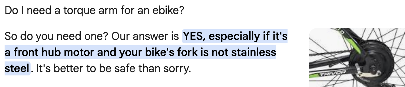

For use with other than low wattage hub motors the tab washers are basically useless for most installations due to the bikes dropout structure vs. the potential torque output of the motor, especially one over 1,000w. But there are plenty of aftermarket torque arms available that will connect the axle to the chainstay reliably.

If it is a 3 kilowatt motor it requires two torque arms. I have even seen 500W motors spin the dropouts and wreck frames.

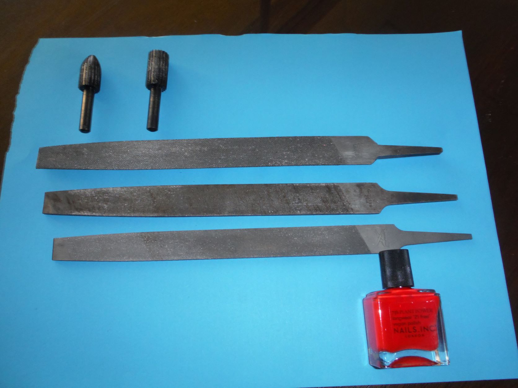

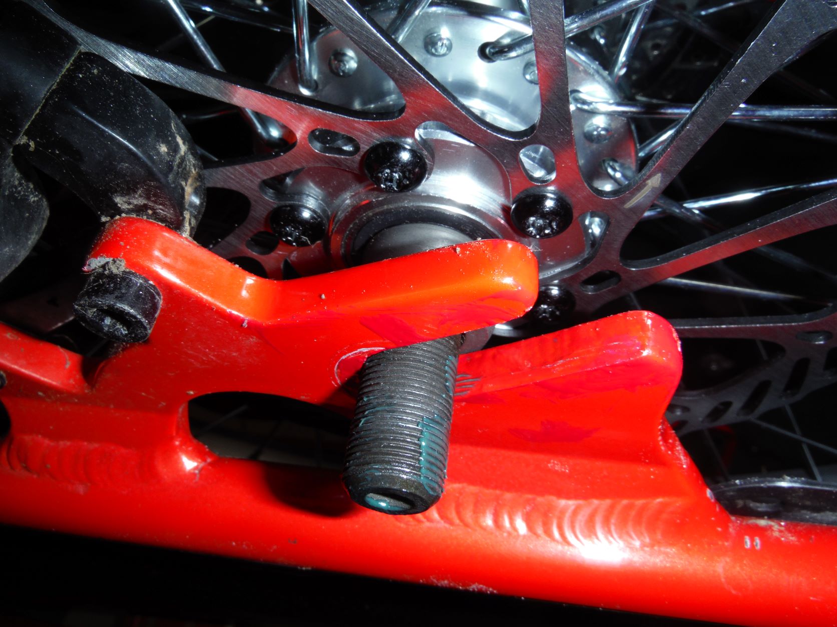

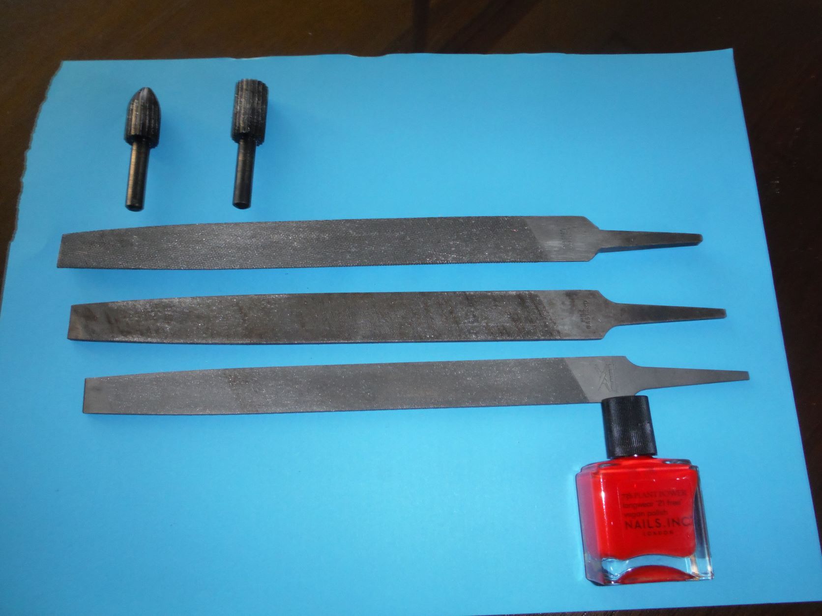

Last week on a green bike, not a red one, I used this technique to install a 13.2 mm axle into a 10mm dropout. Because I am a Swede my ancestors learned how to get large things in tight places or they would have died off in one generation. Here is also the toolkit to do it.

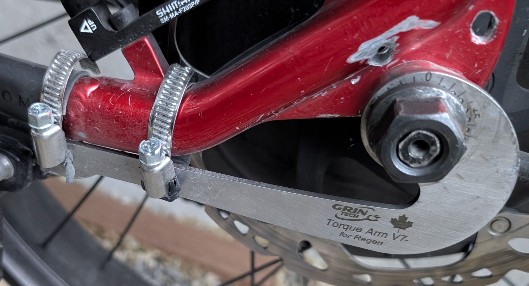

Those anti turn washers are NOT sufficient to hold a 3000w motor in the drop outs. You must use a good torque arm.
I have destroyed the drop outs and thus ripped the wires out of the motors (from them wrapping around the axle) on a couple occasions.
In order to hold that axle in place a torque arm is essential.
The best one i have found is by Grin Technologies, model is version 7
You can find it on Amazon for just over 100 bux canadian, and worth every penny
