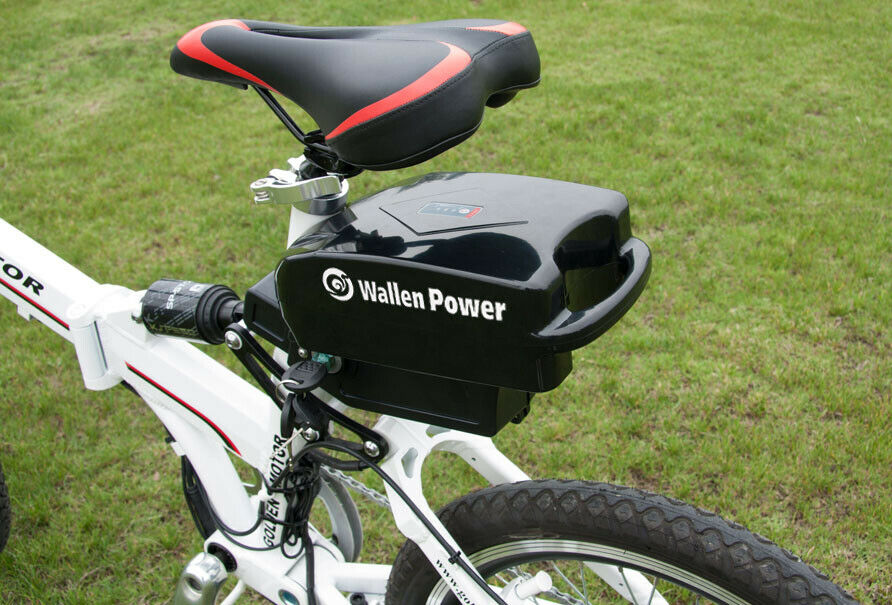

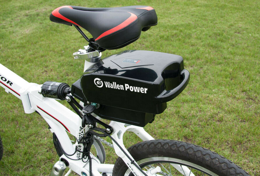

This might work for you .View attachment 41599

I would think a rear rack mount battery might make sense. You would need to buy a rear rack that works for disc brake bikes.
I bought one for the first electric bike. It connects to the seat post. The bikes seat post on the Redux is lower then the tire? Lots of stuff to check out when the bike gets here!
