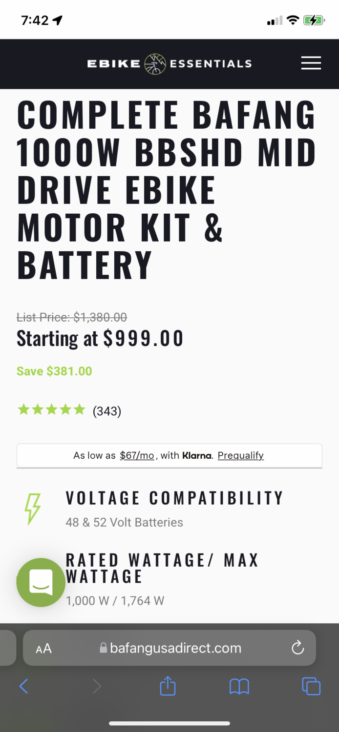

I can’t really see why I would not put a Bafang 1000 watt motor kit on a commuter bike and hide the battery in a back rack bag???
$1,500-$2,500 tops
Bafang’s 1000 watt kit is $1k and a used commuter bike is $250-1k. I’m assuming other people don’t go that route because they are not mechanically inclined???

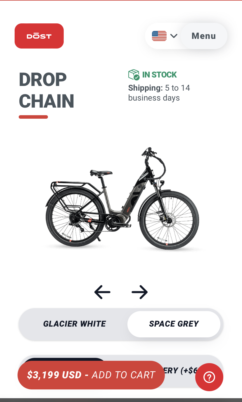

I’m currently looking at the $3k Dost Drop Chain. That’s the best I’ve found so far. They say they ship in a week or so! You can set it to a Class 3 mode so there is no speed limiting.
Downsides are….the Dost only has a 750 watt motor….it has a lever throttle instead of twist, and it looks like what a thief would steal. I’ve had 2 much less attractive bikes stolen already. That aside, it seems like it would be a good bike for me.

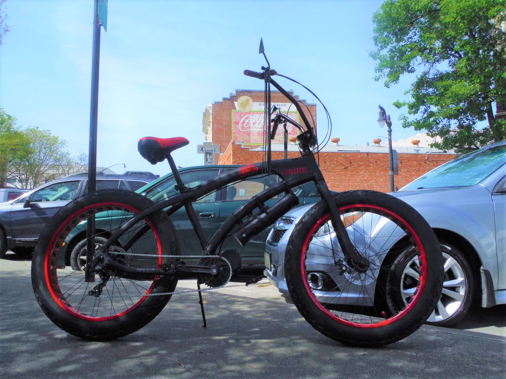

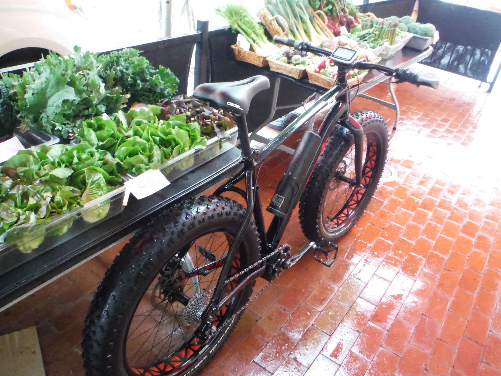

@bpmcallorum, You may not get everything that you want on your current list, but may still end up with something better than a bike made by using your current list. 750W is the maximum for a "bike" that is using a bike lane and does not require a license plate. 750 is a lot and ruining a drivetrain with more is not better for the drivetrain. Yes, you could run a 1,000W which is fine, until someone or something gets hurt. Then you are screwed. A BBS02 is about $450, freeing up resources for better quality components. Back rack bags are unstable making the bike want to flip on corners at speed. The weight is also out at one end so the momentum throws off steering an S. Stealthy batteries are available. The can be low and centered for handling. Twist throttles seem attractive until you are walking the bike, say through a doorway and you accidently twist, say to go over a threshold. Then the bike will shoot into the air and as you hold on it twists the throttle more. Unlike a motorcycle it is easy to forget that it is on because there is no audible que. Here are three bikes I have recently made electric. Two are at the legal limit for power. And yes, they are electric with active batteries in these photos. The fatties have throttles.

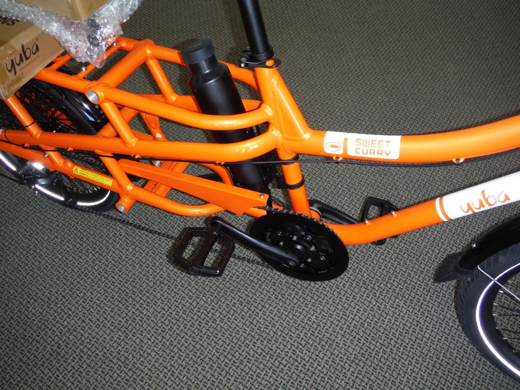

or if you don't need all that power, something like this might work out well for you. BBS02 has a rock solid reputation-
Radwagon 4
Not bad for 2 Grand. As long as you are flat landing you will be fine. These are very popular. Climbers require a mid-drive and can do so with less than half the nominal watts while out running more powerful hub-drives with heavy batteries. I have a taste for lighter systems. I am in the San Francisco area where we have seismically active hills. The orange one is a conversion of a Sweet Curry into a Spicy. Check the hygiene at the HB for messy connectors and look for sloppy wiring in the final photo.

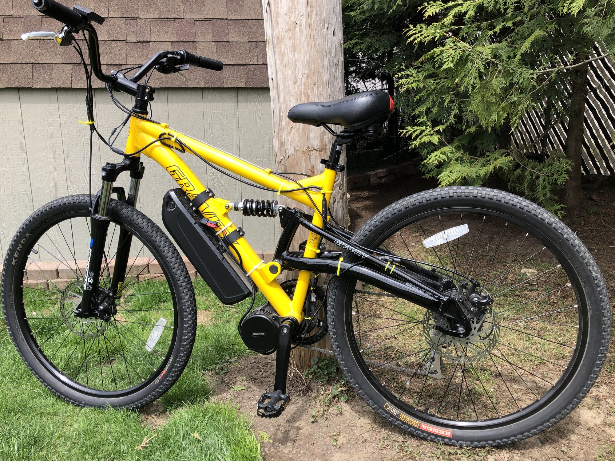

Building an ebike is not hard. I built this up one morning using a MTB that I had in the basement. It is a super comfortable, full suspension bike. I used the 750W BBS02 Bafang mid motor. It is fast, scary fast. I even put a throttle on it so I could pretend it was a mini bike/motor cycle. It's still scary fast.

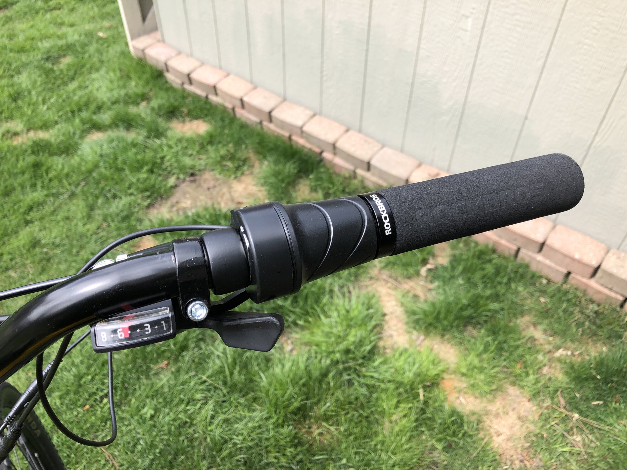

Could you build up an ebike with a motor that you really wouldn't have to pedal. Sure you could. Here is mine... notice the twist throttle!!!

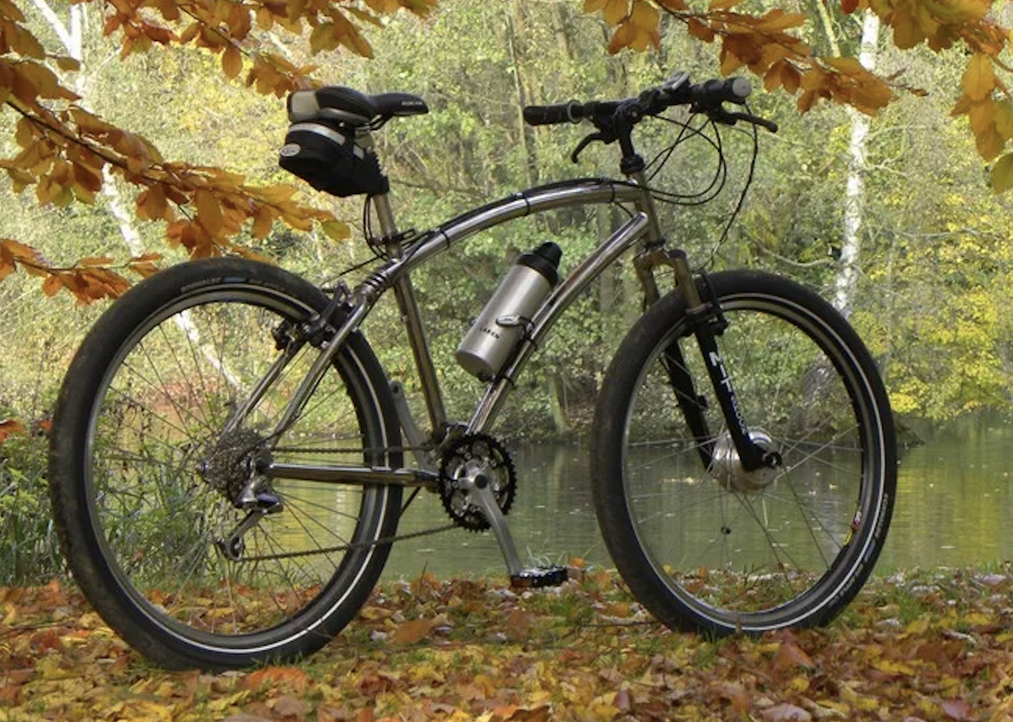

One of my future ebikes, which I don't have the hardware for yet, I want it to be a little bit stealthy looking. I know I'm not fooling anyone, but if I am only going for a 12 mile ride, instead of a 20 mile ride, I would use the stealth bike with the bottle battery, which I have not found yet.
This guy in Hamburg built a Fischer, which looks a lot like a Pomona. I have my Pomona at the powder coaters now, getting gloss black on it. I'll be sure to start a new thread when I get it back. Anyway, the Fischer looks like this:
I wouldn't do the front hub, I'd do a mid drive, 250W or 350W depending on what I can find.

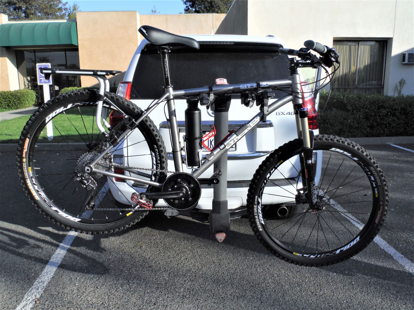

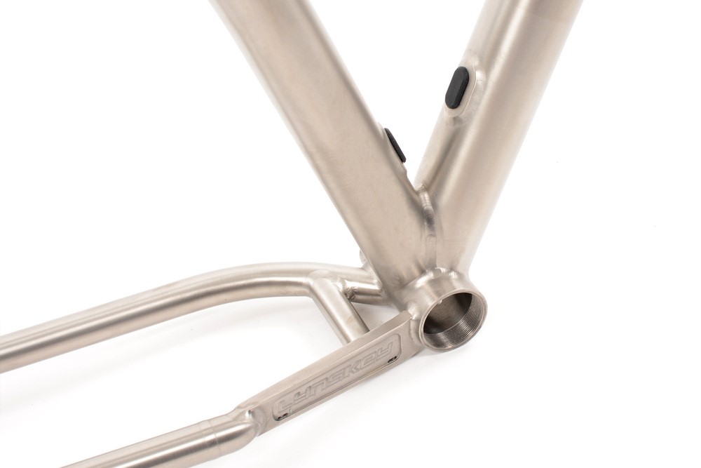

Here is a Ti with 85Nm.

That looks good. I've never tried TI. The rear rack looks like it was designed for a FS MTB, but your bike is a hardtail. That's heck of a powerful mid drive motor you have in there... I need to build up mine, so I have a baseline to compare it to. The kit that I have will probably go on my Giant Cypress DX. I'll have to start a thread for that soon too! Ha!
