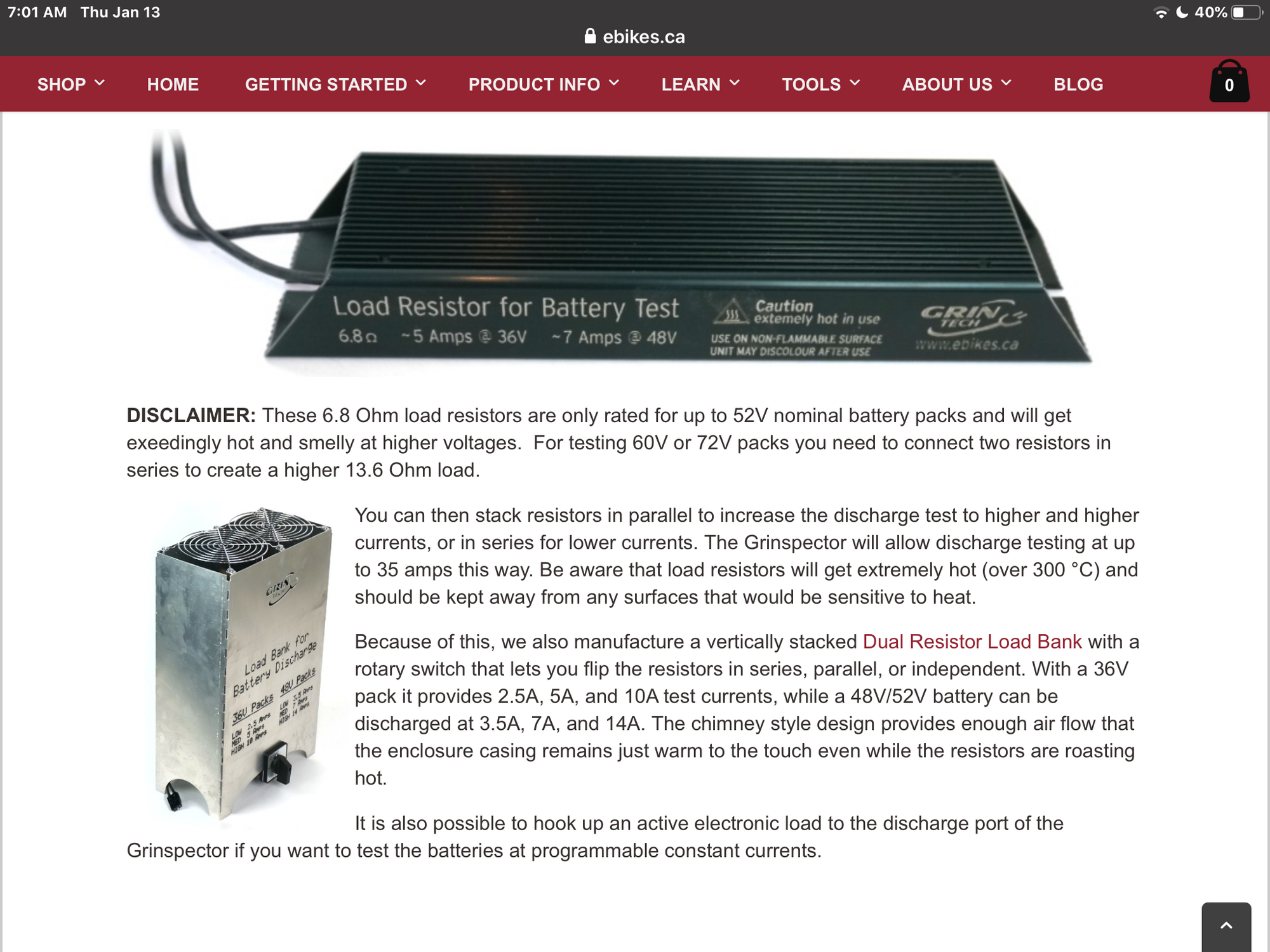

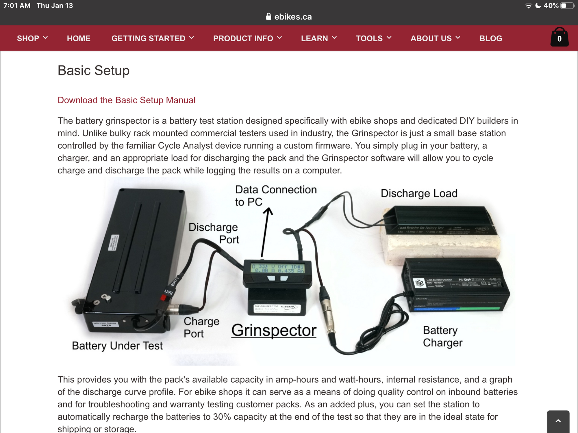

How disappointing. But kudos for revealing the follies of low ball pricing and subsequent quality. Even though anonymous I find many buyers won’t post their failed experiences. Often out of embarrassment for not using best advice and practices. Thank you!
I have one more of three batteries floating somewhere in the Pacific Ocean. One from Jenny, shrink wrapped. A custom built to my specifications from my battery arch nemesis UPP. I’ve been extremely critical of them after high failure rates seen with the reseller I formerly worked customer service for. BUT the custom pack I had made in 2015 has been great. I beat the crap out of it. Broke most good practice rules but still got good performance. It outlasted a more expensive Luna. (I have a photo showing both used same build technique and mediocre BMS. In fairness that’s old history.)
I’ll run them through a round of tesing with my Grinspector before I close up my little battery shop and sell the tools and Grinspector. (Offers accepted. All in as new condition) Last hurrah and back to all EM3ev next replacements or adds.
