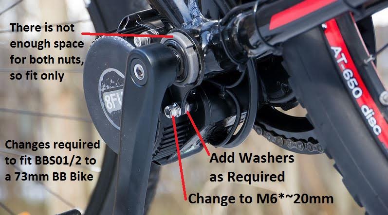

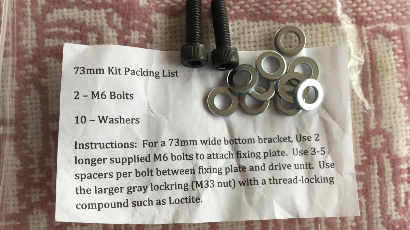

Yes, I fit a 68-73 BBS01 motor first to a bike with a 68mm wide bottom bracket and I didn’t need any extra hardware. Then I swapped the motor to another bike with a 73mm wide bottom bracket and I needed to buy some 5mm longer M6 screws than the ones you got with the kit which are probably for 68mm, and some M6 washers so you can attach the fixing plate to the wider bottom bracket. Also with a 73mm you will likely have to omit the second M33 locking nut as you won’t have enough screw thread, it’s fine provided you tighten the main M33 locking nut, although you might also want to fit a BSB-1 torque arm https://california-ebike.com/shop/bsb-1-bafang-stabilizer-bar-bbs0102-bbshd/

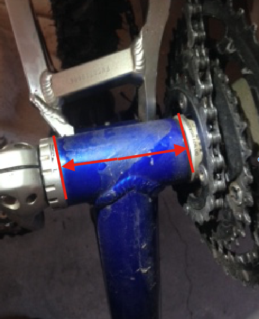

The listed numbers being the length of the bracket marked in red on the 3rd picture?
I guess what I'm wondering is what do the dimensions of the cartridge that fits into a bottom bracket refer to? In my original post the cartridge dimensions are listed at 68mmx113mm, I'm assuming the 68mm in that dimension matches up with the BBS02 spec, but what is that 113mm?
Edit: I think I was able to find it https://bikeraceinfo.com/images-all/tech-images/bottom-bracket/campy-bb.jpg it does indeed refer to the overall axle length.
Yes, that’s where you measure to determine which motors are an option. Axle length has no bearing.
68mm BBS02 or BBSHD 68mm and you’re good to go.
