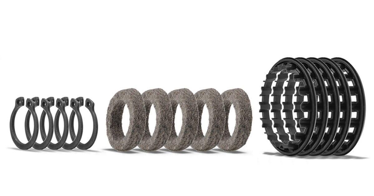

Crankshaft clutch/freewheel is not engaging. Driveunit will need an overhaul.
good question, I am not overhauling drive units myself so that would be a good question for a repair center.
