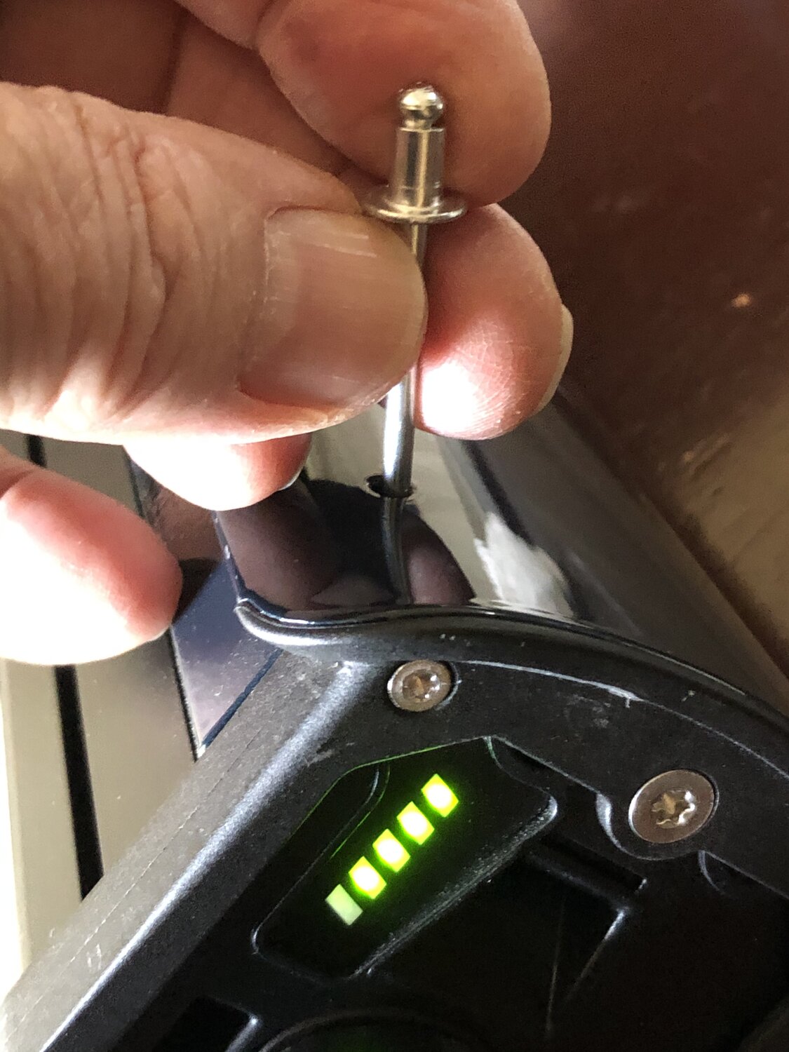

There is no button on the power tube battery that I can find, unless you mean the one that is under the handle... I tried that
here is the location it is the button that you use to check the battery level

There is no power button on my 500, at least it’s not easily accessible via the Trek battery cover. You have to stick a thin object (I use a rivet) through an access hole to press the hidden button.
