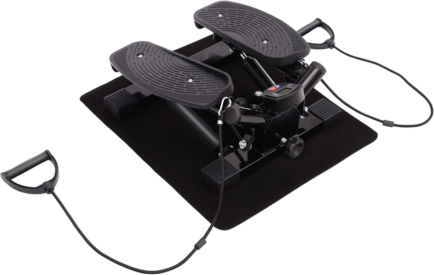

First of all I used to be 22 stone, I am now 13st 6lb.
1. Exercise, you will not get a bike top carry you at that weight.
2. Cutting down on food does NOT work, you need to change the way you eat.
3. I started with the stepper at 100 steps and eventually did 10,000 a day
4. It is the SPOKES that matter on the wheels of the bike that take the weight.
IF YOU ARE UK THEN ANYTHING OVER 250W IS ILLEGAL.
The stepper is an interesting gizmo. I am in the USA, while some states have a "watt limit" (750 in Maryland) it is totally bogus and not enforceable in any way. There is no stated load of work, is it continuous operation, is it peak, is it nominal? There is no way to measure this mythical number on the bike trail. What load is it under? How many amps is the controller?

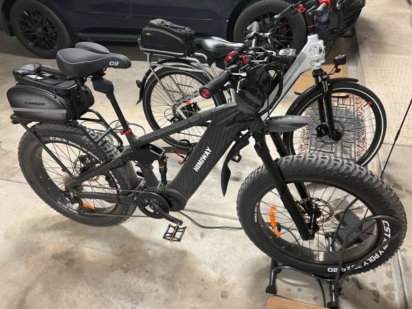

I'm 6'3", size 14 shoe, +325lbs (+350lbs with rack bag , commuter backpack, gear/tools, water/lunch, etc...), and very long arm (6'10" wing span). I just upgraded my 2016 Radrover 4" fat tire 750w rear hub to a 4.8" Himiway Cobra Pro 1000w mid-drive full suspension 20 Ah battery 10 speed tq sensor with throttle. The Himiway fat tire ebikes are rated to 400lbs and 2X the tq of a rear hub ebike. I live in NM and the extra tq mean serious hill climbing abilities and I'm using a lower PAS at level 1-2 (and less battery power) compared to my 750w Radrover at PAS 2-4 for normal riding.
I also had to upgrade to fit me correctly:
- saddle to Cloud-9 cruiser 11"X10" seat
- Sunlite 0-60 Degree adjustable bike stem (raise the handlebars to helped with numb hands)
- large and wider MTB platform bike pedals
- a longer 420mm Kinekt suspension seatpost (the standard 350mm was causing left knee pain)
- stiff bottom Northwave MTB riding shoes for waaay easier pedalling because my Nike running shoes were too flimsy and flexed too much. MTB shoes will almost last forever since you only wear them on the ebike.

I have a pump for the center suspension and forks I keep in the rack bag. I set the center shock to around 275 psi and around 100 psi for the front forks. I also have the suspension seatpost and Cloud-9 cruise seat with springs along with the 4.8" fat tires set to around 30 psi. Very comfy, stable, not a lot of road noise from the tires on paved surfaces. I'm not maxing out the suspension with technical downhill runs, jumps, steep hill climbs, or black diamond trails.
You can adjust the motor cut off to 20 mph if there are restrictions in your area. I did a paved road speed run and had it up to 31-32 mph on the odo at top motor cut off. Extremely comfy ride on paved roads or doing single track near the Rio Grande river in NM (throttle comes in handy when pedalling would strike the ground/stumps/vegetation). The Cobra Pro is a heavy ebike at +90lbs out the box and probably +100lbs with all my accessories (rack+bag, suspension seatpost, Cloud-9, aux light+battery). The 160 Nm of tq moves the Cobra Pro way easier compared to my 80lbs Radrover with 80 Nm of tq.
