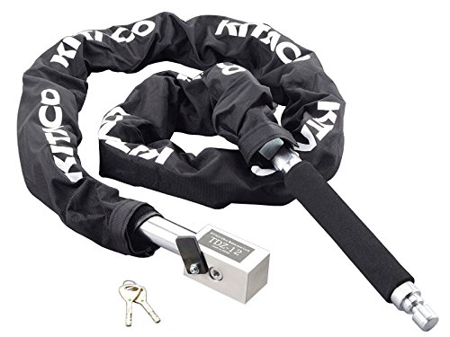

The best bike lock as far as I know, is Kitaco TDZ-12
It's on sale here: https://japan.webike.net/products/23236823.html
Official Website: http://www.kitaco.co.jp/goods_detail_en.html#sid=P880-0818120
Kitaco TDZ-12 specs:
Length: 2350mm (7.7 feet)
Width: 32mm (1.26 inch)
Weight: 22.6 kg (49.82 lbs)
Impossible to cut it with bolt cutter
Kitaco claims the TDZ-12 can't be cut even with a 70 metric ton (approx 158,000 lbs) industrial hydraulic cutter
Angle Grinder Resistant
1 minute of angle grinding will scratch approx. 1mm in depth, in theory it will take approx. 32 minutes to completely cut the lock
$1,063 and 50 lbs... no thanks. ;)
