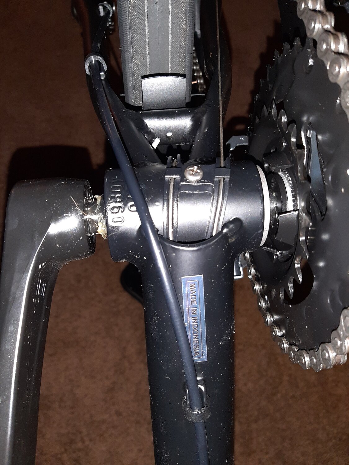

Well I am scrapping the IGH idea and just going with the cassette I already have. I am wondering about the BB clearance with this shell with a protruding lip that allows room for the cables. Will this be a problem for a BBSO2 or Hd?

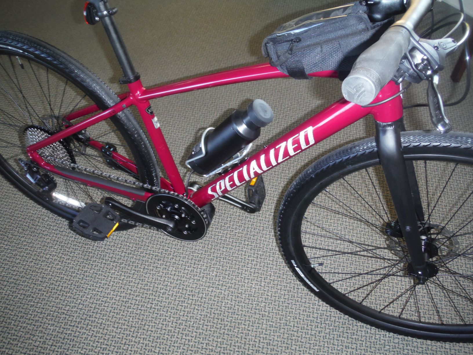

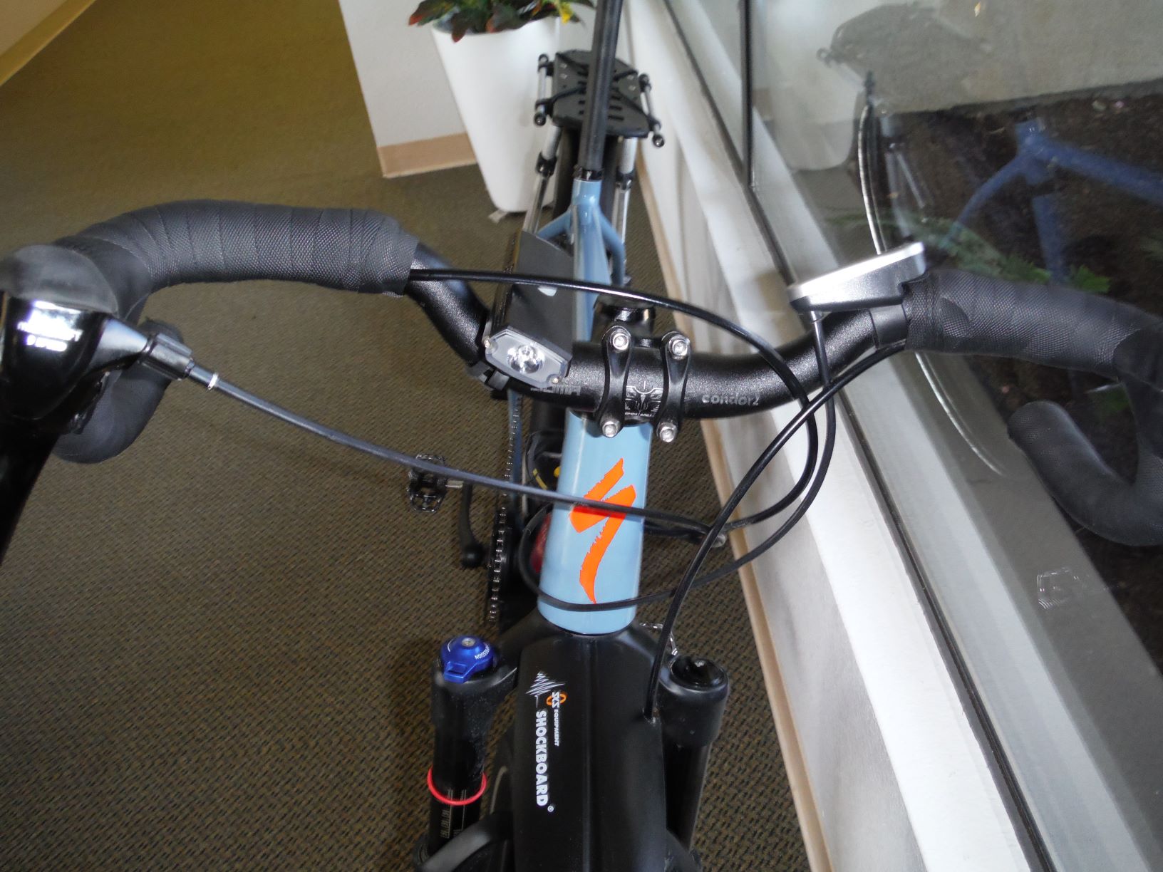

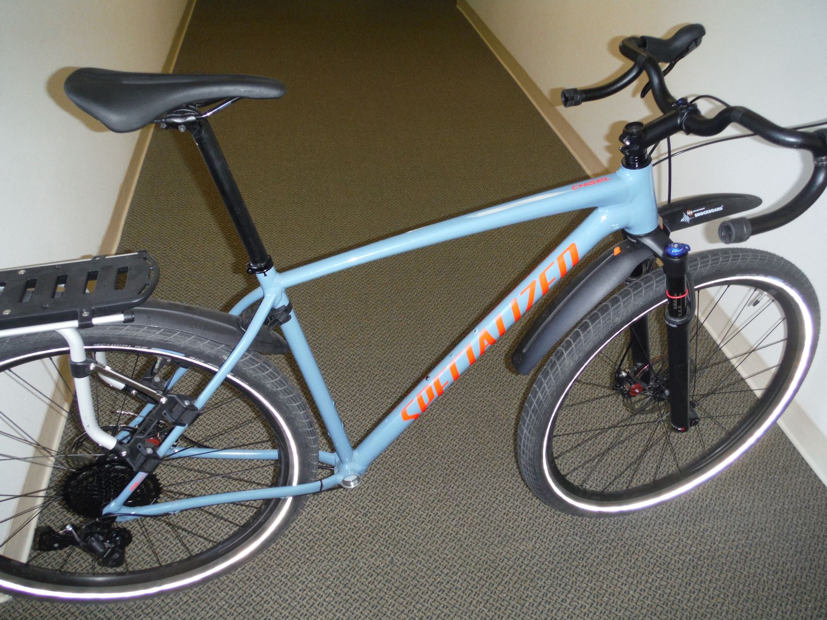

It can be done but it is not a typical DYI level job. I have done it on two bikes, both Specialized with the same down tube configuration with internal cables and a hydraulic hose. You could easily mess up your bike. It will take hours of careful work. It is worth it for the willing. Here are those two conversions.
