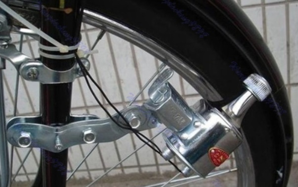

The old fashioned bike dyamos already have the frame mount. As kids, we snapped them against the wheel and the tire sidewalls would spin them. Credit Ralf Roletshek for the picture. I remember they did drag.
You may want something bigger to put 2 amp hours into a battery.

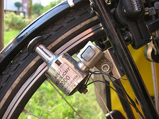

,.. Credit Ralf Roletshek for the picture.
I stole my pictures off ebay,.. 😂
My generator had the splinned metal wheel on the armature.
Your picture shows a thinner rubber coated wheel against the tire.
I have never seen that before.
Looks like the Rolls-Royce version?
It probably works more efficiently?, but it's a bigger wheel so you'd have to pedal faster or your light would go dim.

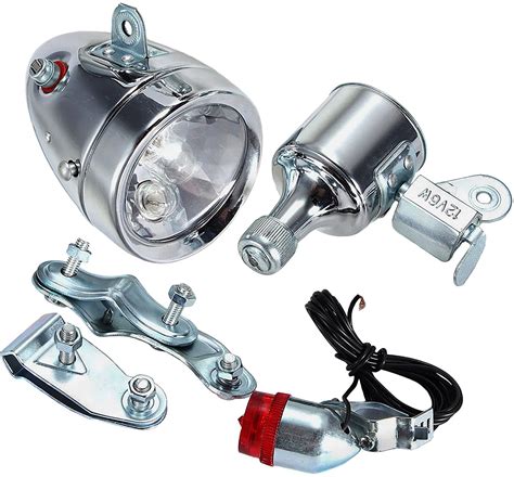

,..Do you know the extra effrtto pedal a bike with one light generating dynamo. Put three in series.
That Dynamo is rated 12V 6W, so three in series would be 36V 18W at ½ an amp to charge the battery.
You'd need Really soft sticky tires to grab the road without skidding, if you ever wanted to charge at 3 amps.
