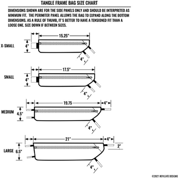

I used a triangle bag from EM3EV and it had internal straps. I hung the battery from the top of the bag with the included foam padding between the top tub, triangle bag cloth, and battery. Secure and free floating essentially. There are some smaller top tube bags that would accomplish the same thing. Revelate makes superior bike packs.
