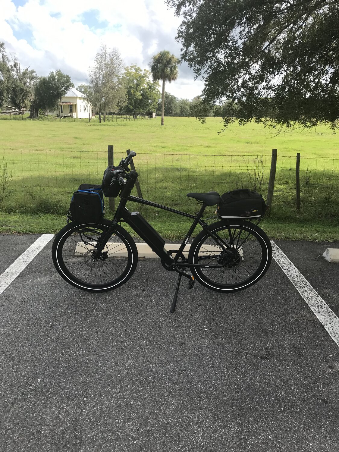

Hi- I couldn't get my battery off my pace 500. Took it to my Ebike guy (love pacific e-bikes) who had to rubber mallet it off and showed me how the battery terminals had fused to connectors on the bike. This seemed to screw up the battery. Now I worry that my second batter will undergo the same. Have 1300 miles over a year and a half. Does anybody have the same problem? Thanks
