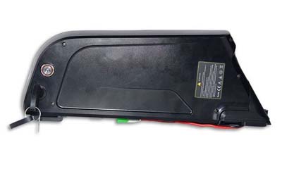

Hi, just got Ecotric 26 Fat Tire ebike on Friday. Not happy with battery life (21 miles on peddle assist mode, not throttle) but love the bike itself, for the price. Has anyone found a higher amp hour alternative battery? It's 36v 13an stock battery. Any suggestions on aftermarket battery supplier that would be cheaper than purchasing another battery from Ecotric? Thanks for any suggestions. Greg
In the facebook Ecotric user groups, owners are talking about running changes in the battery styles on some of the fatbikes. so you might want to show exactly which style battery you have. Is it the older dolphin like this?

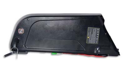

Thanks, I'll check out Users group on Facebook. Mine is newer battery, does NOT have the button above key like one in your picture. I'll take pic and upload.
